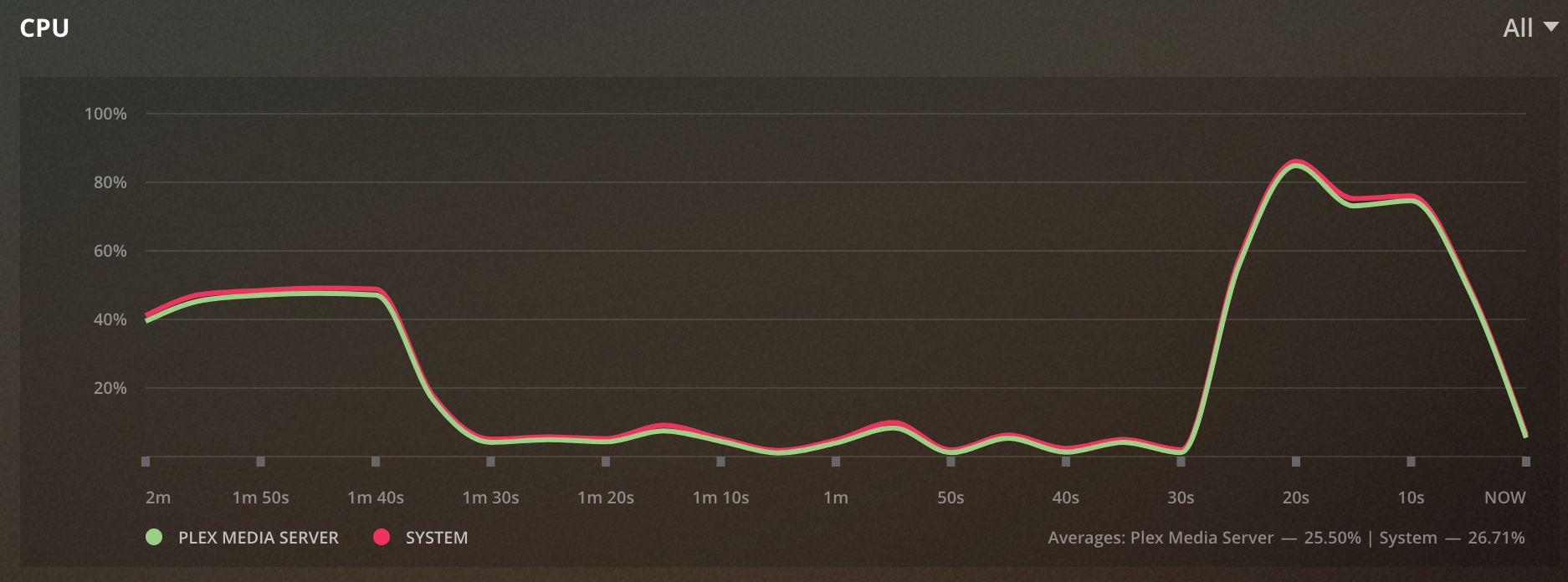

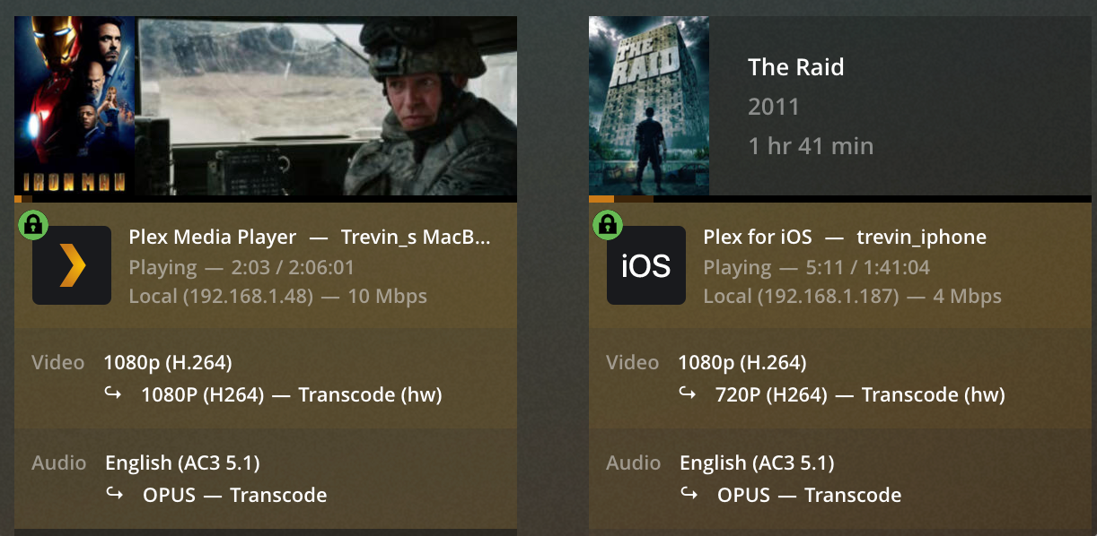

Installed an Nvidia P2000 tonight into my box and got this seemingly working after adding the --runtime=nvidia and gpu ID.  I played a video through Plex app on my iphone and forced it to transcode by selecting a lower res (720p vs 1080p original movie).  In the plex dashboard, I confirmed "(hw)" appears next to the transcode line, and running watch nvidia-smi on the unraid command line showed the plex transcoder process!
One question I did have was that I had a pretty large spike in CPU utilization, presumably because of audio decoding.  My CPU is a Xeon E3-1246 v3 3.5Ghz.
In this screenshot, you'll see the first 40% spike when it was playing one 1080p movie (hw transcoding video to 720p) and audio was transcoding. The second spike to approx 80% was when I played a second 1080p movie on another device (again, hw transcoding video to 720p) and audio was also transcoding.  After about 30s of each, the CPU utilization dropped back down to what appears to be ~5-10%.
image.thumb.png.f15a11db476a903d5e3f9972a76e7538.pngimageproxy.php?img=&key=00b562fcac28e727imageproxy.php?img=&key=00b562fcac28e727imageproxy.php?img=&key=00b562fcac28e727
This was what the dashboard was showing while I was playing both movies:
  • Is this CPU utilization spike expected? Is this because of the audio transcoding?
  • If so, why does it spike then drop back down? I would've expected it to stay high if it was due to audio transcoding.
  • Given it went as high as 80%, will this impact my ability to transcode more than 2 movies at once?
  • My CPU supports QuickSync. Does enabling the flag --device=/dev/dri help audio decoding in any way or is that strictly for using the CPU's onboard GPU for video encoding (and won't help with my audio transcoding)?
Lastly, unrelated, can someone explain why I see a mention of an NVDEC script? What does that actually do that is not already being done with the work I've done? (To be clear, I'm not asking to troubleshoot or get help with that script. Just trying to understand what is it).
Edited by tmchow
The current PLEX server doesn't use NVDEC for the decoding part.  Even when you enable hardware transcoding in Plex settings, it only use the NVENC (encoding) and still decode using CPU.   The NVDEC Script is a wrapper that tricks Plex Transcoder by passingthu the Decoding command in parameters so that ffmpeg underneath will use the NVDEC too.  It's not perfect in the current state as the ffmpeg is very old in Plex.  The newest ffmpeg support nvdec a lot better.  Hopefully, PLEX will update it soon.   When you use the NVDec script, that lower your CPU usage because if it can, it will decode also with the nvidia card.

i have noticed recently that Plex is stating that it is using HW transcoding but when i look at my cpu usage and watch nvidia-smi there is nothing using the GPU
i have tried both Typing in the GPU and copying and pasting the UUID and nothing changes. image.png.95ad3d2ba4aba27e57b9d8ea74e74176.png
has anyone else ran into this?
