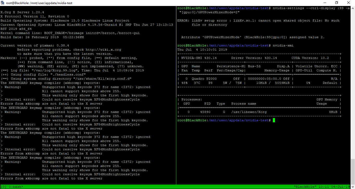

On 5/27/2019 at 6:59 PM, Xaero said:
@CHBMB I too see this high power consumption. I know why it's happening, too.
Basically, the nvidia driver doesn't initialize power management until an Xorg server is running. The only way to force a power profile on Linux currently is to use nvidia-smi like so:
nvidia-settings --ctrl-display :0 -a "[gpu:0]/GPUPowerMizerMode=2"
Which requires a running Xorg display. I've been trying to dig around in sysfs to see if there is another place that this value is stored, but there doesn't seem to be. It looks like the cards are locked into performance mode... Perhaps this is worth bringing up to nvidia?
In the meantime, I'm going to continue digging to see if I can find a way (perhaps an nvidia-settings docker?) to force the power state.
Did you get any further with that? I would love to see the card going back to P8 state after transcoding with plex. I don't really understand what you mean with the Xorg server. I know it's a display server but don't get how this two things are connected to each other. Could you explain that? Thanks.
Basically, the Nvidia Linux drivers are designed such that they aren't fully independent of the display server. Parts of the driver aren't active until a display server like X11 or Wayland hooks the driver resources.
As a result of there not being an active display in the unraid environment, nvidia-settings can't be called to change driver settings. In the example above ":0" is shorthand for: "localhost:0.0" which is the first screen, on the first display server, on the local machine. That display doesn't exist, so the n idia settings application just tells you it can't do what you asked.
Normally, in Linux land, we have "sysfs" nodes for driver and hardware settings. "Sysfs" is the /sys/ folder on Linux systems. All of the driver flags, power states, temperature sensors, etc live in this folder as files. Nvidia, for whatever reason, has avoided embracing both KMS (kernel mode setting, which let's the kernel make decisions about what the display should be doing during boot) and sysfs nodes.
This honestly is something Nvidia should be fixing. We might be able to band-aid it by running a display server in a docker with the Nvidia settings application and using it to manage the power state. It also might fail horribly.
It might be better to create a fake second X server on unraid itself using a userscript as the temporary solution.
EDIT2:
Just tested my above theory with a fake X server on unraid and it works perfectly. Let me write a userscript to create one of these fake environments on the fly.
Edited by Xaero

Starting the X server on Unraid does allow one to open nvidia settings; to do this you can use a script like this to start the X server (note, that since chvt and fgconsole aren't available, you will have to switch back to VT7 by pressing Ctrl+Alt+F7):
#!/bin/bash
##This will only work on single GPU systems:
GPUID=$(nvidia-xconfig --query-gpu-info | grep BusID | sed 's/^[^:]*: //')
#Now that we know the PCI BusID of the card we can create the X server with a fake display:
nvidia-xconfig -s -a --allow-empty-initial-configuration --use-display-device=None --virtual=640x480 --busid "$GPUID" -o /dev/stdout | X :99 -config /dev/stdin&
Once you have that server running, you can return to the default unraid GUI and run:
nvidia-settings -c :99
To open nvidia-settings on the card. You could also store an xorg configuration file and use that for the virtual X display, and to set persistent nvidia settings.
