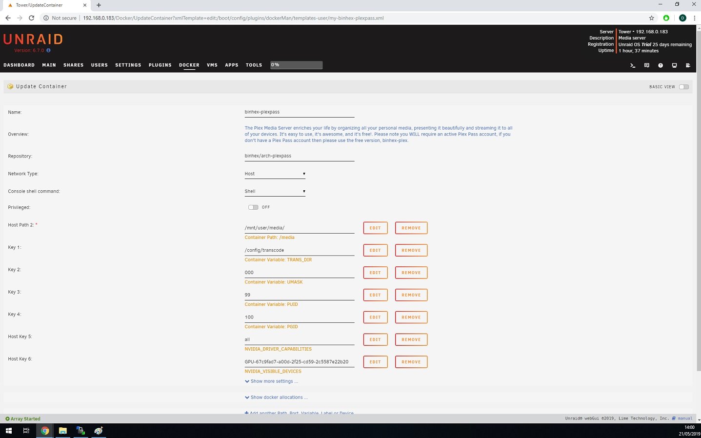

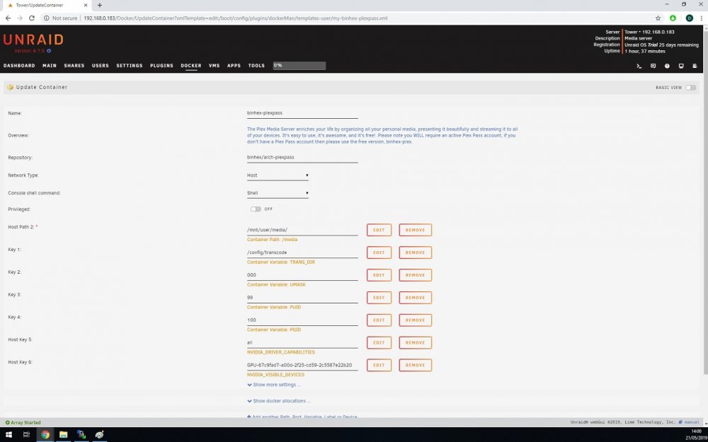

Reposted with more details and images;
Spec:
CPU: i7-3770S
MB: ASRock Z77 Extreme11
RAM : 24GB
GPU: 1050Ti
Unraid Version: 6.7.0 Nvidia build - Not running any patch to bypass transcode limit
binhex-emby - latest (I have an Emby Premiere Subscription)
binhex-plexpass - latest (I have a Plex Pass)
No VMs running or installed

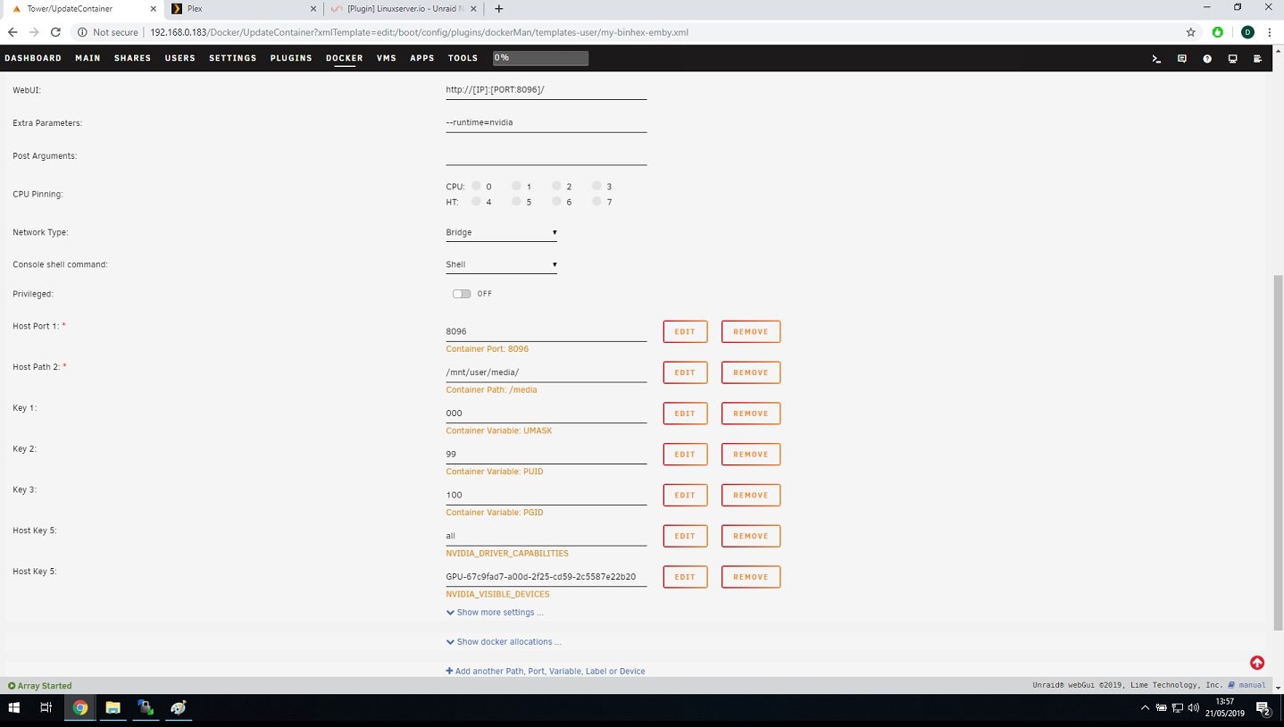

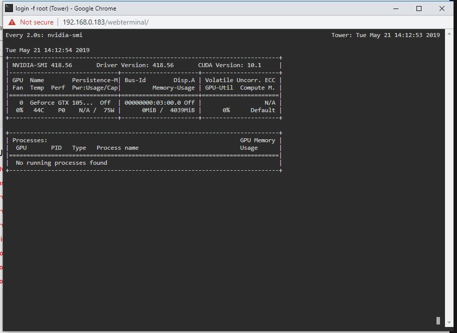

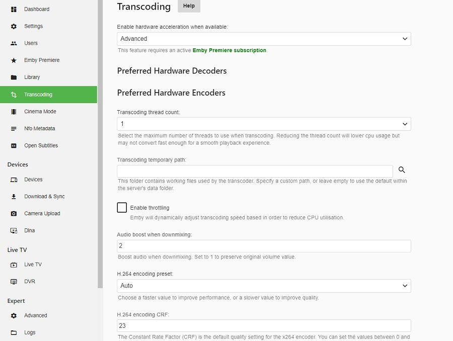

Emby isn't showing the GPU and isn't HW transcoding:

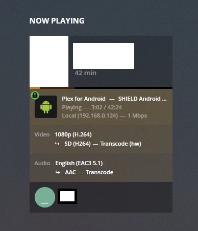

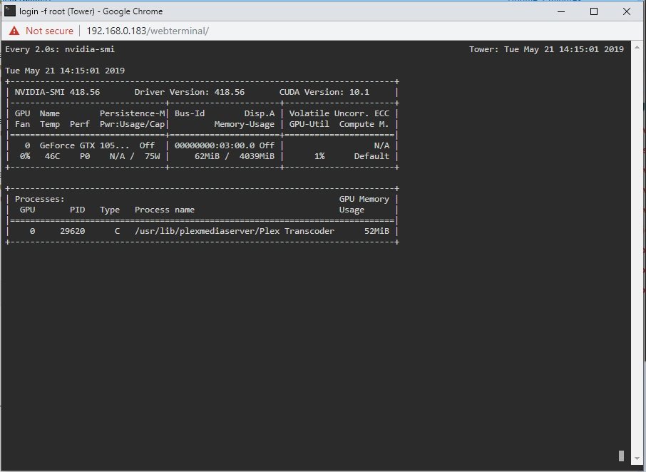

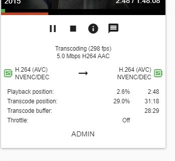

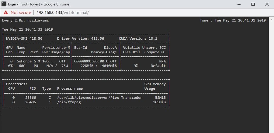

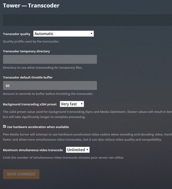

Plex isn't showing the GPU but is transcoding:
nvidia-smi_plex_transcode_stat.jpg.578c630a59f50394ab8d61f2b188b5c8.jpgbinhex-plexpass_transcode_conf.jpg.703b476a688894987ccdc4c497c36a99.jpg
I get this message as soon as I run the either dockers, but it does appear to be transcoding for Plex. The last two line just repeat over and over again.
May 21 14:06:12 Tower kernel: nvidia-uvm: Loaded the UVM driver in 8 mode, major device number 245
May 21 14:06:12 Tower kernel: resource sanity check: requesting [mem 0x000c0000-0x000fffff], which spans more than PCI Bus 0000:00 [mem 0x000d4000-0x000d7fff window]
May 21 14:06:12 Tower kernel: caller _nv000934rm+0x1bf/0x1f0 [nvidia] mapping multiple BARs

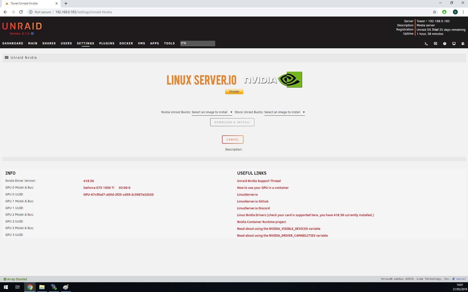

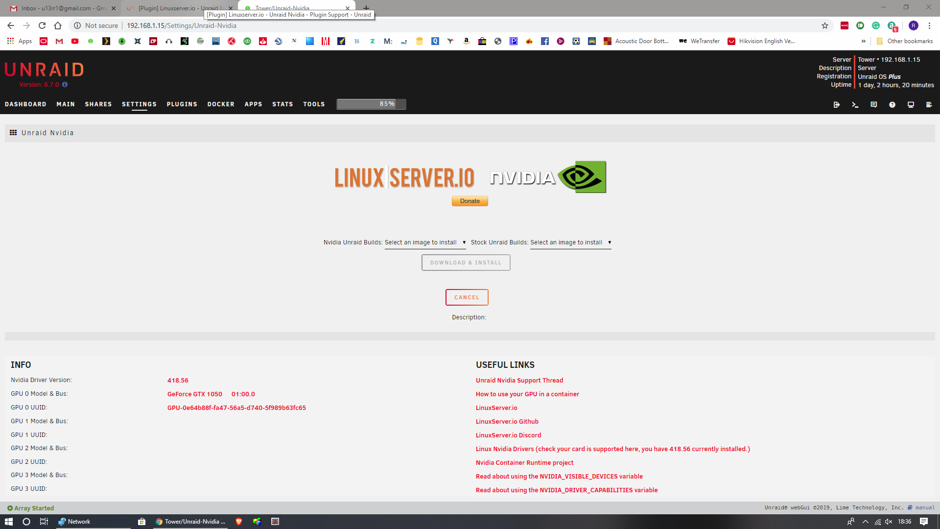

Unraid Nvidia page:

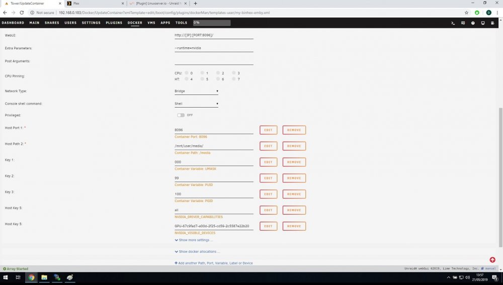

binhex-emby docker config:
binhex-plexpass docker config:
Any ideas?
Thanks

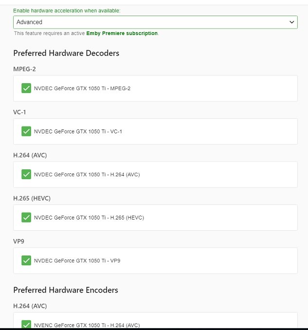

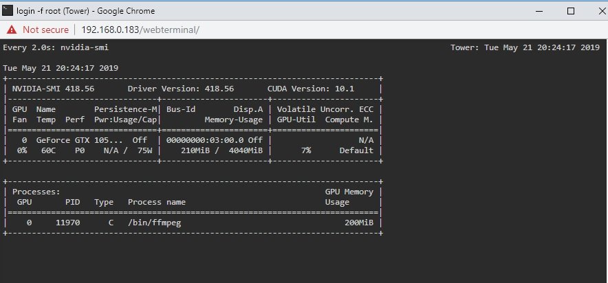

Ah this is damn annoying. So I just installed the Emby docker from Emby and HW transcoding is working fine...
EMBY-emby_transcode_conf.jpg.293eaa42c16098056521cbac257178cf.jpgEMBY-emby_transcode_dashboard.jpg.417406d1ccad757853763488e1280a77.jpgnvidia-smi_emby_transcode.jpg.b45ae80419aeac8b58dfa6352e299a1c.jpg
