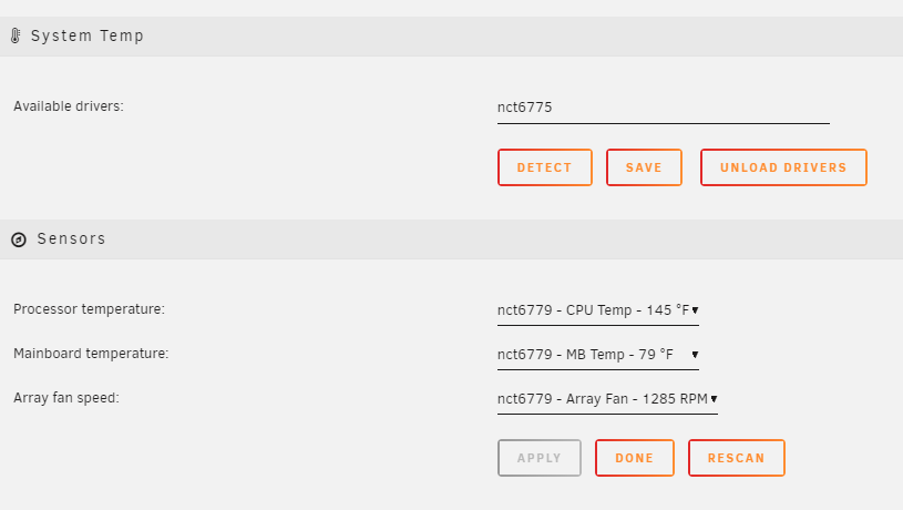

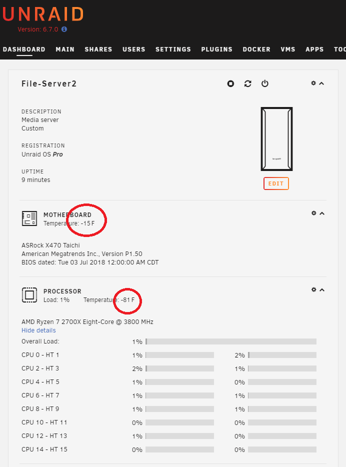

  5. Seeing negative/wrong MB/CPU temps on dashboard on unraid 6.7.0 / Dynamix System Temperature 2019.01.12a Any idea what I'm doing wrong? (See attached:)
