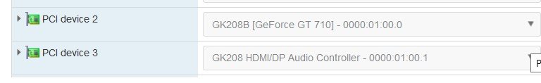

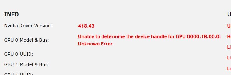

Hi All
I'm running UnRaid 6.6.7 as a VM on ESXi 6.7. I'm passing my GT 710 graphics card through (see pic) however the nvidia setting reports it can't see the card correctly:
"Unable to dertermine the device handle got GPU 0000:1B:00.0: Unknown error"
Checking the logs I see the following entry:
kernel: NVRM: RmInitAdapter failed! (0x23:0x56:483)
kernel: NVRM: rm_init_adapter failed for device bearing minor number 0
Has anyone got it to work with UnRaid as a VM? Anyone give me any pointers?

8 minutes ago, IrishBiker said:
Hi All
We only do testing when unraid is running on bare metal / host os. I suspect it could be to do with nvidia not liking their cards running in a virtual environment which is why you're getting this issue.
do your card working correctly, if you pass it to Windows VM for example?
Yes, well it was recognized in Device Manager. I'm getting hold of a HP NVIDIA QUADRO P620. Will try that when it arrives.
You may have to manually supply the BIOS for the consumer cards. The Quadro P620 should play well in a VM, however.
Edit:
I see you are running esxi, my bad;
try doing this:
 right click your VM > Edit Settings > VM Options > Advanced > Edit Configuration > Add Parameter:
hypervisor.cpuid.v0 = "FALSE"
Someone on Reddit reported that to work getting the drivers installed on Windows, hopefully it does for Linux as well. Should only apply to *consumer* cards. The Quadro, again, should play well in a VM.

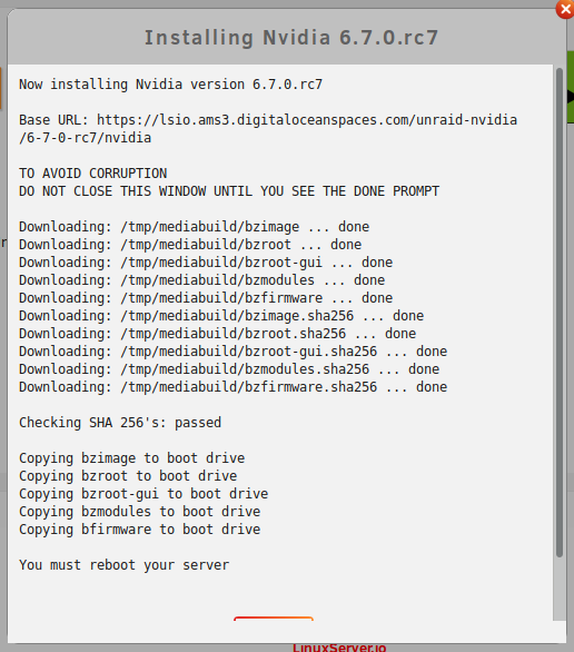

I figured out my failure... If you don't wait for the "Done" button to appear and you exit the window any sooner, you will corrupt the install...
Is there any way to show write process in the window after the checksum pass? That way we know it's still in operation?
I've made the routine a little more verbose and added a warning.  Just update the plugin....
