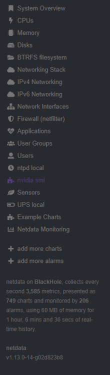

On 3/13/2019 at 4:11 AM, Allram said:
Thanks, the link made it very easy - much appreciated! I'll get it yet :D
After running the script posted. You can see the nvidia smi entry highlighted in purple.
And yes, this is with titpetric/netdata from Community Apps.
Do you have the container set to save it's configuration to an appdata folder, perhaps? If so I think on startup it copies or symlinks the one in the appdata folder over the top of the one that script writes to. It also overwrites the file every time the container updates.

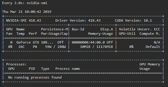

First off, thank you so much the LSIO team for this.  You made this process so easy and I know full well how much time it took to get this working so well.
I think I have this working and I see the (hw) next to my test transcode but watch nvidia-smi is showing nothing under processes (1st pic).  It's definitely reading that there is one because when I stop the video is shows "No processes found" as you can see in the second pic.
Edited by IamSpartacus
Run the nvidia-smi from Unraid cli directly, not from the docker cli, this way youll see the process name when it's in use.
Ahhh sweet, that worked thanks.

On 3/9/2019 at 8:50 PM, Xaero said:
That is something that would need support added for the netdata docker. There's a plugin here:
https://github.com/coraxx/netdata_nv_plugin
That would allow you to monitor various GPU statistics via netdata. Note that it doesn't monitor the nvdec and nvenc pipelines, so you wouldn't be able to see the transcoding usage - just the memory usage.

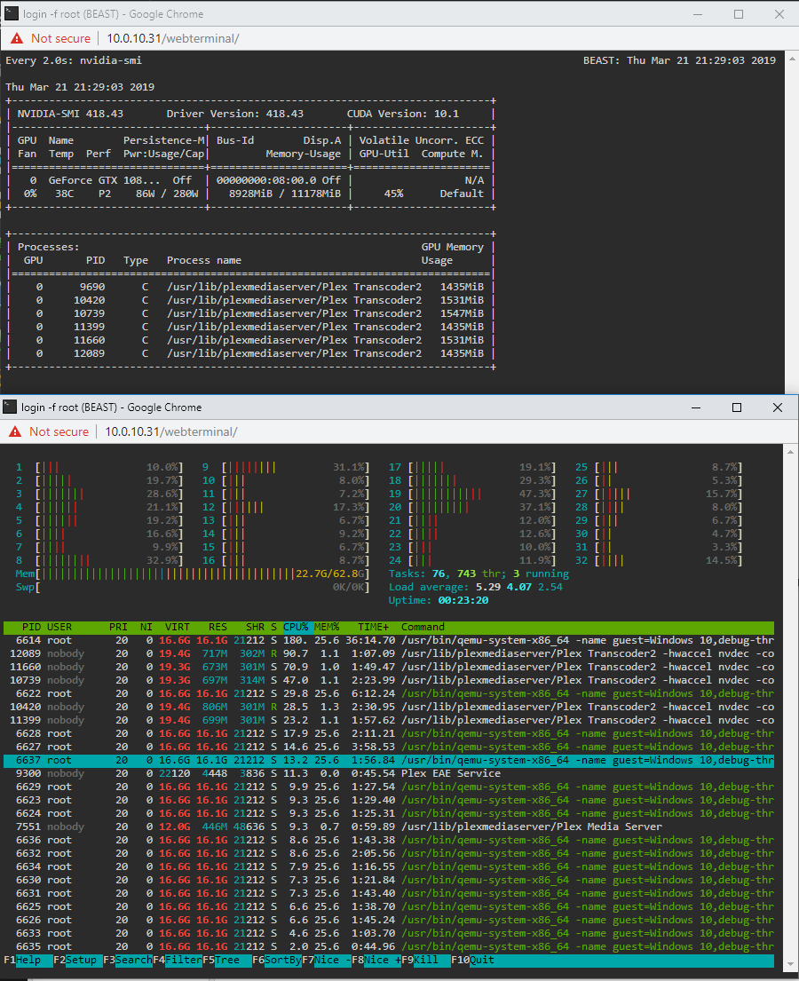

Tested transcoding six 4K HDR10 50-80Mbps files down to 2-4Mbps streams all at once.  Obviously not at all a real world test because I'll never be transcoding 4K at all (at least not on purpose) but was cool to see how well my 1080Ti handled it.

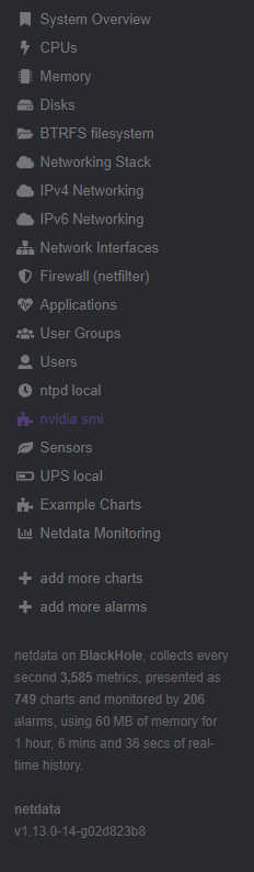

I checked, NOT there and no it's not saving data elsewhere. I just updated the container though and re-ran the script - which declared it had already been run for some reason despite my rebuilding\upgrading. Refreshed the screen and it's THERE! I wonder if they did something to the latest release? In any case it's there and this is REALLY cool :)
One odd thing - I notice that I have, under users, a set of GUID that you don't. The GUID I have are for individual containers. I can see usage of various things for each of them - just by GUID and not name. It would be way more useful by name but anyway I just thought I'd point out this difference as you might also want to be able to monitor individual containers resource usage. No idea how I ended up with this and you didn't though but let me know if you'd like to compare setup notes to try and get it!
Thank You!
The container data becomes present over time. The support page has documentation on how to pass thru something to make it happen instantly but recommends against it for security reasons
If you leave it running the GUIDs should eventually become the container names. I don't normally run netdata.
