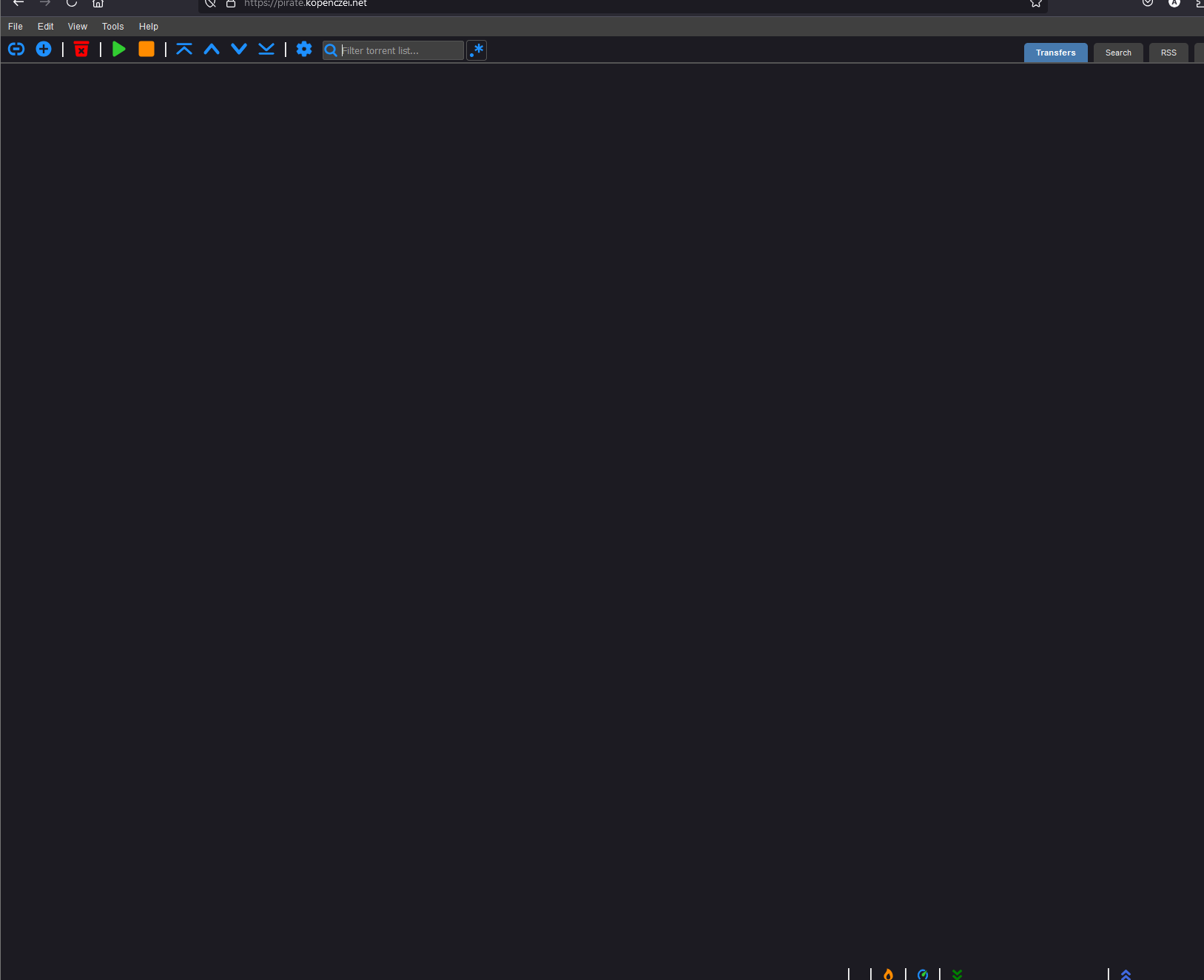

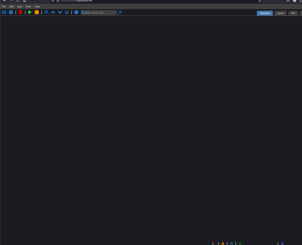

  3. Anybody else facing this issue? It seems that the parts where the torrents should be is black, and If I go to the menu items, it seems like it is hidden behind that center section.

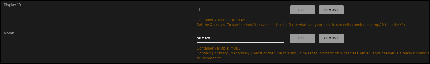

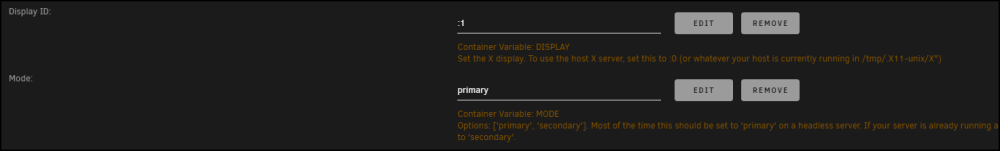

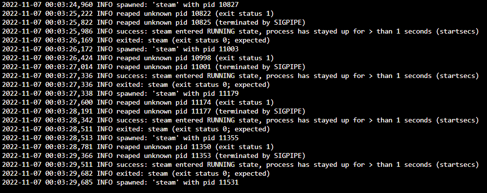

  4. So further digging: I booted into the Unraid GUI. The X server in Unraid is storing the configs in /etc/X11/xorg.conf, and it creates the file /tmp/X0-lock and NOTHING in the .X11-unix folder that is mapped to the container. I think this is why some people in the thread are not able to get this container to run. I tried changing the display variable, I tried changing primary/secondary variable but the container would not run. The steam process keeps restarting over and over: so I think there needs to be some sort of config to handle this? Next I will try to copy the xorg.conf file from /etc/X11 somewhere persistent and then map it to the container is hopes of getting this to work.
  5. So I went into the BIOS settings of the server, I set prefer "VGA offboard". I was watching Unraid boot on the TV, and then the screen just turned off. I don't know much about this x11 settings, but could it be that this is not working for me because I am using Unraid OS (Without GUI) and Unraid is not loading X server? in /tmp/.X11-unix I have a files called "X1=" and a folder called "run" I am not sure what should be in here. When I restart the container the X1= file disappears. I think this is because my server is not running Xorg normally.

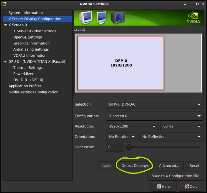

  6. Hi Josh, I think it works differently with server boards, the display defaults to the on board graphics card even though there is nothing connected to it. The output of the On board graphics is VGA only, I don't even have a VGA compatible screen anymore lol. I have a TV connected to the Titan though, but so far every time I booted the server the TV was off. I will try to boot unraid with the TV ON. Sure would be nice to be able to use the NVidia X server settings to detect the displays. I see the button but it doesn't seem to do anything If you have a hint on how to properly trigger the detection, just push me in the right direction, I would much appreciate it!

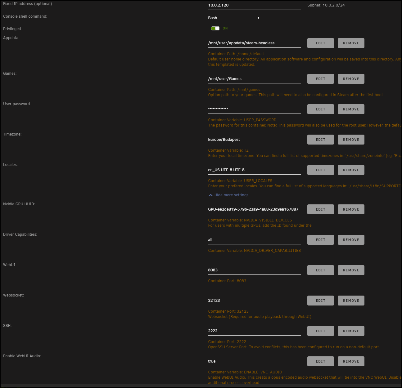

  7. Hi Josh, Thanks for your hard work on this container. I have been reading through these posts and something caught my eye, am I supposed to be able to connect my GPU to my TV and be able to get an Image that mirros what I see in the browser? At the moment this is not working for me, but it would solve my workaround of having to shut this container and emby down to be able to run a VM that can use the GPU. Here is my setup: I have a Supermicro motherboard with built in graphics and I also have an Nvidia Titan X GPU. I run Unraid without the gui, so no displays are connected except a TV to the Nvidia GPU. Emby encoding/decoding is working fine, I am also able to play games at pretty high resolutions in the browser through VNC. Audio works through the browser too. But I am not getting any output on my TV connected via HDMI to the GPU. With the card passed through to a Linux or Windows VM, the card is working as expected. Please see my settings below: Extra Parameters: --runtime=nvidia --dns='10.10.1.2' --hostname='SteamHeadless' --add-host='SteamHeadless:127.0.0.1' --restart=unless-stopped --shm-size=8G --ipc="host" -v '/tmp/.X11-unix':'/tmp/.X11-unix':'rw' -v '/dev/input':'/dev/input':'ro' --log-opt max-size=50m --log-opt max-file=1 Here are the logs of the container: [ /etc/cont-init.d/10-setup_user.sh: executing... ] **** Configure default user **** Setting default user uid=99(default) gid=100(default) usermod: no changes Adding default user to video, audio, input and pulse groups Adding default user to any additional required device groups Adding user 'default' to group: 'user-gid-71' for device: /dev/input/event0 Adding user 'default' to group: 'user-gid-18' for device: /dev/dri/card0 Setting umask to 000 Create the user XDG_RUNTIME_DIR path '/tmp/.X11-unix/run' Adding default home directory template Setting ownership of all log files in '/home/default/.cache/log' Setting root password Setting user password DONE [ /etc/cont-init.d/20-configre_sshd.sh: executing... ] **** Configure SSH server **** Disable SSH server DONE [ /etc/cont-init.d/30-configure_dbus.sh: executing... ] **** Configure container dbus **** Container configured to run its own dbus DONE [ /etc/cont-init.d/30-configure_udev.sh: executing... ] **** Configure container to run udev management **** **** Ensure the default user has permission to r/w on input devices **** DONE [ /etc/cont-init.d/40-setup_locale.sh: executing... ] **** Locales already set correctly to en_US.UTF-8 UTF-8 **** DONE [ /etc/cont-init.d/50-configure_pulseaudio.sh: executing... ] **** Configure pulseaudio **** Configure pulseaudio to pipe audio to a socket DONE [ /etc/cont-init.d/60-configure_gpu_driver.sh: executing... ] **** Found NVIDIA device 'NVIDIA TITAN X (Pascal)' **** **** Found Intel device 'Intel(R) Xeon(R) CPU E5-2690 v2 @ 3.00GHz' **** Install Intel vulkan driver **** No AMD device found **** DONE [ /etc/cont-init.d/70-configure_xorg.sh: executing... ] **** Generate NVIDIA xorg.conf **** Configure container as primary the X server Leaving evdev inputs disabled Configuring X11 with GPU ID: 'GPU-ee2de819-579b-23a9-4a68-23d9ea167887' Configuring X11 with PCI bus ID: 'PCI:4:0:0' Writing X11 config with Modeline "1920x1200R" 154.00 1920 1968 2000 2080 1200 1203 1209 1235 +hsync -vsync WARNING: Unable to locate/open X configuration file. Package xorg-server was not found in the pkg-config search path. Perhaps you should add the directory containing `xorg-server.pc' to the PKG_CONFIG_PATH environment variable No package 'xorg-server' found Option "ProbeAllGpus" "False" added to Screen "Screen0". Option "AllowEmptyInitialConfiguration" "True" added to Screen "Screen0". New X configuration file written to '/etc/X11/xorg.conf' DONE [ /etc/cont-init.d/80-configure-dind.sh: executing... ] **** Configure Dockerd **** Enable Dockerd daemon DONE [ /etc/cont-init.d/90-configure_neko.sh: executing... ] **** Configure Neko **** Disable Neko server DONE [ /etc/cont-init.d/90-configure_sunshine.sh: executing... ] **** Configure Sunshine **** Disable Sunshine server DONE [ /etc/cont-init.d/90-configure_vnc.sh: executing... ] **** Configure VNC **** Configure VNC service port '32036' Configure noVNC service port '32037' Configure audio websocket port '32038' Configure pulseaudio encoded stream port '32039' Enable VNC server DONE [ /etc/cont-init.d/95-configure_secondary.sh: executing... ] DONE [ USER:/home/default/init.d/install_heroic.sh: executing... ] Hit:1 http://deb.debian.org/debian bullseye InRelease Hit:2 http://deb.debian.org/debian-security bullseye-security InRelease Get:3 http://download.opensuse.org/repositories/home:/strycore/Debian_10 ./ InRelease [1,497 B] Get:4 http://deb.debian.org/debian bullseye-updates InRelease [44.1 kB] Hit:5 https://nvidia.github.io/libnvidia-container/stable/debian10/amd64 InRelease Hit:6 https://nvidia.github.io/nvidia-container-runtime/stable/debian10/amd64 InRelease Hit:7 https://nvidia.github.io/nvidia-docker/debian10/amd64 InRelease Fetched 45.6 kB in 2s (19.8 kB/s) Reading package lists... Reading package lists... Building dependency tree... Reading state information... heroic is already the newest version (2.5.0-beta.1). 0 upgraded, 0 newly installed, 0 to remove and 2 not upgraded. Reading package lists... Building dependency tree... Reading state information... zenity is already the newest version (3.32.0-6). 0 upgraded, 0 newly installed, 0 to remove and 2 not upgraded. Archive: /home/default/Downloads/HeroicBashLauncher-v3.0.1.zip creating: HeroicBashLauncher-3.0.1/ creating: HeroicBashLauncher-3.0.1/HeroicBashLauncher/ inflating: HeroicBashLauncher-3.0.1/HeroicBashLauncher/how-to-guide.txt inflating: HeroicBashLauncher-3.0.1/HeroicBashLauncher/settings.config inflating: HeroicBashLauncher-3.0.1/HeroicBashLauncher/HeroicBashLauncher creating: HeroicBashLauncher-3.0.1/HeroicBashLauncher/GameFiles/ inflating: HeroicBashLauncher-3.0.1/HeroicBashLauncher/GameFiles/readme.txt creating: HeroicBashLauncher-3.0.1/HeroicBashLauncher/GameFiles/logs/ '/tmp/hbl/HeroicBashLauncher-3.0.1/HeroicBashLauncher/GameFiles/readme.txt' -> '/home/default/HeroicBashLauncher/GameFiles/readme.txt' '/tmp/hbl/HeroicBashLauncher-3.0.1/HeroicBashLauncher/HeroicBashLauncher' -> '/home/default/HeroicBashLauncher/HeroicBashLauncher' '/tmp/hbl/HeroicBashLauncher-3.0.1/HeroicBashLauncher/how-to-guide.txt' -> '/home/default/HeroicBashLauncher/how-to-guide.txt' '/tmp/hbl/HeroicBashLauncher-3.0.1/HeroicBashLauncher/settings.config' -> '/home/default/HeroicBashLauncher/settings.config' [ USER:/home/default/init.d/install_lutris.sh: executing... ] [ USER:/home/default/init.d/install_protonup.sh: executing... ] **** Starting supervisord **** Logging all root services to '/var/log/supervisor/' Logging all user services to '/home/default/.cache/log/' 2022-10-31 16:32:21,214 INFO Included extra file "/etc/supervisor.d/dbus.ini" during parsing 2022-10-31 16:32:21,214 INFO Included extra file "/etc/supervisor.d/desktop.ini" during parsing 2022-10-31 16:32:21,215 INFO Included extra file "/etc/supervisor.d/dind.ini" during parsing 2022-10-31 16:32:21,215 INFO Included extra file "/etc/supervisor.d/neko.ini" during parsing 2022-10-31 16:32:21,215 INFO Included extra file "/etc/supervisor.d/pulseaudio.ini" during parsing 2022-10-31 16:32:21,215 INFO Included extra file "/etc/supervisor.d/sshd.ini" during parsing 2022-10-31 16:32:21,215 INFO Included extra file "/etc/supervisor.d/steam.ini" during parsing 2022-10-31 16:32:21,215 INFO Included extra file "/etc/supervisor.d/sunshine.ini" during parsing 2022-10-31 16:32:21,216 INFO Included extra file "/etc/supervisor.d/udev.ini" during parsing 2022-10-31 16:32:21,216 INFO Included extra file "/etc/supervisor.d/vnc-audio.ini" during parsing 2022-10-31 16:32:21,216 INFO Included extra file "/etc/supervisor.d/vnc.ini" during parsing 2022-10-31 16:32:21,216 INFO Included extra file "/etc/supervisor.d/xorg.ini" during parsing 2022-10-31 16:32:21,216 INFO Included extra file "/etc/supervisor.d/xvfb.ini" during parsing 2022-10-31 16:32:21,216 INFO Set uid to user 0 succeeded 2022-10-31 16:32:21,233 INFO RPC interface 'supervisor' initialized 2022-10-31 16:32:21,233 CRIT Server 'unix_http_server' running without any HTTP authentication checking 2022-10-31 16:32:21,234 INFO supervisord started with pid 1 2022-10-31 16:32:22,238 INFO spawned: 'dbus' with pid 915 2022-10-31 16:32:22,244 INFO spawned: 'udev' with pid 916 2022-10-31 16:32:22,253 INFO spawned: 'dind' with pid 917 2022-10-31 16:32:22,263 INFO spawned: 'xorg' with pid 918 2022-10-31 16:32:22,275 INFO spawned: 'audiostream' with pid 921 2022-10-31 16:32:22,287 INFO spawned: 'novnc' with pid 924 2022-10-31 16:32:22,297 INFO spawned: 'pulseaudio' with pid 925 2022-10-31 16:32:22,311 INFO spawned: 'vncproxy' with pid 926 2022-10-31 16:32:22,329 INFO spawned: 'x11vnc' with pid 928 2022-10-31 16:32:22,337 INFO spawned: 'audiowebsock' with pid 932 2022-10-31 16:32:22,353 INFO spawned: 'desktop' with pid 933 PULSEAUDIO: Starting pulseaudio service 2022-10-31 16:32:22,357 INFO success: vncproxy entered RUNNING state, process has stayed up for > than 0 seconds (startsecs) 2022-10-31 16:32:22,687 INFO reaped unknown pid 968 (exit status 0) 2022-10-31 16:32:23,243 INFO success: dbus entered RUNNING state, process has stayed up for > than 1 seconds (startsecs) 2022-10-31 16:32:23,245 INFO success: udev entered RUNNING state, process has stayed up for > than 1 seconds (startsecs) 2022-10-31 16:32:23,246 INFO success: dind entered RUNNING state, process has stayed up for > than 1 seconds (startsecs) 2022-10-31 16:32:23,328 INFO success: xorg entered RUNNING state, process has stayed up for > than 1 seconds (startsecs) 2022-10-31 16:32:23,329 INFO success: audiostream entered RUNNING state, process has stayed up for > than 1 seconds (startsecs) 2022-10-31 16:32:23,330 INFO success: novnc entered RUNNING state, process has stayed up for > than 1 seconds (startsecs) 2022-10-31 16:32:23,330 INFO success: pulseaudio entered RUNNING state, process has stayed up for > than 1 seconds (startsecs) 2022-10-31 16:32:23,331 INFO success: x11vnc entered RUNNING state, process has stayed up for > than 1 seconds (startsecs) 2022-10-31 16:32:23,331 INFO success: audiowebsock entered RUNNING state, process has stayed up for > than 1 seconds (startsecs) 2022-10-31 16:32:23,369 INFO success: desktop entered RUNNING state, process has stayed up for > than 1 seconds (startsecs) 2022-10-31 16:32:27,720 INFO reaped unknown pid 1183 (exit status 1) 2022-10-31 16:37:30,855 INFO reaped unknown pid 1209 (exit status 0) 2022-10-31 16:40:55,727 INFO reaped unknown pid 1622 (exit status 0) 2022-10-31 16:40:55,728 INFO reaped unknown pid 1757 (exit status 1) 2022-10-31 16:40:55,728 INFO reaped unknown pid 1690 (exit status 0) 2022-10-31 16:40:55,728 INFO reaped unknown pid 1691 (exit status 0) Am I missing some configuration? or is it not possible to use the GPU to output to the TV?
