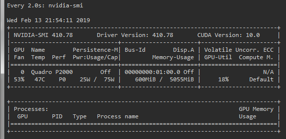

12 hours ago, casperse said:
Okay removed the modprobe it and did at reboot and now I have my console screen back on the primary P2000 card. 😊
I then started to play files and many files and I still couldn't see any stream on the "watch nvidia-smi" output console
But then I noticed that the load went up, and so is the memory so could it just be an error on the output screen?
I just tried rolling back to Version: 6.7.0-rc2 because I think it was working at that time, but no change?
Without the modprobe I just can't switch between the GPU and the iGPU (If I wanted to use it, temporarily example for some passthrough to a VM)
And on top of it all I can't see if its really working anyway? - Is there any monitoring available for the iGPU some linux command?
Last thing... is there any way to remove everything related to the Plex setup and transcoding and just start over with OUT creating a new UnRAID USB stick?
I was under the impression that dockers was contained, but it seems that GPU changes can happen many places in UnRaid
Remember this was working for a very brief moment ;-) and it might be working now? just cant see any of the streams in the "watch nvidia-smi"
As always your valuable insight is most appreciated!
I think you make this a little bit too complicated.
1. Follow the instructions in the first post on how to pass through the GPU. This way, the container only have access to the one you specify. Don't use priviliged. The nvidia gpu does not need to be the primary GPU.
2. What do you use the iGPU for? Only unraid console? Or pass through to a VM? If it's only for console, you don't need to modprobe it.
3. As long as plex/emby says hw transcode, it doesn't matter if nvidia-smi mention any running processes or not.
4. You don't need to setup unraid from scratch to start clean for plex. Just delete plex and also choose to delete the image. Then delete the appdata and install plex from a fresh template following the firsts post of this thread.
5. Not sure what you mean with gpu changes happens in a lot of places in unraid. It's not happening many places.
6. You don't need a monitor attached to the nvidia gpu to use it for transcoding.
I have been ad it for 2 days now so it starts to seem a little complicated to me ;-)
1) I did that, 3 times thinking I did something wrong, because the nvidia-smi mention did not show any running processes.
2) Yes as unraid console for now, would like to have it available for pass through?
or if I needed the GPU for special Adobe project I could then start Plex in another docker with the modprobe (But I removed to get the console back)
3) I think you nailed it by this comment! - I just did a BIOS change Intel Processor Graphics = Disabled and after that I still got HW transcoding but nothing showed up in the nvidia-smi mention any running processes! so this was working initial (See picture showing 10 processes, so I believed it had to work)
4) I did that 2 times, but stating the above it's probably working just not showing anything and most here use that as a test for success
5) I was afraid that me trying to test some GPU passthrough (Unsuccessful other issue) had caused some problem in general with the GPU?
6) Ok, then I will change the BIOS back to having the iGPU as primary using this as a console, and that would also fix my Black screen bug? during boot ;-)
So lesson learned -  Don't trust the nvidia-smi and disregard that it doesn't mention any running processes - if Plex is showing HW encoding!
THANKS @saarg for taking the time to explain this

nvidia-smi dmon -s u
There is column for enc. and one for dec., if it's not 0, it means it's working.
