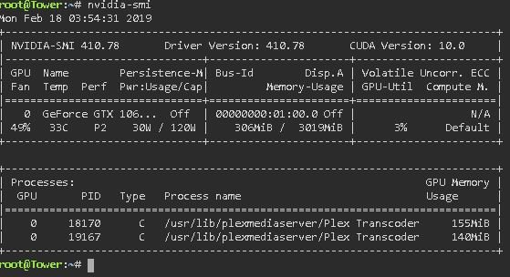

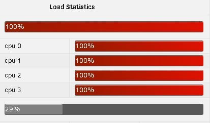

I am hoping some one can help me, I have installed a GTX1060 to do my transcoding, i followed the space invader one instructions to the letter and i think its sort of working. However my CPU is still going ballistic and two 4k streams it starts suffering. I am getting confirmation in the Nvidia-smi that its doing somthing but its certainly not taking the load of the CPU here are some screen grabs i hope some one can help. (plex has Use hardware acceleration when available turned on)
Edit: i am using the binhex-plespass docker if this makes any difference
terminal.JPG.300deabb963a7bd59cb7f0649bdf65d8.JPGglances.JPG.4ccb945407f61d803cce6382b8f17a41.JPGunraid.JPG.2917231ce42ea47e1c0209f999c29447.JPG
Edited by Randall8686
Plex only does hardware encode with Nvidia, not decode. Your cpu is maxing out trying to software decode the 4k stream. Nothing we can do until Plex adds ability to hardware decode.
Emby does both encode and decode via hardware with Nvidia.
Well that just put out my fire lol! i grabbed the 1060 to stop this high CPU load lol. so effectively adding the card has done pretty much zero for me :( do we have a time frame of if/when plex are going to add hardware decode? feel i just dropped a load of cash on a total waste of money lol. I have too many plex users to change to another format + some of their smart TV's are unlikely to support EMBY tbh. what a shame i wish i had worked this out before hand
Turn that frown upside down! If you want to force the decode through NVDEC, do the following:
1. Launch into the plex container shell.
2. Rename "/usr/lib/plexmediaserver/Plex Transcoder" >  "/usr/lib/plexmediaserver/Plex Transcoder2"
3. Create a new file called "/usr/lib/plexmediaserver/Plex Transcoder" and put this in the contents:
#!/bin/sh
/usr/lib/plexmediaserver/Plex\ Transcoder2 -hwaccel nvdec "$@"
4. chmod +x "/usr/lib/plexmediaserver/Plex Transcoder"
Done! Your transcodes should be encoded and decoded by nvidia. Plex doesn't reflect it because its a workaround, but check out your CPU utilization, should be negligible.
Unfortunately, you will have to run this everytime the plex docker gets updated until plex adds support for NVDEC officially.
Edited by endiz
16 minutes ago, endiz said:
Turn that frown upside down! If you want to force the decode through NVDEC, run the following script within the plex container shell:
I have tried this but now plex does not work at all :( "Conversion failed. The transcoder exited due to an error." is the error i get in plex. i have the binhex-plexpass" docker if this make any difference?
Follow my steps exactly, i just updated them
Edited by endiz

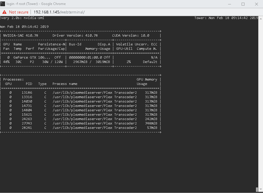

OK i have it working (big thanks to PDUCharme for helping me out and putting up with my stupidity) and endiz above. However i have one slight issue. when i watch a stream it uses the gpu now. however once i finish it does not close the transcoder down so now my plex is playing nothing yet this is what i get in nidvia-smi. its uses all the Vram and i cannot play anything. if i restart the container it works but i end up here again. image.png.43b65320098aae1f84adaa1d317fde73.png
Amazing work!! truly!!

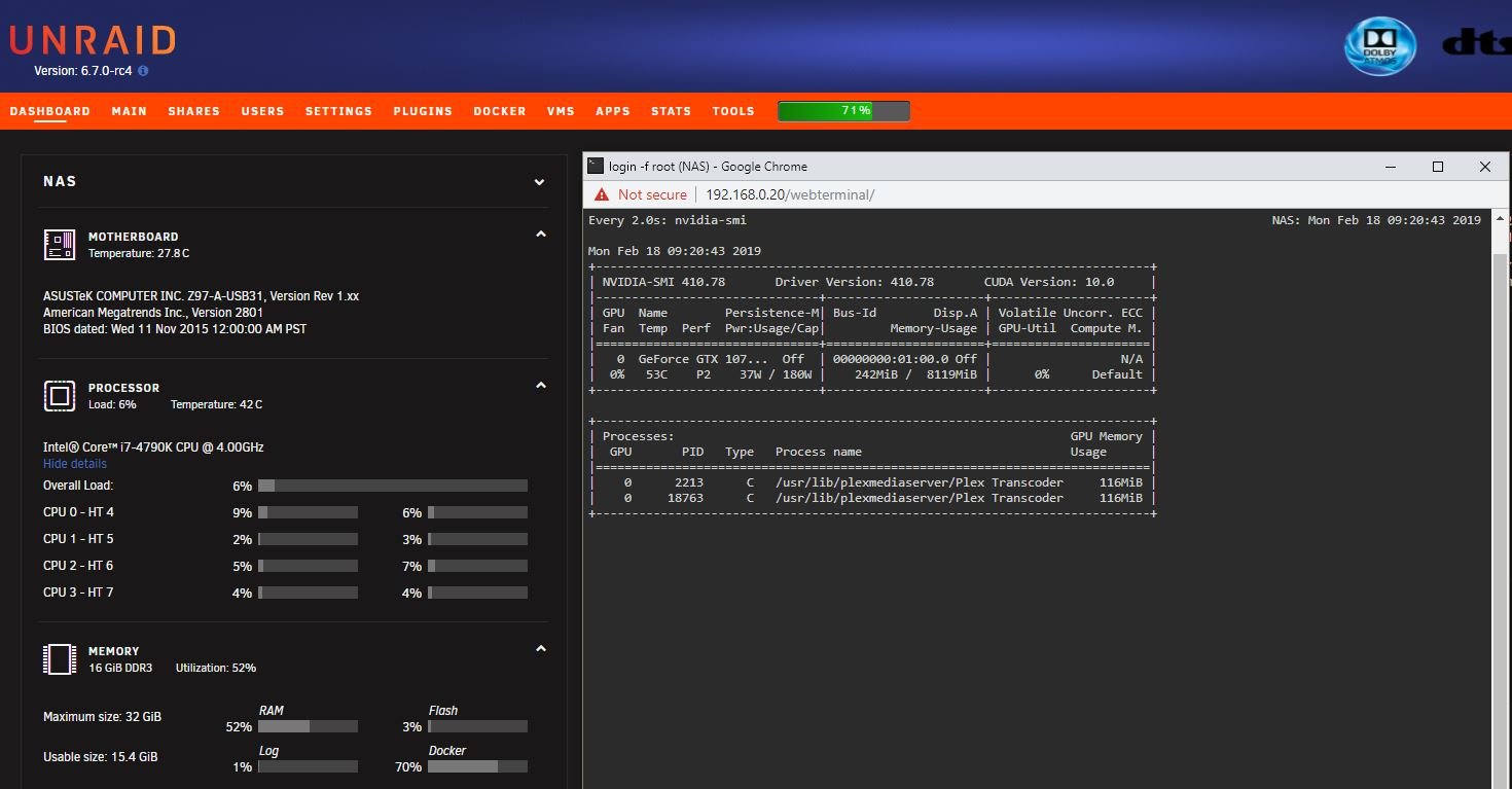

i just set this up a few days ago. it is working as expected and my CPU is just idling away..  i have added a Asus strix 1070ti dedicated gpu just for transcoding tasks. everything is working great however im curious to know how the GPU decides to use the amount of processing, power, and memory allocation. i also noticed that my card temp is rising to 53c when i have two streams running. yet the fans have not kicked in yet. is there way to adjust these settings?
Edited by MarkMV
Eventually the streams get cleaned up:
oh so they take time to go? how long does it usually take for it to clear from the smi?
