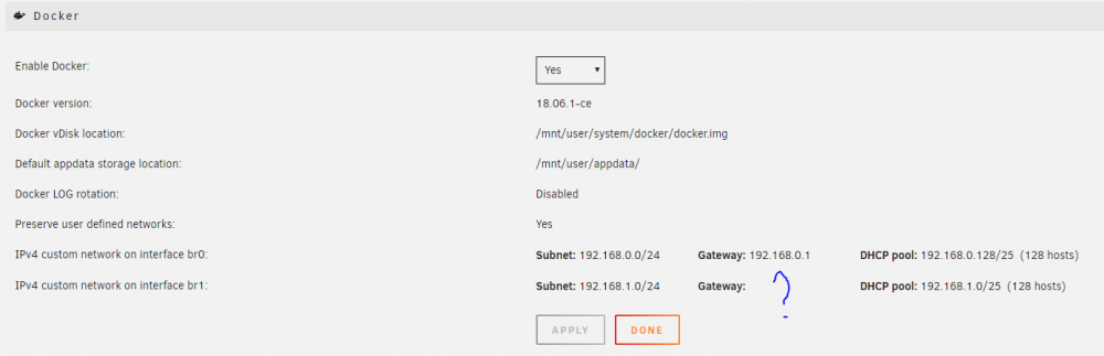

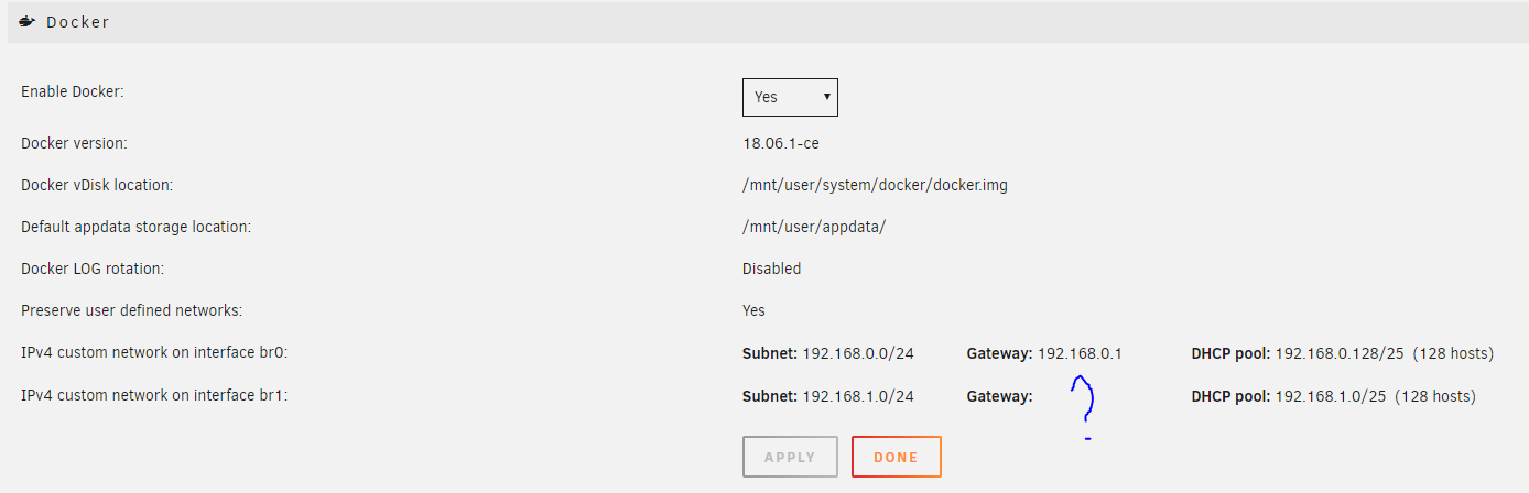

  7. Technically unraid takes eth0 as primary interface and creates bridge from it. In my docker setting however, I see that unraid automatically creates two bridge for the two seperate NIC. However for NIC2 unraid does not detect the gateway ip and it shows blank. That is why, whenever I swap my WAN to be on eth0 that domain name works, the wan that I tie to eth1 never works. I am not sure if this can be fixed by adding a static route between the two LAN gateways in UNRAID. Can anyone advice?
  8. Hi, first of all this is a fantastic docker and great work. Let me explain my situation. My unraid server has 2 nic and both connect to two seperate networks with 2 different isp, 2 different wan ips and seperate subnet. In unraid network setting I have eth0 for wan 1 and eth1 for wan2. I have installed 2 instance of this LE container and both are fetching certificates for two of my custom domains. These custom domains are pointing to my wan ip respectively. Both LE dockers are set to bridge mode. My issue is when I browse custom domain 1 it takes me to the right destination and reverse proxy work. Custom domain 2 does not take me to the destination and I get timed out message. When I swap wan 1 from eth0 to eth1 and wise versa in unraid network setting , my wan2 ip works and wan1 now don't work. Is it possible that the LE docker is hard-coded to only receive incoming connection on eth0 and not eth1?
