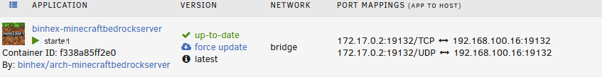

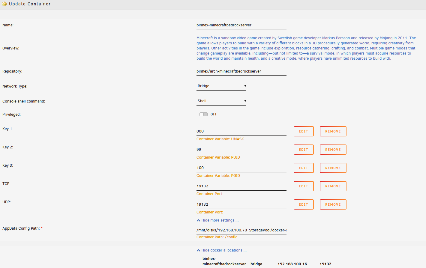

Hello,
Still pretty new to unraid and docker, but am slowly working my way through.
I am having trouble connecting to the bedrock server. I think it may be because of UDP/TCP ports. I have tried a few different settings, but I am at a lose.
I am simply trying to run the Bedrock server on my LAN. When I run a LAN game from my Win 10 machine, all the other clients (Xbox, other PC's) can see the server under the "Friends >LAN GAMES"  tab in Minecraft and can connect to it. So I guess its not a LAN specific issue.
But with the bedrock server, none of the clients can see the Server game. This leads me to think its the way I have setup the Docker. But I may be mistaken.
My config is in the screen caps below. Any ideas how I can fix this? or perhaps a resource that I could read to learn more?
Many Thanks
your config looks fine to me, i myself am running this image in exactly the same way and can connect via xbox one and minecraft pe.
do you have any vlan's setup or pfsense or something similar which might be blocking connections?.
