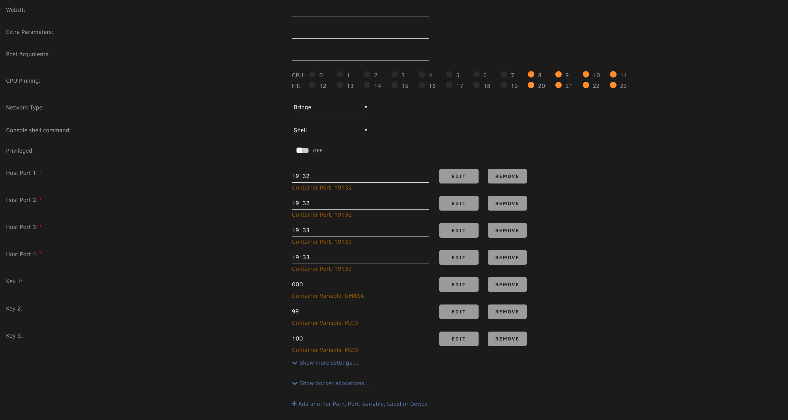

I've been noticing that only 1 cpu gets pinned to 100% at a time,  instead of the 8 cpu i've assigned to the docker, thus causing lag in the server, is this common?  and is there a fix for this?
Thanks

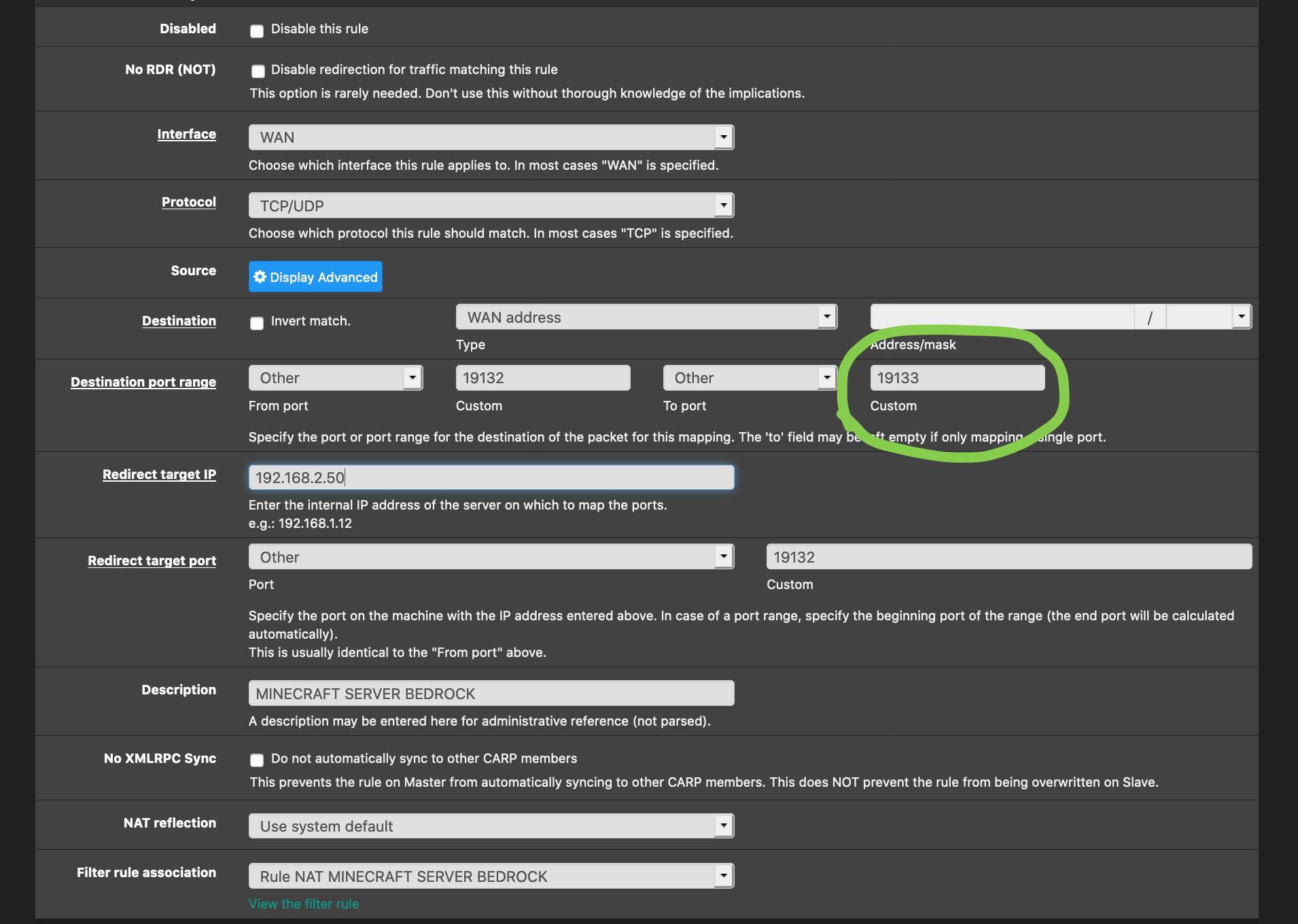

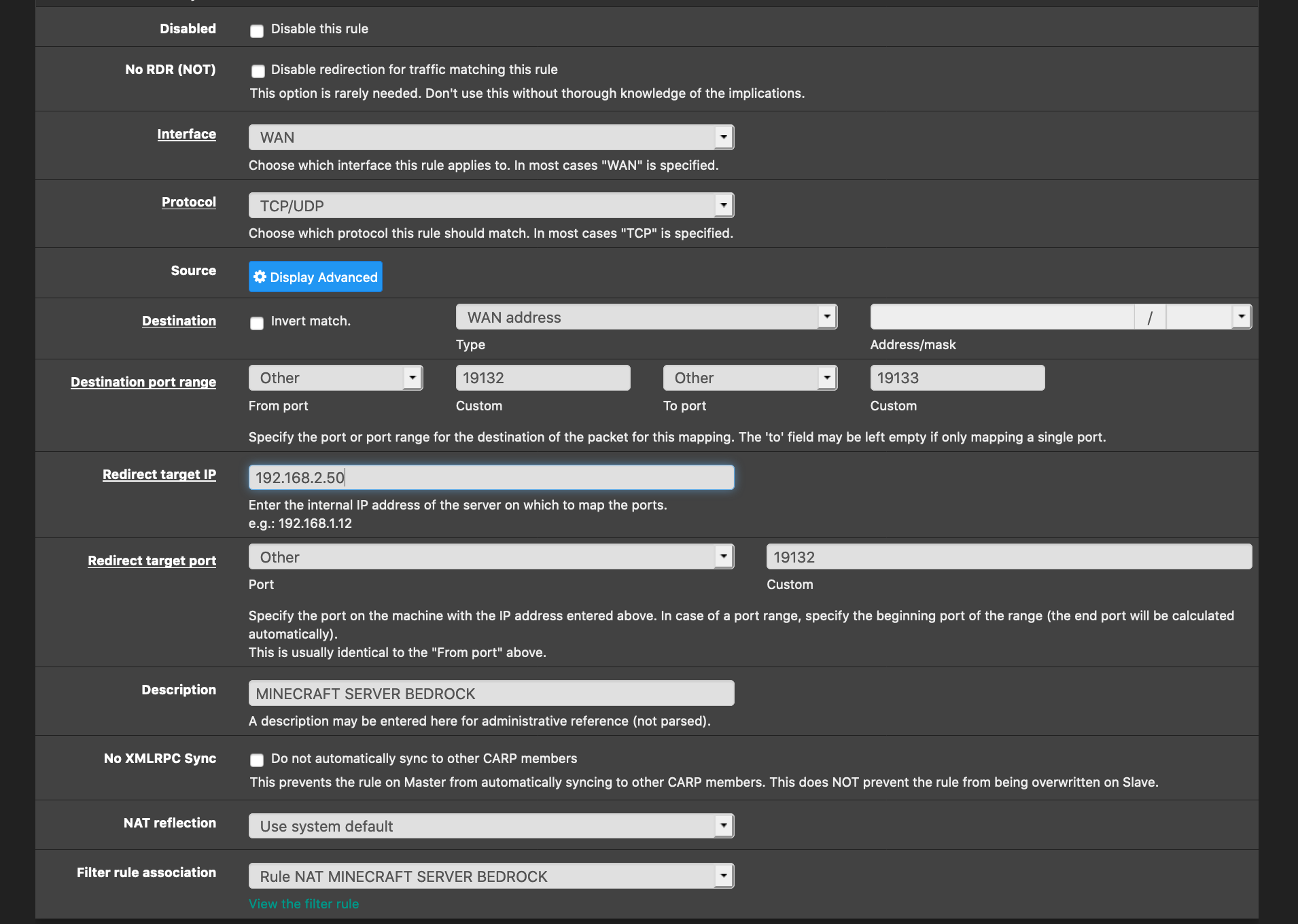

One last problem that I couldnt find the solution for in this thread.. I am trying to host it so external users can access it. I currently use pfSense as my router and I did set up port forwarding for 19132 TCP/UDP to point to my server but for some reason I cant connect. In the docker I've tried using a bridge connection that uses the same IP as my Unraid server and a custom proxy that my Plex server uses but setup a different IP.
Also, In the console when I started the server it couldn't local Server.properties. I was however able to connect to the server local on the LAN.

16 minutes ago, Mobious said:
Thank you that did the trick.
btw thank you for the help!
Yeah Spazhead that is what I have, the same config
should work, make sure the port range is set to  "19132 to 19133",  don't know why but after i did this it worked for me.
