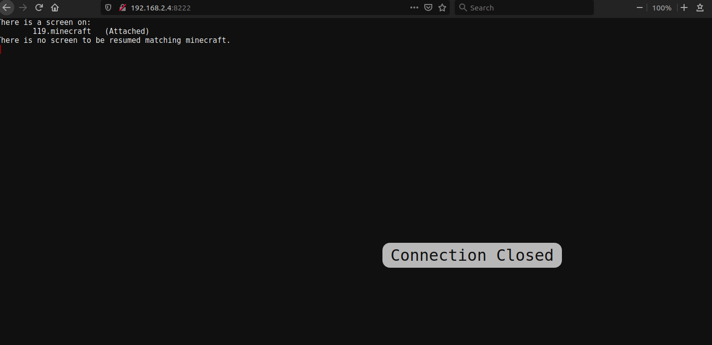

I added the docker lines and config for the terminal on port 8222. When I open my browser I am prompted to authenticate and I can login, but the page that loads simply says:
you can only attach once to the screen session, you already have something else connected, docker exec perhaps?
I dont understand what to do. I stopped the docker and restarted it. If I immediatly try connect with the console web the same issue happens. How can something already be connected if I just restarted it?

hmm thats a little odd i must admit, no idea whats reconnecting to the screen session so quickly after a reboot!, you def dont have two tabs open for your browser?, no smart tablets or anything also trying to reconnect to the console web ui?
I cant see anything connecting and it only on my LAN. I also have never used it before and am just trying form this 1 pc at the moment so havent got very far with it. I will wait and see if anyone else has any issues connecting because I am stuck :)

ok fair enough, it def works great for me, and there have been other users too who are using it with success so it SHOULD just work, you dont have backups set to backup really frequently do you?.
I havent altered the default settings but if you tell me where to check I can tell you what they are set to.
simplest way is to just attach /config/supervisord.log this should contain all env vars set.
Here you go :)
It does look like there are a lot of errors at the end :( - hopefully nothing drastic.
supervisord.log
18 minutes ago, PeteAsking said:
Here you go :)

and looking at your log you do have a successful connection, what device has ip address 192.168.2.11? whatever it is, this is the device that is connecting to the console via the web ui:-

Yes that IP is the machine I am trying from, and it prompts for the login, once it logs in I get that error though.
Ok restart the container and then try another browser, I think the issue may be some sort of adblock or maybe a script block add-on.

Wow thanks, you were correct. A different browser loaded it up fine. Apologies for wasting your time.
