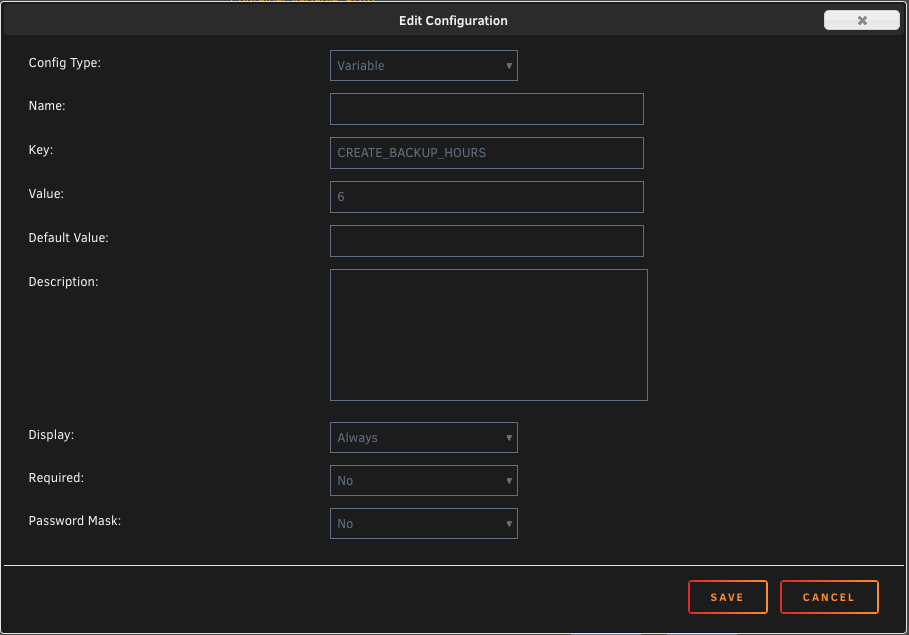

19 hours ago, PeteAsking said:
Th GUI I set key as the description and value as the integer. Is that right?
no, you set the key to be the key and the integer you want to be the value for the key, e.g screenshot below sets the creation of backups to be every 6 hours:-

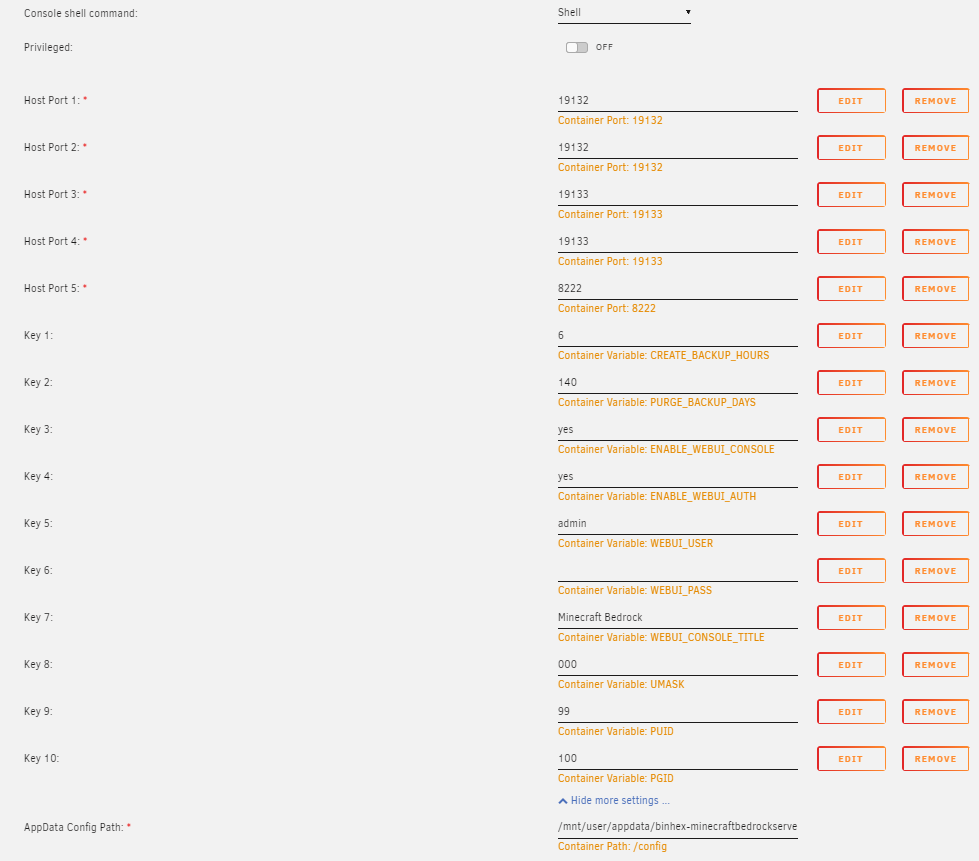

After adding this and applying, I see duplicates for backup hours and purge days, is this ok?
root@localhost:# /usr/local/emhttp/plugins/dynamix.docker.manager/scripts/docker run -d --name='binhex-minecraftbedrockserver' --net='bridge' -e TZ="Europe/London" -e HOST_OS="Unraid" -e 'CREATE_BACKUP_HOURS'='12' -e 'PURGE_BACKUP_DAYS'='14' -e 'ENABLE_WEBUI_CONSOLE'='yes' -e 'ENABLE_WEBUI_AUTH'='yes' -e 'WEBUI_USER'='admin' -e 'WEBUI_PASS'='<censored>' -e 'WEBUI_CONSOLE_TITLE'='Minecraft Bedrock' -e 'UMASK'='000' -e 'PUID'='99' -e 'PGID'='100' -e 'PURGE_BACKUP_DAYS'='7' -e 'CREATE_BACKUP_HOURS'='4' -p '19132:19132/tcp' -p '19132:19132/udp' -p '19133:19133/tcp' -p '19133:19133/udp' -p '8222:8222/tcp' -v '/mnt/user/appdata/binhex-minecraftbedrockserver':'/config':'rw' 'binhex/arch-minecraftbedrockserver'
no, you will need to remove the duplicates, if you are a new user then you do not need to add in these new keys, they will already exist in the template, you then simply tweak the 'values' to whatever you want.

Yep; should've checked the template before blindly adding the new values!
