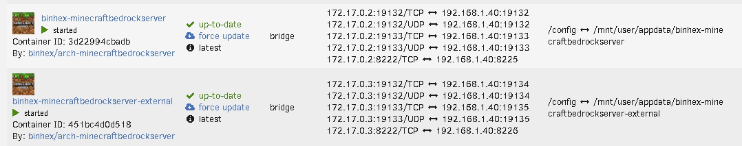

Now another oddity:
bedrock container 1 has 21 help menu pages.
bedrock container 2 has 3 help menu pages, and I can't perform commands such as 'gamemode' as it says the command is invalid.
you are probably in another subset of commands which has a smaller set of commands and thus help pages, just restart the container is the easiest way to get back to the root.
Huh.
So I restarted that container; no effect; still has only 3 help menus, and lots of commands don't work.
Might just try and copy the other container to this one's folder, and see what happens.
1 minute ago, sota said:
Huh.
it must be a different docker image then right?, is the other one binhex/minecraftbedrockserver ?
