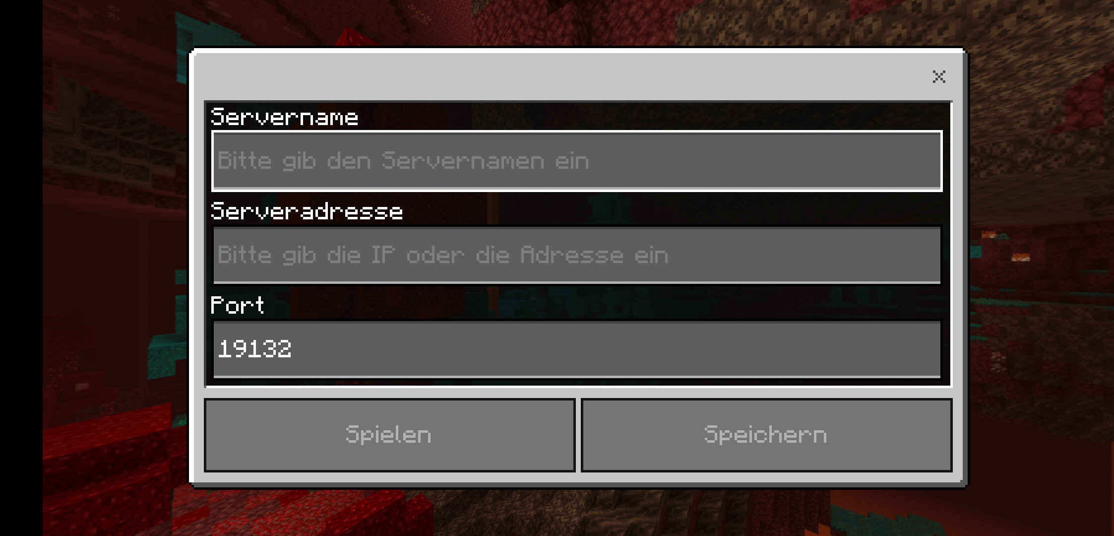

Here is a screenshot from android when you add a server:
I can tell you that this works if you create multiple instances (tested this with another container but not with yours @binhex but should also be no problem. ;) )
EDIT: I think you are talking of the 2nd tab within minecraft.
In the 3rd tab on the bottom you can add custom servers. ;)
