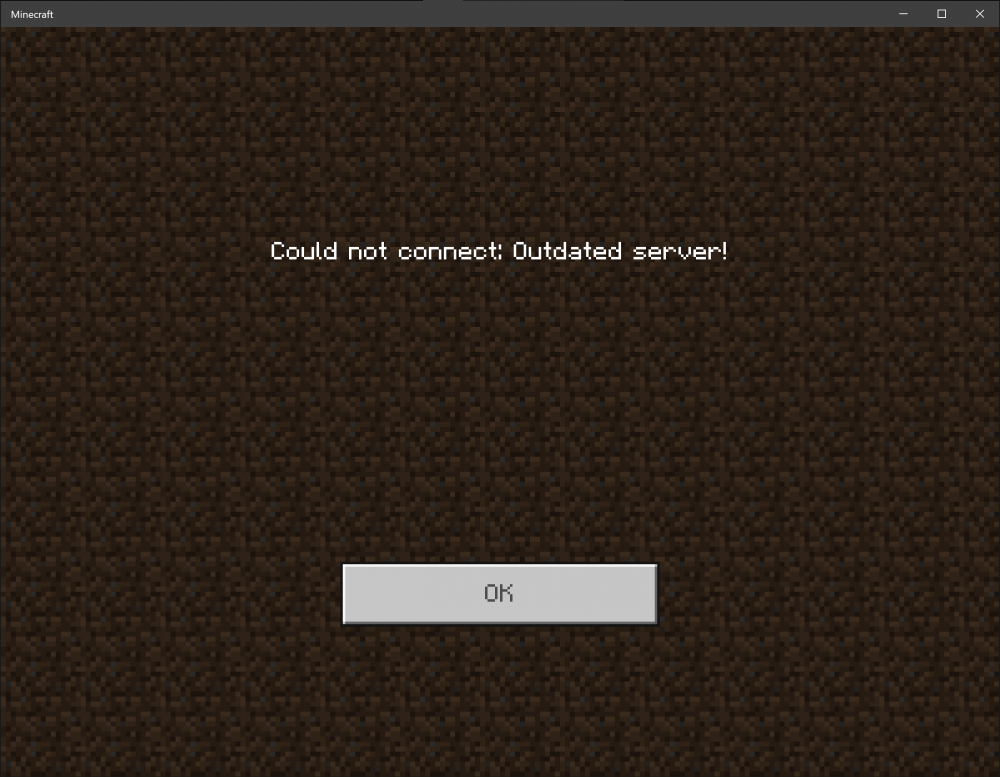

I just tried to set up a server using this container and everything seems to show up correctly but when I try to join it tells me "Could not connect: Outdated Server!". Is there some process I need to go through the bring it up to date or is there just an update to the container that's necessary?
make sure your server is up to date, click on check for updates and apply any that are outstanding.

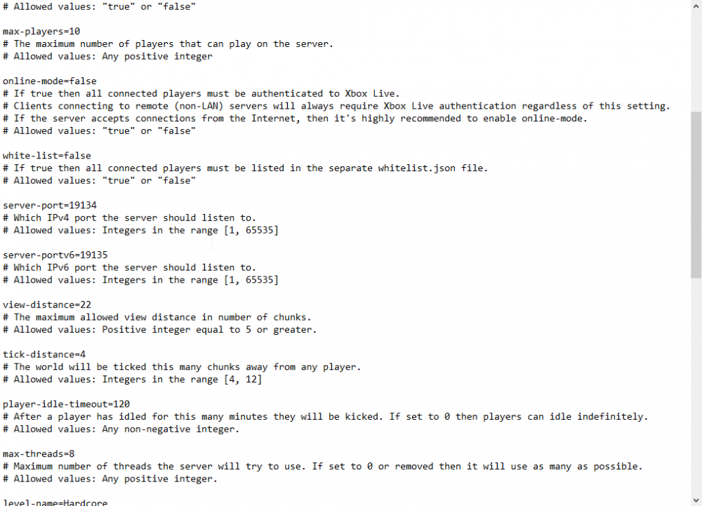

simple - edit the file /config/minecraft/server.properties and change line 17:-
max-players=10
# The maximum number of players that can play on the server.
# Allowed values: Any positive integer

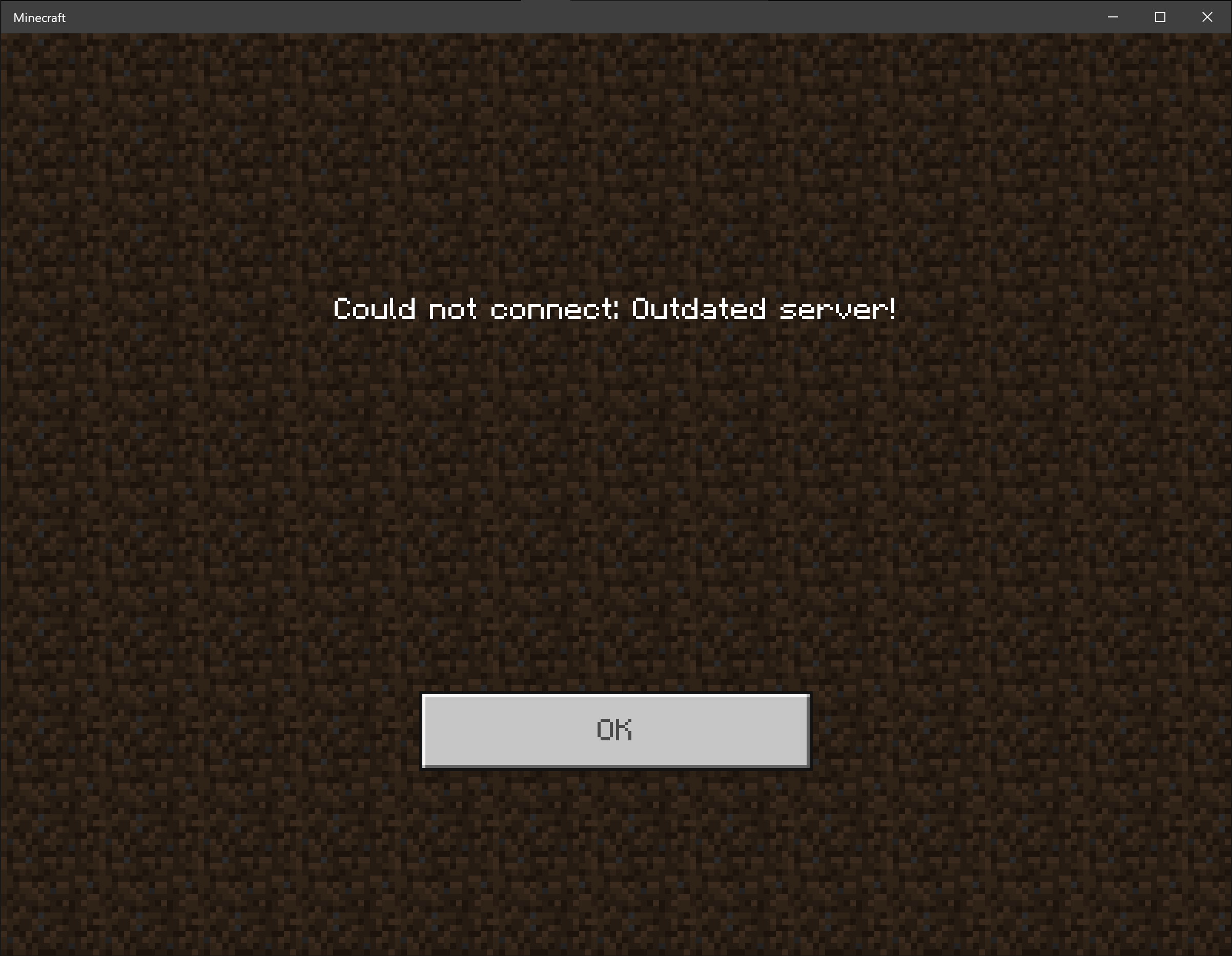

Just set up my first server.  Also getting an "outdated version" error connecting.
[2021-03-17 17:37:23 INFO] Version 1.16.210.06
Windows 10 Minecraft says 1.16.220.51.
Checking for updates still says up-to-date.  Is there an update coming or am I on the wrong server?
EDIT:  I figured it out.  Somehow I was a member of the "Insider" program and was running beta.  I opted out and all is well.

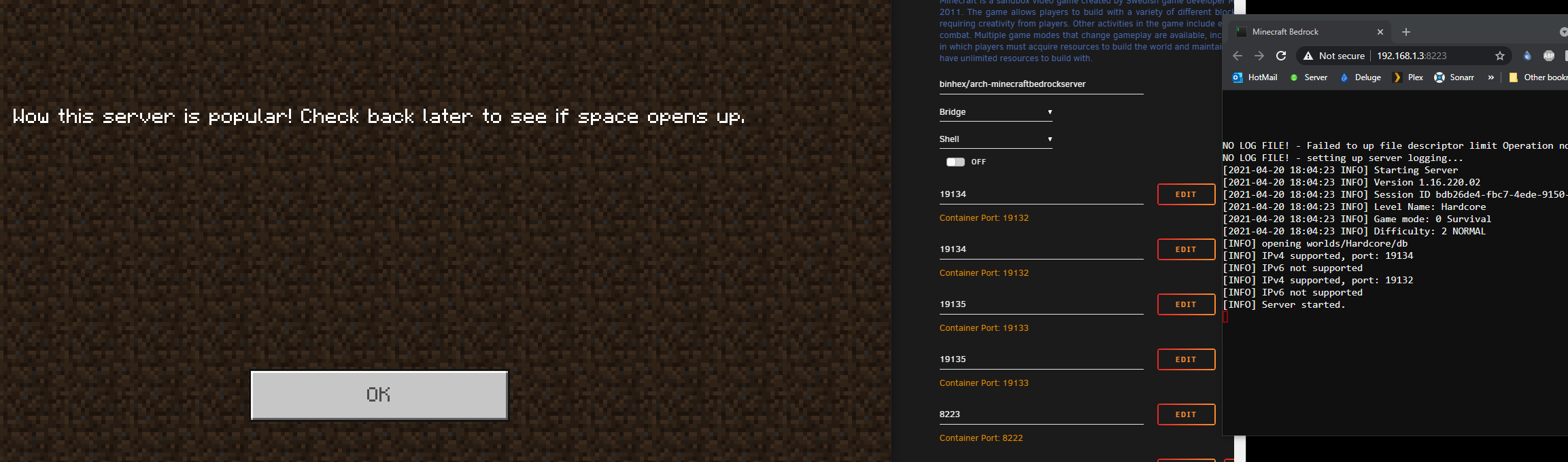

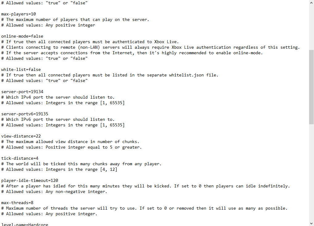

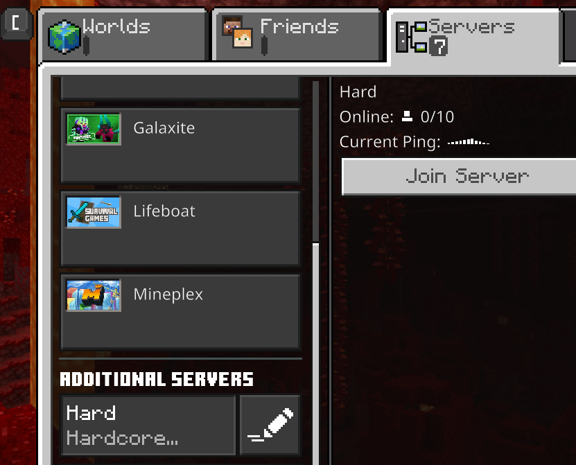

hey all i was wondering who has been able to run a second server.. i can get one running fine but the second one is getting the best of me..
Here is what is happening and my settings i have set
Also this is the only way it will show up is if i manually add the IP in servers
if any one can let me know what im doing wrong this would be great
I have the First server Down but it does show up under friends when i start it.. with all default settings for ports
Edited by i3u5hy
