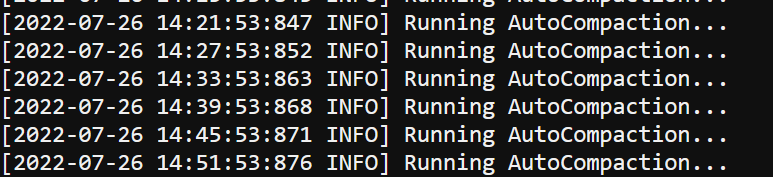

Recently , I have noticed that my unraid server ram is filling up and every time I check, it's the Minecraft bedrock docker using up all the ram I have on the server. Has something recently changed in the docker ? been running this docker for the last 2 years with no issues.
I reboot the docker and it releases about 8 gig of ram.

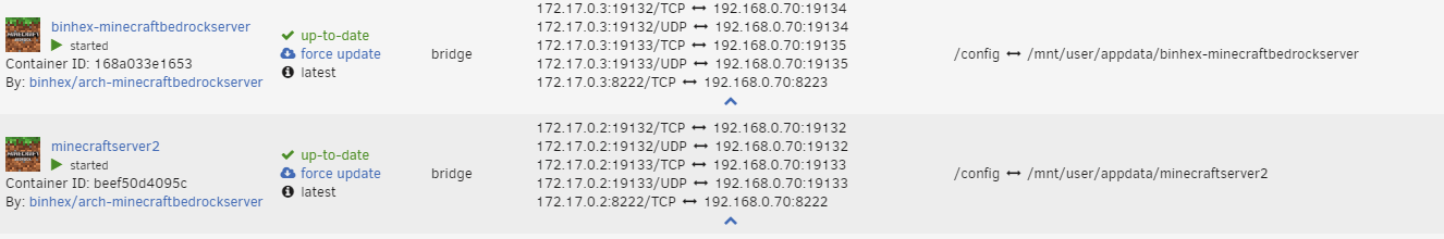

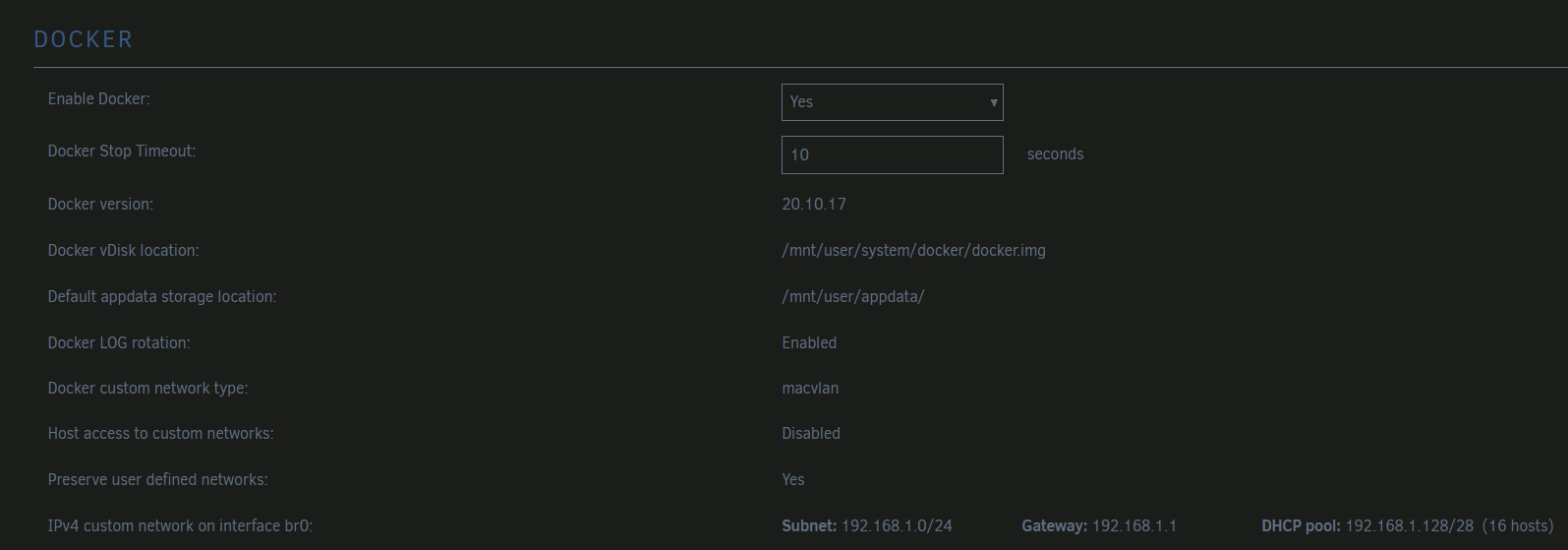

On 7/3/2021 at 10:13 PM, uttles said:
So I have seen multiple posts in this thread that say you're supposed to leave the ports alone  in the server.properties file, and only change the port numbers on the host side.
However, I have done this correctly (according to these posts) and yet I can only "see" one server at a time when I try to join from the "Friends" tab.
Here is my config 210134206_2021-07-0322_04_12-Tower_Docker-Brave.thumb.png.dc0b35e232896cf39cf37a4df4c0c34c.png

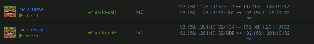

Been a while, but you can get any number of servers visible with a little network juggling.  The main issue is that xbox has no network discovery configuratbility.  It's :19132 or bust.  So each server needs an ip on the network and the :19132 port.
Here's how I have it setup, there's two strategies to getting the ip.  In both situation the router doesn't know about the ip that docker hands out, so I'm thinking static is probably better.

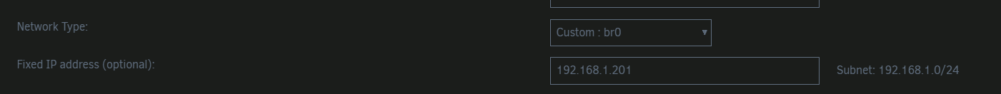

For the first one I setup the docker network to grab an ip range on br0:
Alternatively, you can set an available static ip:

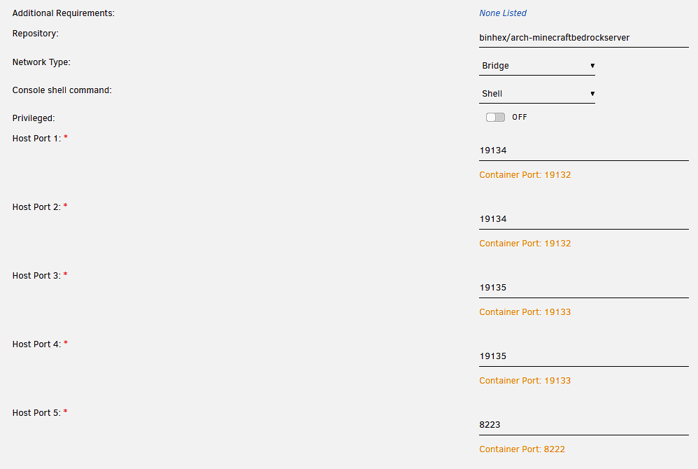

Hi all,
I have recently set up a minecraft bedrock server. Generally erverything is running fine. However I have three friends who can not join through my forwarded domain (Unable to connect to world) (other friends can connect no problem). They can join if they use my real IP but not through my bought domian or my dynDNS (duckdns). Has anybody had simmilar issues. I also don't know if this a problem on their side or on the server side.
If anybody has simmilar issues or a solution that would be great.
Thank you all.
Stitch0815
Edit: Maybe I should mention I changed the ports (see attachment)

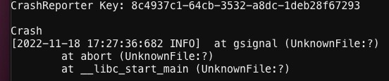

Well some reason my server broke.  When I try to go to the WebUi it says "There is no screen attached matching Minecraft". It is not available locally either.  I forced update and checked my settings.  I am on the latest build of Unraid.  Any ideas?
Edited by Beardiful42
Just turned off Web auth and I get this....
