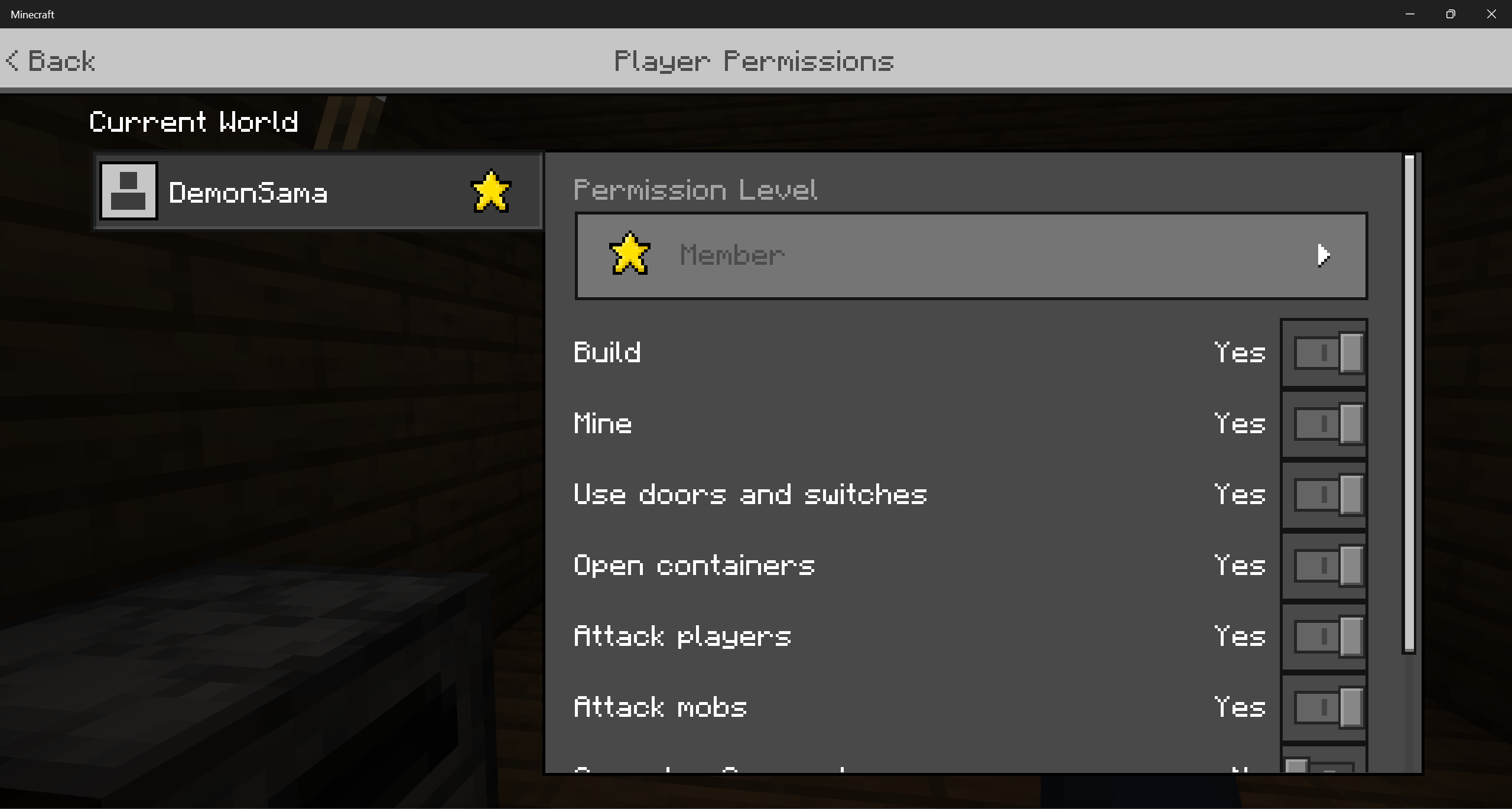

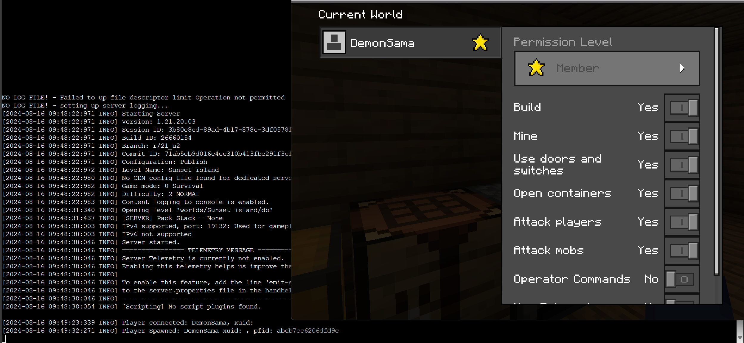

I managed to get it to work and after reading 20+ pages on this thread I have two things I would appreciate your help with.

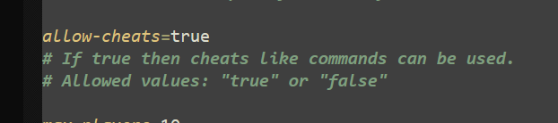

#1 Operator access stopped working out of nowhere (I probably fudged it up trying to get raytracing enabled somehow, more on that later). I still have the permissions file set up like this:
and the server.properities has this flag:

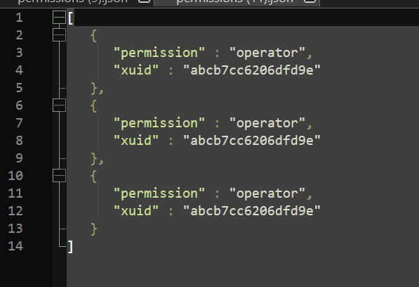

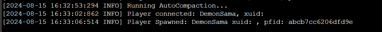

My webui confirms that the xuid I am using is accurate but as you can see below it only shows my access as a member.
I tried deleting the entire docker and all the files left over and reinstalled it. Then I copied the world and the server.properties and permissions.json over so that my world will be restored but that did not fix my permissions.
#2 What is the best way to enable RTX (raytracing) for the server? I tried a few guides but none of them worked for this docker. Is there any guide you suggest? I upgraded my kids computers with 3090's and I wanted them to get to enjoy raytracing with me but we do not want to lose our server and all the hard work we put into it.
All your help is deeply appreciated. Thanks in advance and we really hope you can help us.
Edited by ONI
That all looks fine to me, the only thing that comes to mind is the permissions.json file, check the line endings, you may have to have it set to LF (line feed) not CRLF, i use this image myself and have a minecraft world setup with operators with no issue, so im confident the image is fine.
Sorry i got no idea on this, i would love to run raytracing but i don't have the hardware for it, a quick google search landed me here:-
I use notepad++ so I went to Edit > EOL Conversion and choose Unix (LF). It looks like it was already Unix so I converted it to windows CR-LF to see if that made any changes. That ended up not working so I switched it back to unix LF but the issue still persists.

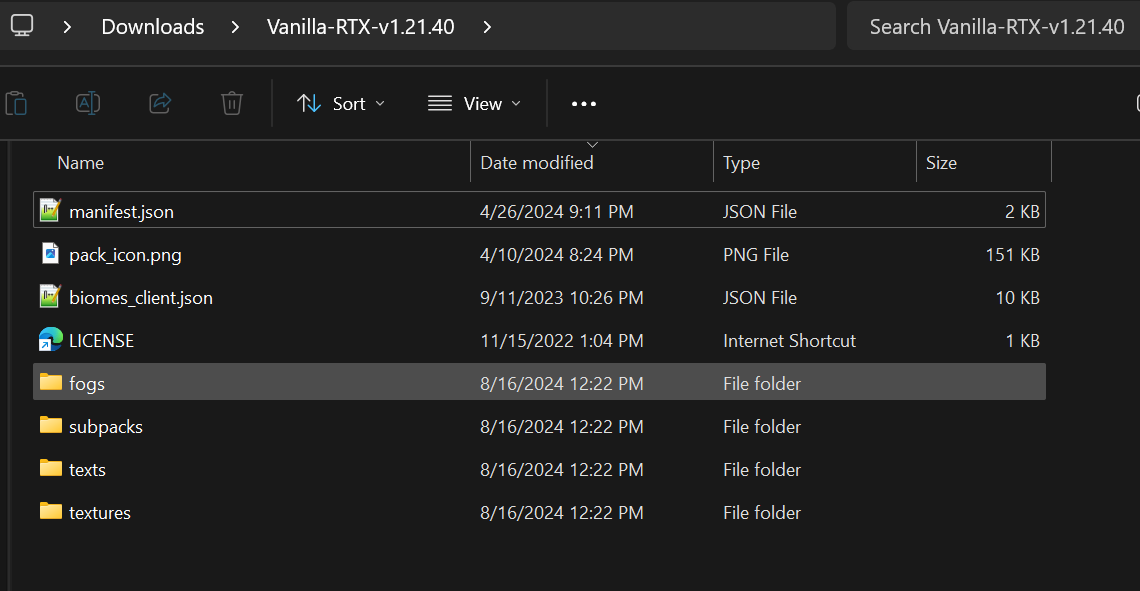

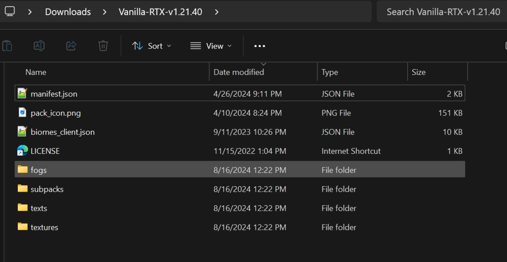

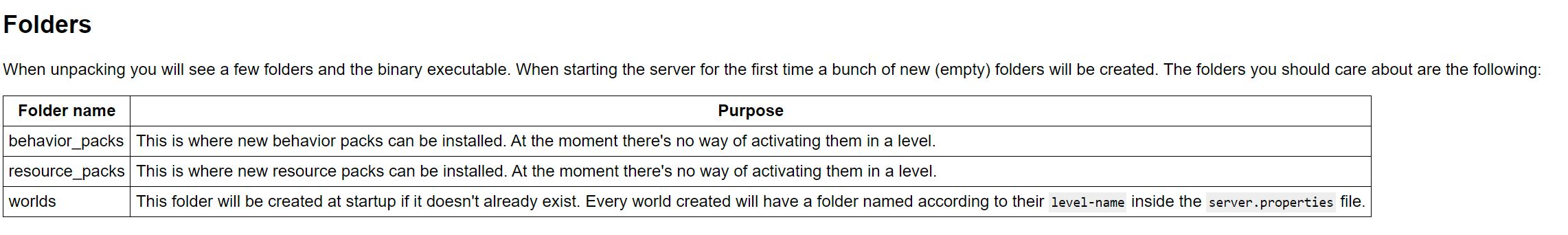

I have tried that and a few others before. My biggest issue is knowing where to drop the files.
So I downloaded the file from this url https://mcpedl.com/truly-vanilla-rtx/#downloads the file itself was the standard .mcpack extension so I renamed it to .zip and extracted the files.
Do I place the files in binhex-minecraftbedrockserver > minecraft > resource_packs or someplace else?
Edited by ONI

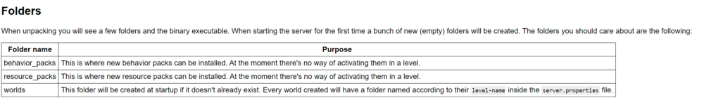

I am not sure how up to date the bedrock_server_how_to.html is but I am worried that enabling rtx or any pack might not work right now:
Edited by ONI
