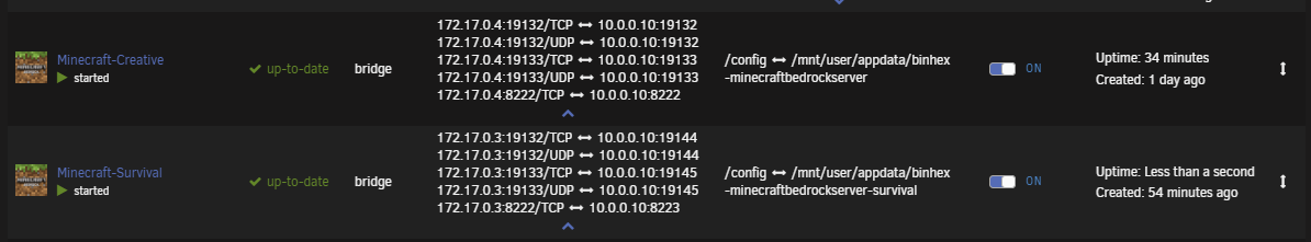

Hi all, I'd love some help in getting two Bedrock servers to run simultaneously. Below is the configuration I have:
The top Creative world is the "default" - it has the normal ports, is visible on the LAN, etc. But the kids want a survival-only world, so I'm trying to set that up now that 1.18 is out.
With the above configuration, on the same home network, in Minecraft under "Play" -> "Friends" tab -> "LAN Games" heading, it shows the Creative server, but not the Survival one. To see the Survival server, I have to click over to the "Servers" tab, click on "Add Server" at the bottom and fill in the details (IP 10.0.0.10, port 19144). Once that's saved, I see the Survival server listed under the "Additional Servers" heading in the "Servers" tab, but it constantly says "Survival - Locating..." on the button. Nevertheless, if I click the button (still in the "Servers" tab) and click "Join server", it connects.
However...! If I go back to the "Friends" tab, I now see both the Creative and the Survival servers, but if I click on the Survival server, I get joined to the Creative server! :S It's not a copy of the Creative server either, but the actual Creative server—any changes such as block placement or player location are "carried over" and shown if I connect directly to the Creative server. Also, if I stop the Creative server's docker container, leaving the Survival server's container running, I can no longer connect to (what should be) the Survival server in the Friends tab.
Any ideas?
Any ideas?
hmm def sounds like the minecraft bedrock client is getting very confused!, i think my recommendation would be to add both servers to the 'Servers' tab and use that to connect and ignore the 'Friends' tab completely, it looks like minecraft bedrock is not really designed for multi LAN servers, it MIGHT work if you were to allocate the servers different IP addresses, but ive not tested that.
How exactly would I do that? I don't see an IP configuration field anywhere...

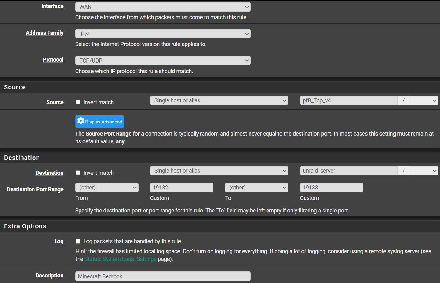

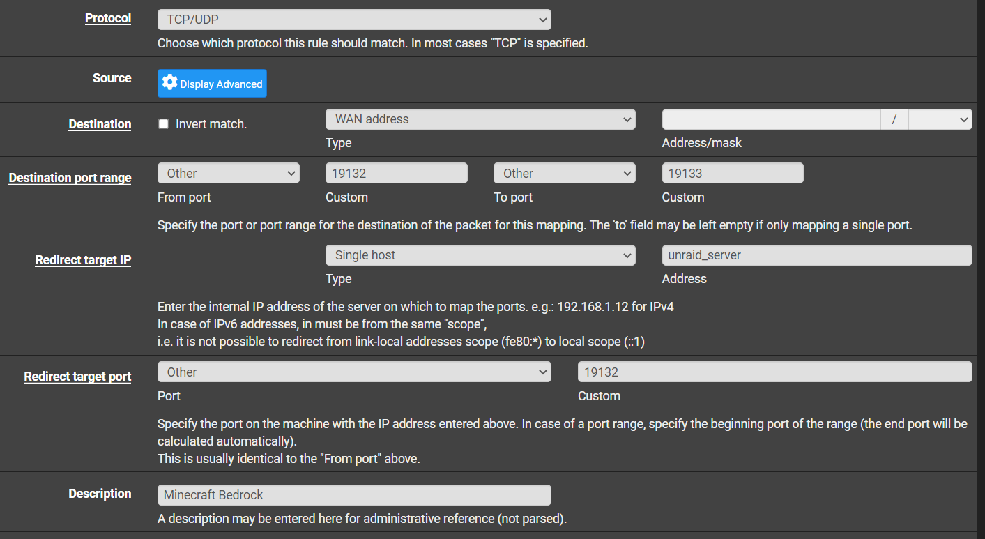

Hey! I might be a bit noobish, but I'm going crazy over this, is there something special I have to do to enable port forwarding to this container? I set it as privileged, and set the router to open port forwarding routes to its adress and port, however when testing it, port seems to be closed while other ports setup the exact same way appear as open! Thanks!
I cant get this to work, I don't understand why I cant access the server once it's running. I'm pretty well versed in port forwarding, and I've tried both bridge, host and a separate br0-network connection.

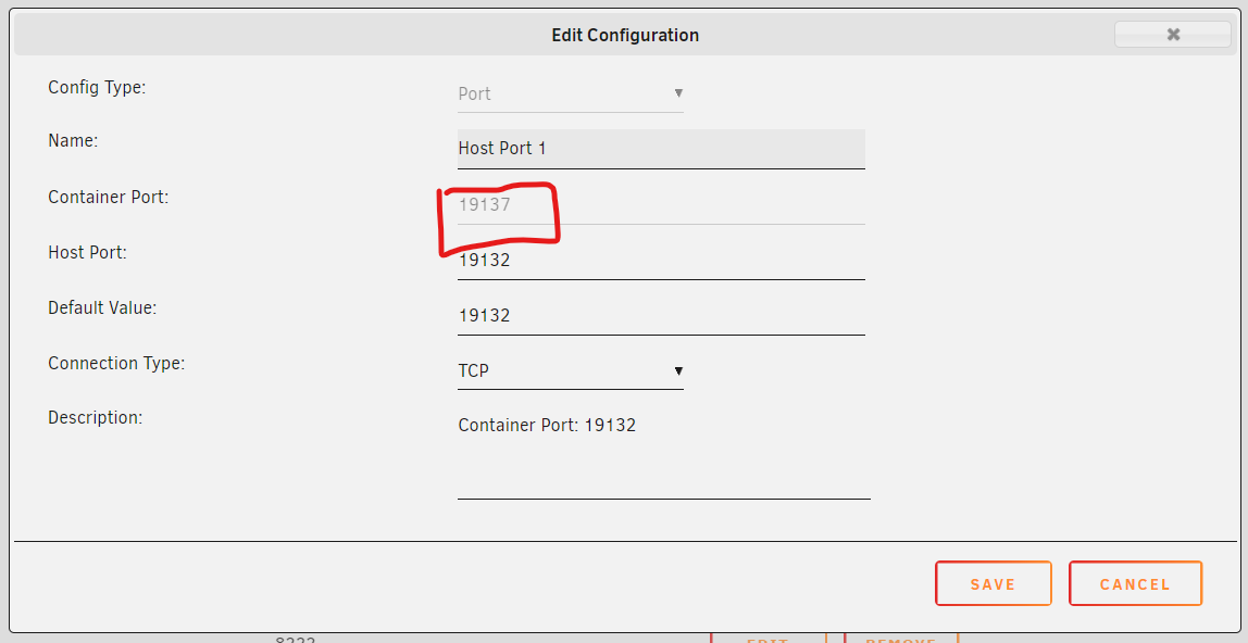

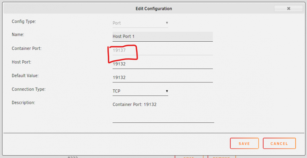

I might be misunderstanding something here, but why is the template set up with port 19137 here? It's the same for the UDP-port.
EDIT: Removed the image and installed fresh from community applications and it's correctly showing 19132 again now. I still cant see the port working on canyouseeme.org though..
Here is my port-forward-rules on my Dream Machine:
Docker-settings:
Edited by Fredrick
I'm still unable to connect to my server, even when just telnet the local port it's timing out.
I'm seeing this in the log, is it usual to have multiple ports listed here? The second one seems random as it's a different one any time i restart the container.
Edited by Fredrick

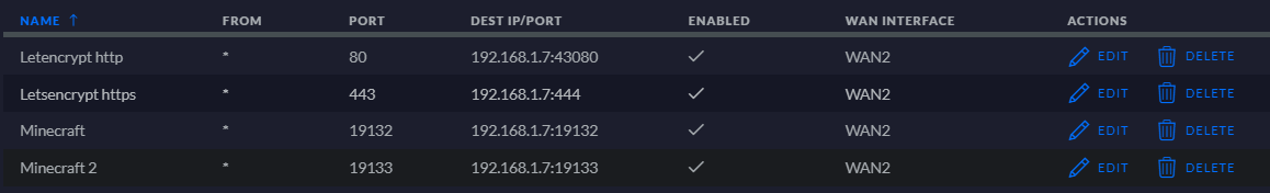

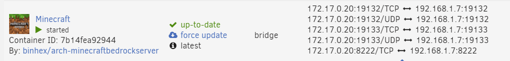

Hi @Fredrick
Did you manage to figured out why PF doesn't work?
@binhex don't you have a clue by any chance what might be wrong with port forwarding?
I do have similar issue: I'm not a big expert in the networking but all other services setup in a similar way (including the VPN server) works perfectly fine, when the only Minecraft server works only via LAN. Even via VPN it is shown as a server is unavailable.
Will be glad if anyone can share all sorts of ideas to test
4 hours ago, Snakesms said:
Hi @Fredrick
i have port forwarding setup for this image myself and can get people to connect external to my home lan, here is a screenshot directly from my router (pfsense), nothing too exciting here, pretty much a standard port forward:-
NAT rule:-
firewall rule:-
Hey - No I didn't. I actually gave up the whole shebang.
