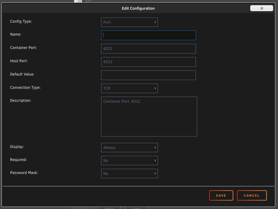

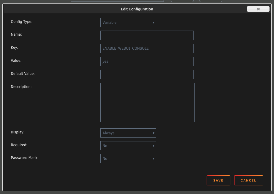

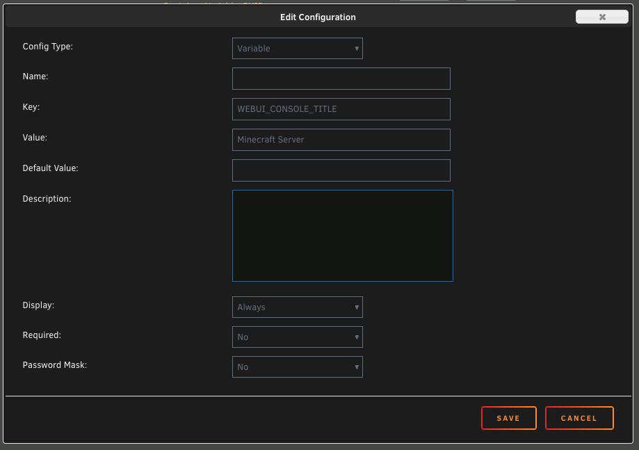

feature is now complete and in the latest image, please pull down and then for existing users you will need to add the following port and env vars:-
OPTIONAL (if not defined it will set to 'yes'):-
OPTIONAL (if not defined it will set to 'Minecraft Server'):-
OPTIONAL (if not set then you wont have a llink to 'web ui' from left click of icon):-
New users will see all of the above already defined in the template.
Access to the minecraft console is then done through http://<host ip address>:8222
I tried modifying my existing container with the port and variables mentioned without luck. Maybe it had something to do with the other WEBUI_ variables?
Regardless, I was able to remove the container and reinstall and it works great! Thanks so much for this console support! Much easier to get to now (added and Organizr tab for it as well).

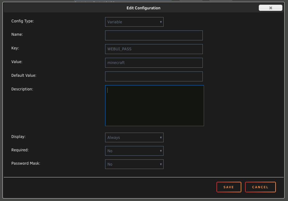

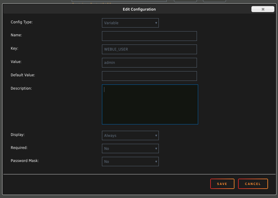

So as i mentioned above i wanted to have the minecraft console secured, at least via basic auth (please dont expose this over the internet!). so i have created a further 3 env vars:-
OPTIONAL - turns authentication on or off (prompts for creds), if not defined then it will be set to 'yes'
OPTIONAL - username for authentication (if enabled), if not set it will set to 'admin'
OPTIONAL - password for authentication (if enabled), if not set it will a random string stored in a file located at '/config/minecraft/security/WEBUI_PASS'
the authentication changes will be in the next image released, in preparation for this you can create the above env vars now, if you do NOT do the above then by default authentication will be turned on and you will be prompted to login with username 'admin' and a random password as detailed above.
