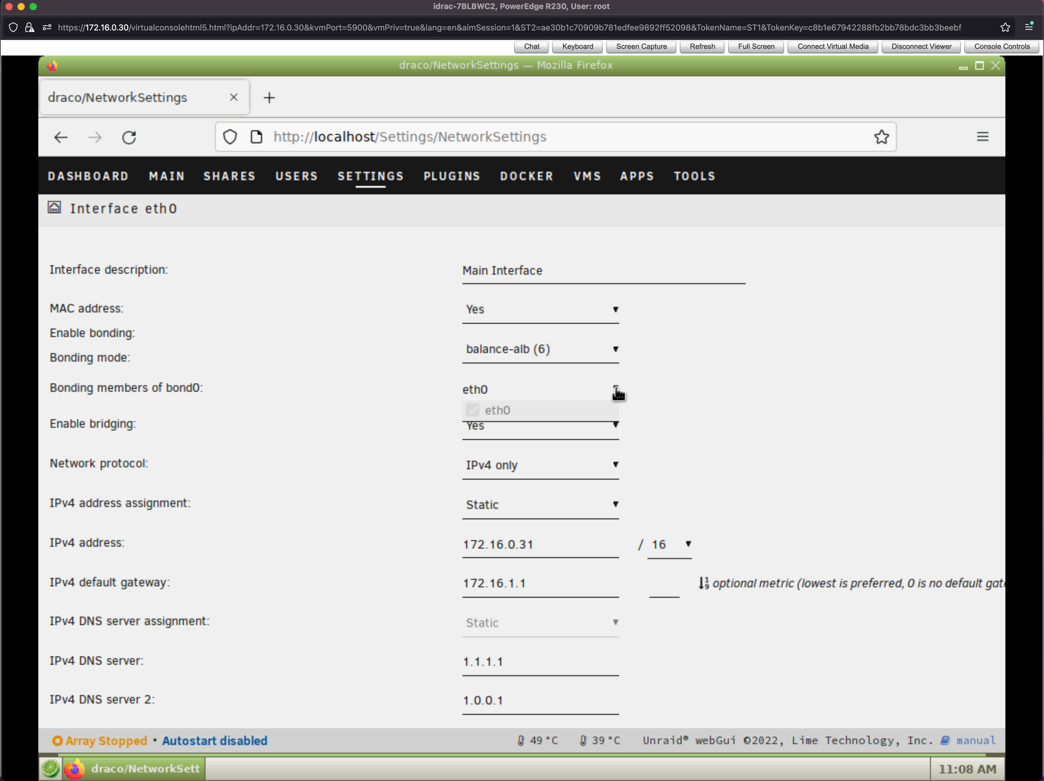

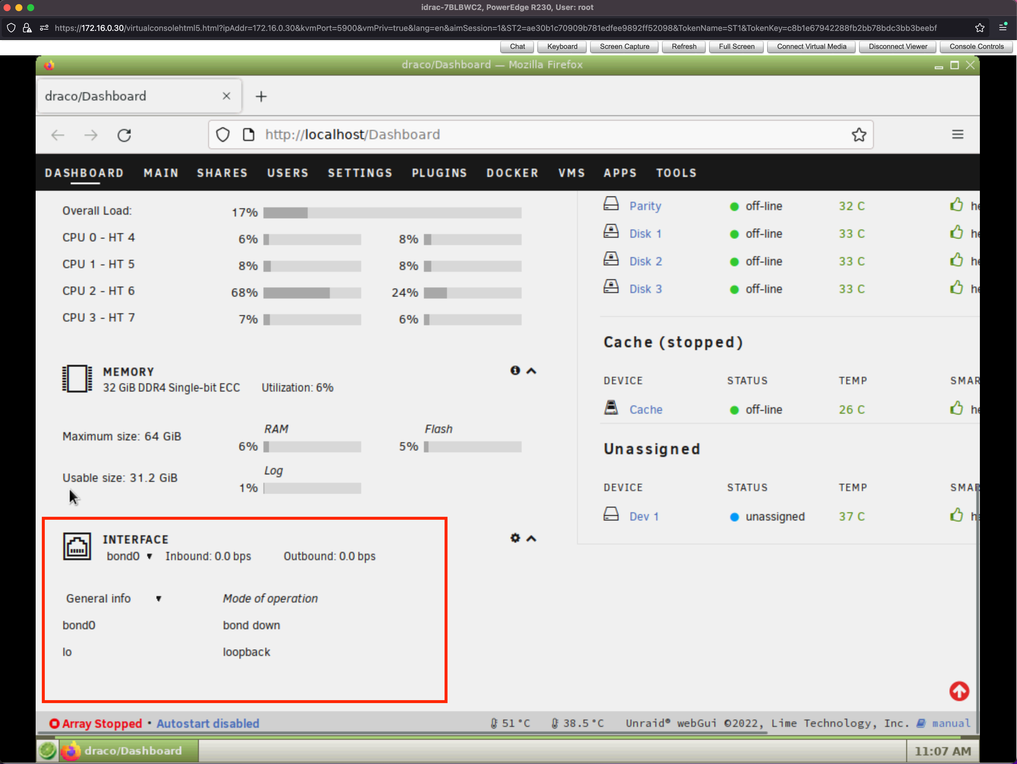

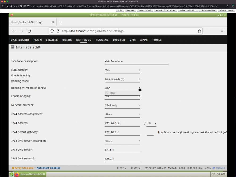

4 minutes ago, eltonk said:
THIS UPDATE IS NOT GOOD!!!! STOP! DO NOT UPDATE!!!
not good?did you read the first post/changelog before update?
It seems you have an issue with your caps lock.
3 minutes ago, eltonk said:
HOW DO I ROLLBACK THIS UPDATE??!?!?
Download the zip package from unraid site and overwrite bz... files on your usb.

You didn't attach diagnostics, you attached 2 screenshots that say nothing more than your network doesn't work.
Read the first post, it has description and fixes for tg3 drivers.
