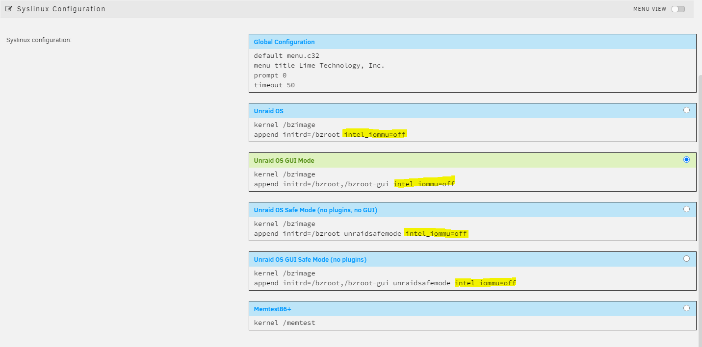

22 hours ago, JorgeB said:
Yes, if you don't need hardware pass-through you can just disable IOMMU by adding 'intel_iommu=off to syslinux.cfg, and you can still use the VMs.
Just to confirm this worked a treat. It cost me a few hours messing around with the server though but I appreciate the decision to disable rather than corrupt! Definitely should have been made much clearer in my opinion though...
Note: to be safe you should add that to all "boot modes" indicated on Main/Flash page, in case you ever need to switch boot modes.   This is an easy thing to forget.

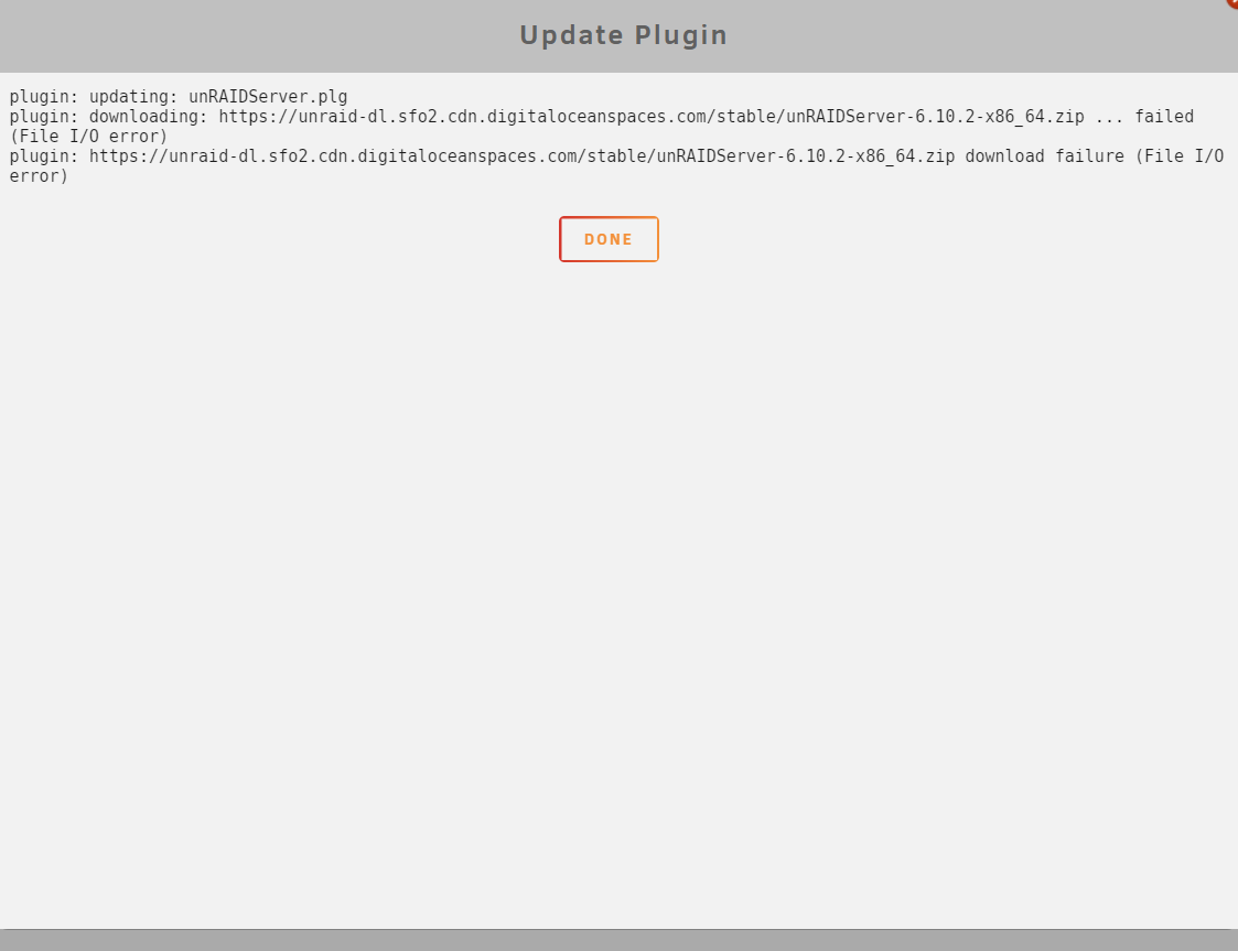

Doing everything to update as in the first post of this thread. But - right after getting to 30% of download - it always sticks with this error.. No matter what i do, change DNS, try to download the file manually(which works fine) - i always get this error in UNRAID. Any ideas how to fix it? No anomalies in the log file.
21 minutes ago, itimpi said:
How much RAM do you have?
Only 2GB, it's an old Asustor NAS with soldered-on RAM chips, no possible way to upgrade RAM size
2 hours ago, [email protected] said:
Only 2GB
You may be able to manually update by extracting the new files onto the flash drive manually, but I wouldn't count on being able to use only 2GB for very much longer.
That is definitely not enough to be able to upgrade vis the GUI.   You can follow the procedure here to do the upgrade manually.
