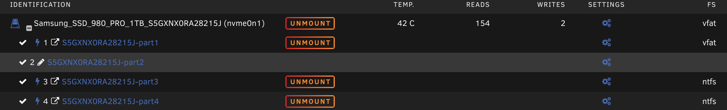

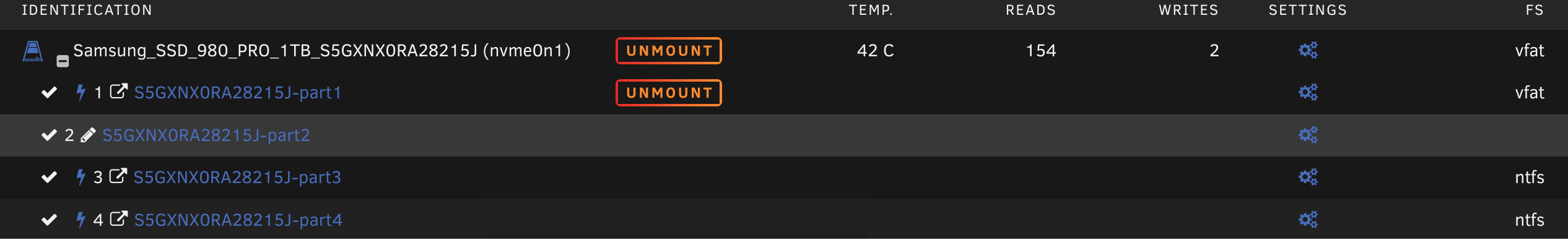

  1. will do! I booted this morning from power on, drives all mounted and VM started automatically thanks again...
  2. You got it! I rebooted twice to make sure and both times all the partitions on the nvme mounted automatically. I run some more tests tomorrow from cold boot as well but hopefully its now fixed! Thank you for the fix and your awesome addon!!
  3. There you go. Diags attached thanks for looking :) core-diagnostics-20230208-1422.zip
