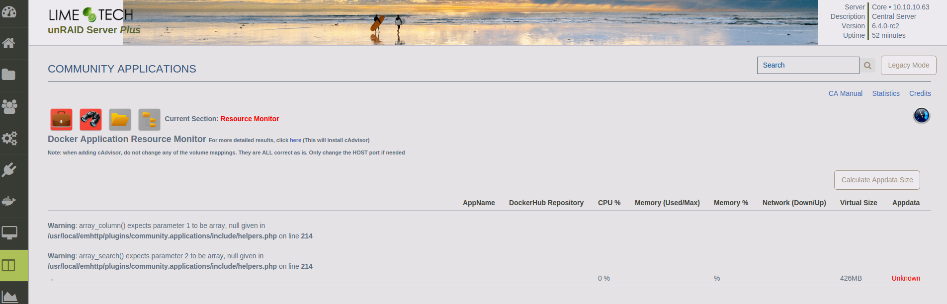

  19. Resource monitor not working in 6.4.rc2 chrome on ubuntu 16.04Lts
