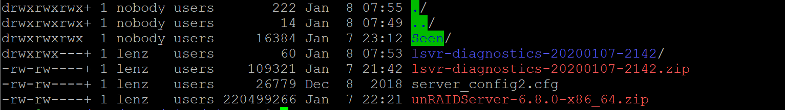

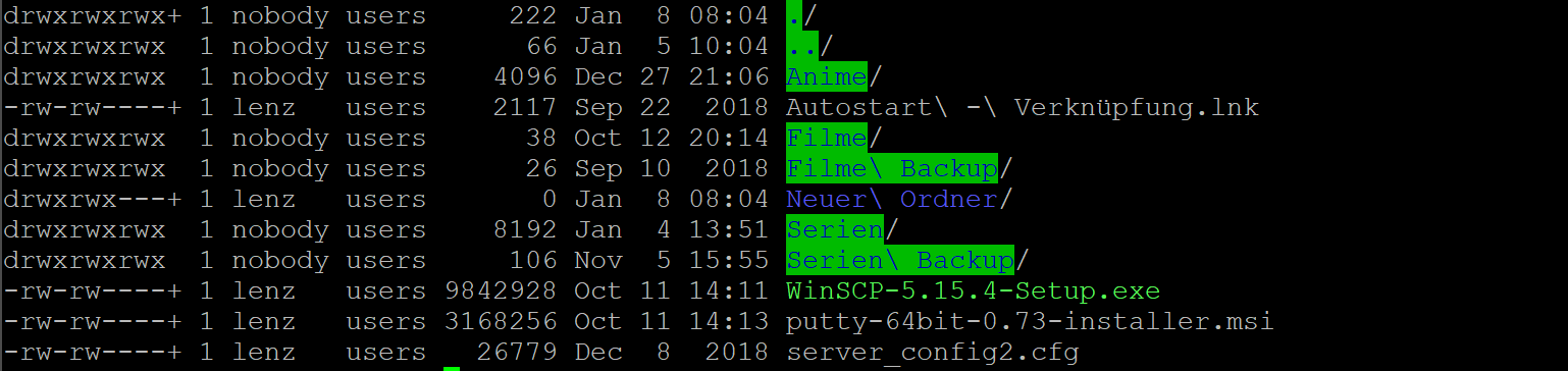

since a couple of weeks i have problems with file permissions in unraid when adding new files and folders over the network. Sadly i am out of ideas how to solve the issue, but i am guessing that files and folders get the wrong permissions from samba. I add some screenshots and the diagnostics file, if more information is required please let me know.
When i use the "New Permissions" Tool, or do a chmod -R 777 on the share i used i can access the share or the lower folder again. Sometimes the same permissions dont seem to block access and sometimes they do...

Is this a Public share?
Why do you have this in SMB Extras?
[Root]
path = /mnt/user
comment =
browseable = yes
valid users = lenz
write list = lenz
vfs objects =
#unassigned_devices_start
#Unassigned devices share includes
   include = /tmp/unassigned.devices/smb-settings.conf
#unassigned_devices_end
I am just moving a lot of files between shares, so that is just faster and easier then using midnight commander in console for example...
And this solution worked for me for about a year without any problems at all. And no as far as i understand it, its a secured share for my personal user. I followed Spaceinvader Ones tutorial for that.
The problem itself also shows itself when i use the specific share...
Edited by Lenz
This probably relates to the recent Samba update that changed quite a bit with regards to security. I also noticed permission changes.
I don't think there's much that can be done.
If you need the insecure workaround then you probably have no choice but to stay on an earlier version that the workaround still worked.
Otherwise you need to rethink the workaround.

@testdasi ok, but even if i dont use the "root" share, i still have the file/folder permission problem when i am using my regular shares...
also do you have further information about that samba change? and if it would be a general samba problem wouldnt that result in all people who are accessing thier unraid 6.8.0 servers from windows 10 (and i tried a rollback to 6.7.2 with the problem persisting, were i didnt had problems before at all)? because when i access my "\\server\Media" share i still have the wrong permissions. also what would be proper file/folder permissions as unraid is intended to work (nobody:users with folder 777 and files with 666?)
