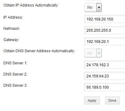

I didn't realize resolv.conf was rewritten on boot.  it's been there every time I've ever looked.  when I change the DNS settings to use the 3 IP addresses, the file does get updated, I just checked.

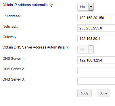

change made, rebooting now...

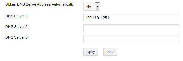

first screenshot is before reboot.  second is after :(
***I just changed the DNS settings, and this time it did save successfully.  i.e. the warning error I reported earlier did not happen.  it saved, and came back to a fully functioning screen that would allow me to make more changes.  Might be a clue??
I think I may have figured this out.  In another thread, Tom asked me to make a change to the go file.  it's been at least 2 years since I've touched this go file, so when I opened it to make the change, I noticed this line...
echo nameserver 192.168.1.254 >/etc/resolv.conf
I assume this is what is causing my issues.  I'm removing that line and will reboot, and report back if I still have any issues.
