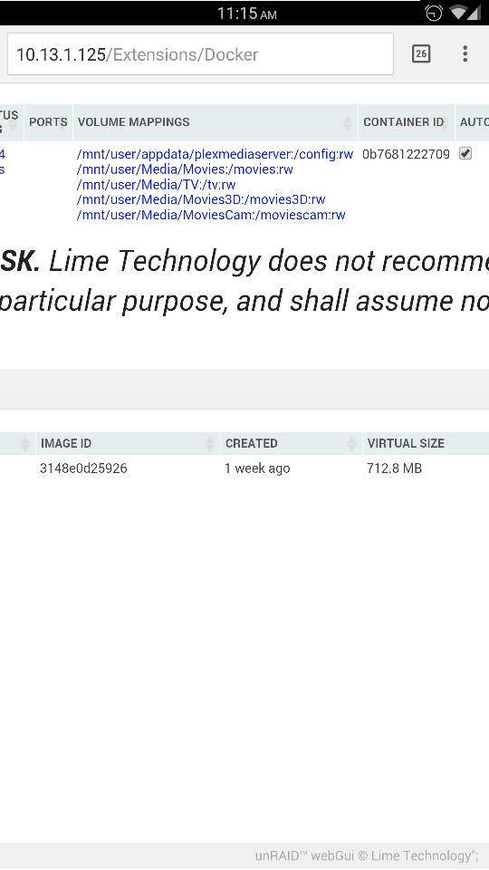

September 23, 201412 yr Hello, Just wondering if anyone else has faced this issue. It really only happens with large Movies, 1080, DTS, but Plex Docker seems to load really slow. Also, I cannot resume some of these movies where I left off. I also cannot forward ahead. It just sits there and spins and then eventually says there was a problem playing this movie. However, if I just choose to start the movie from the beginning, it takes about 5 seconds and starts playing normally. Anyway to grab a log or figure out what's going on? Or is this a known issue? Never had this type of issue running a Xen VM before. Just wondering if docker can't handle the load? Is there a way to check my CPU load in unRAID while this is going on? I'm on the latest Plex Docker, beta 10a, and Docker is on my SSD Cache Drive. It also doesn't make a difference playing on my chromecast, phone, or computer. All results are the same. Thanks

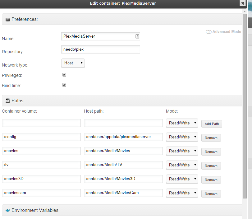

September 23, 201412 yr Author What did you enter as your :config directory when setting up Plex dpcker? Hope this helps
September 23, 201412 yr I would think you :/config directory is on your array and not on your cache. I have used mnt/user/cache/appdata and set to cache only in the shares. Yours is /mnt/cache/appdata I initially did the same and plex performance was sluggish plus stop start. I presume it's slow due to having to spin up disks and perhaps limited space for transcoding directory
September 23, 201412 yr Check your array disks first and see if the appdata folder is on one of your array disks and also check the share setting on the appdata folder before you do anything to confirm that is the case
September 23, 201412 yr Author Check your array disks first and see if the appdata folder is on one of your array disks and also check the share setting on the appdata folder before you do anything to confirm that is the case OK, I found appdata folder on disk1 and disk5. The share setting is also not set to use the cache disk. If I change it to only cache, will it fix itself? Thanks
September 23, 201412 yr I don't think it will move the files for you. Setting to cache only will just stop it from being moved from the cache to the array. I would manually move the files to mnt/user/cache/appdata, correct the docker setting and set that share to cache only.
September 23, 201412 yr Author My docker setting is already: /mnt/user/appdata is there something else that you're referring to?
September 23, 201412 yr Author Missing the cache Mnt/user/cache/appdata/plexmediaserver Ok I changed to that, and it broke it. Won't load the Plex page with those settings. Anyways, while I was at it, I created a new directory. /mnt/user/cache/appdata/plexmediaserver2 Readded some of my libraries, but still the same result. Cannot resume larger movies, and I cannot seek forward in the film either. Just times out. Again, in the smaller movie files, there's no issue, I can skip forward as much as I'd like EDIT: Upon further review, it's not necessarily the size of the file. I just skipped ahead in some larger files, but there are still a few that I cannot. Any thoughts? Could it be an encoding issue?
September 23, 201412 yr Did you copy your appdata files from the array to the cache? And set the share to cache only? Shouldn't be an encoding issue, plex will only choke if there is not enough space for the temporary transcoding of files. Is there enough free space on your ssd? Have you specified the temporary transcoding location within plex settings?
September 23, 201412 yr Author Did you copy your appdata files from the array to the cache? And set the share to cache only? Shouldn't be an encoding issue, plex will only choke if there is not enough space for the temporary transcoding of files. Is there enough free space on your ssd? Have you specified the temporary transcoding location within plex settings? I did copy them. I have 232GB free on my SSD But I also created a new folder on a new library. Same thing. I've set the share to cache only. Can I just set the temp folder to /mnt/user/cache/appdata Like I said, only a few 14gb + files do this. But not all. I have everything set to direct play
