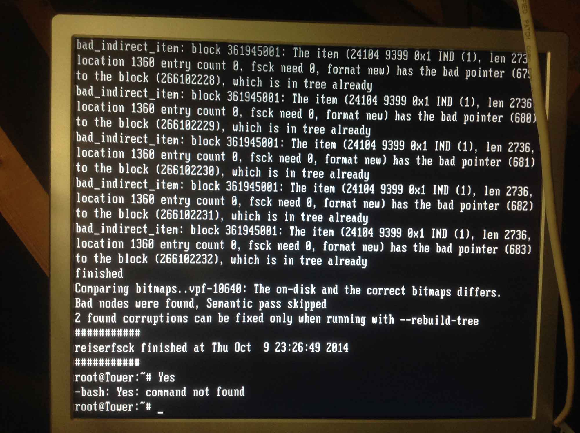

I've run the fsck check a couple of times.  The first time, though, the telnet the connection was closed by the server and the results never displayed, and the second time via the terminal.  I attach the final screenshot.  Does that give enough information?  It does refer to two items which can only be fixed when running with --rebuild-tree.
It also refers to putting the fsck log into 'stdout'.  Where would I find that, I wonder?  Alternatively, how do I prevent the server from closing the telnet connection?  Probably simple questions but that is what I am  ::)

What was the exact command that you typed?
Hi dgaschk
reiserfsck --check /dev/md4
