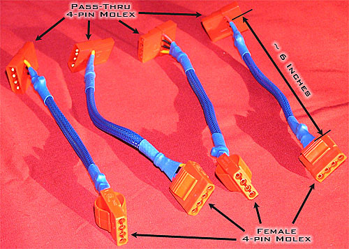

Ran out of 4 pin connectors on my PSU. Can I use passthroughs?
My question is can a double 4 pin be expanded using the passthroughs in the photo to support 8 hard drives? They currently are powering 4 drives of various size and speed.
PSU - SeaSonic SS-750KM3 750W (http://www.newegg.com/Product/Product.aspx?Item=N82E16817151087)
Case - NORCO RPC-4020 4U Rackmount Server Chassis w/ 20 Hot-swappable SATA/SAS Drive Bays (http://www.newegg.com/Product/Product.aspx?Item=N82E16811219021)
Passthrough - Came from a Hiper PSU.
Sure, there's no problem with that.  Your PSU has a single 62a 12v rail, which is plenty for your needs.    I'd spread the distribution among the available cables from the PSU, as you don't want to pull all the amperage from a single cable run (THAT would likely overload the cable).
