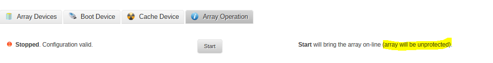

EDIT: Bouncing between Dynamix and unMenu... I've got the following screenshot from Dynamix stating that the array will be unprotected if I start it.  Why would that be - all my drives are assigned properly, including parity.

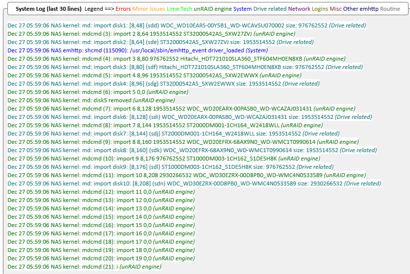

OK, 18 hours (and a movie at the theater) later, it's finished the preclear. I reassigned the drive to the array & started it, but it's still showing red.
Syslog attached. Oddly, it seems to end in the middle of a line at 05:59 today. Current time is 19:55 EST. Not sure what's up with that...

Show a screenshot of unRAID main. Does the syslog continue?
Great question - unfortunately, it stops then, too...

That's just a 2 minute piece of the syslog, abrupt start and abrupt end.  Looks to me as if the system crashed at least partly, and the syslog agent is no longer running.
That 2 minute piece does not show Disk 5 was ever assigned.  Since something has gone seriously wrong, I'm not sure you can trust a red ball indication.  I *think* it should be blue(?) to indicate a new drive, and then after clicking the Start Array button, offer to rebuild Disk 5.  If not, and that formatted disk may have confused the state of Disk 5, then you may want to unassign the parity disk, add the new Disk 5 and let it be formatted (should be quick), then stop and re-assign the parity drive and let parity be rebuilt, all past Disk 5 bits forgotten forever.
