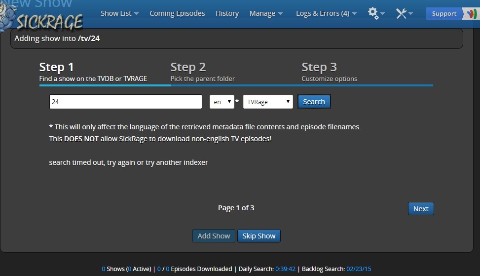

I got the UI up and running but I can't add shows.
Even when I add existing shows, search times out with both indexers.
