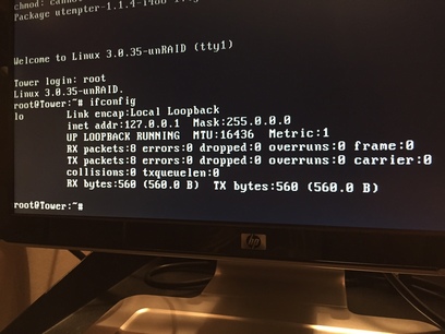

I started up the new system with the USB I had always used and it seemed to start up fine. I used ifconfig to get my IP addy, but it didn't list one.
Attached is a picture.
What can I do to fix this?

Have you tried the other LAN ports?  I believe that board has 2 LAN ports and an IPMI port.    unRAID will only use one of the LAN ports and I believe that you need another connection to the router if you want to use the IPMI port.

I tried the other LAN ports and also the IPMI port. I tried different ethernet cables. I tried going from my router and then from my switch. Frustratingly, none of these worked. I looked in my BIOS if there was anything disabled, but I didn't see anything that stuck out.

If v5, then (using a different flash drive) load a copy of the latest v6 Beta and see if it works okay.  I seem to recall there was an issue with NIC support for that board at some point, so it may be that you're using a version that doesn't support the onboard NICs.
If that's the case, you can probably get a driver for your version, but first confirm that it's okay with v6B12
