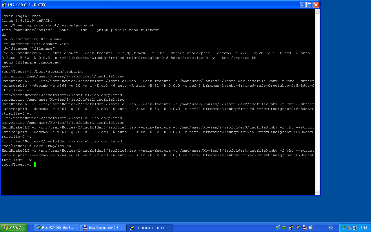

Hi Joe L.,
Still from abroad, but I had some time and connection to try it out, and now I am even more confused.
It seems that this way, not only the handbrake command for the first ISO gets written to /tmp/iso_hb (as I would expect from the above), but for the last ISO. For me it doesn't make any sense and I feel really like a dumb, but please see the attached screenshot. The script lists all the 3 iso files I have in that test dir, but it only writes the handbrake command for the last to /tmp/hb_iso
I hope everyrhing will be visible on the screenshot.
Hi Joe L.,
my fault.  You would need to use
tee -a /tmp/iso_hb
adding the "-a" option to have it append to the same file each time it is invoked, otherwise, it overwrites the file each time.
That is why you only see the last file processed.
But then, if you run it again, you'll either need to delete the first file contents or you'll see them too with the subsequent runs of handbrake appended.
That was it Joe L.! Thank you very much! It works perfectly this way. :)
