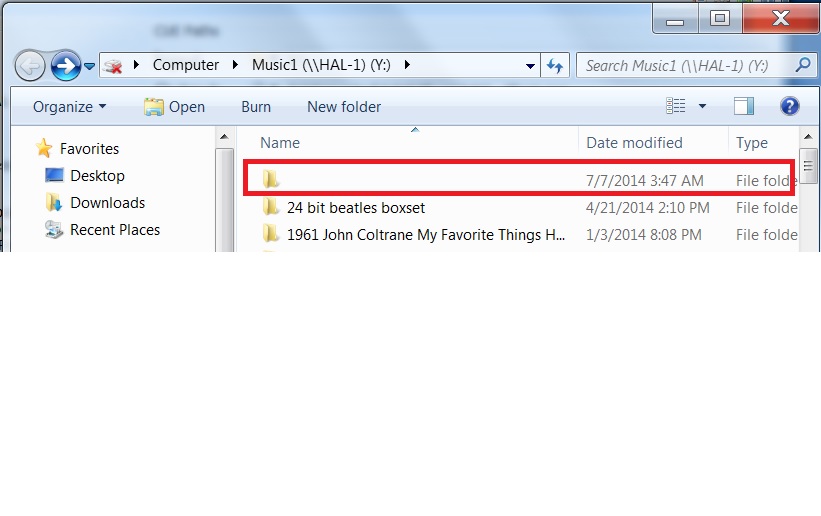

I see several several unnamed folders in the shares on my server, like shown in the picture.
The contents of this folder is the same as the previous. These folders are nested numerous times.
I don't have an explanation for this, maybe one of you guys can enlighten me.
The only changes that were made to the server are conversion of ReiserFS to XFS and installing cache_dirs. Running 6 beta10a.
Can these folders just be deleted?

No they are not real, which is why I said it must be a quirk of SMB. The folders do not actually exist in unRAID. I only see this in my Torrents folder, which has about 3000 subfolders. I had this on unRAID 5 also. Trying to open one of these unnamed subfolders in Windows Explorer doesn't go anywhere. Windows Explorer stays in the parent folder.

They are a real folder, but the folder name has a character in it which is giving windows a brain fart
If you rename the offending folder either via the command line or via mc and remove the offending character, windows will then be able to see it properly.

Thanks. Fixed it for me. Don't know why I didn't think of that.

But the folder has no name, like I said in the OP.

Navigate to that folder's parent directory (/../mnt/user/Music1) with mc at the console, and look for a folder with messed up characters in it.  Rename it.  You can't do this from windows.  Only from the console with mc.
One of your torrents or NZB's had an invalid character in its name
The way I was able to identify mine in mc was sorting by timestamp. The timestamp Windows was displaying for the "unnamed" folder was in fact the actual timestamp of the folder as viewed in mc. I might never have bothered to look through 3000 folders otherwise.

BTW, I wouldn't delete that folder through windows.  Since windows cannot make heads or tails of what's going on due to the invalid character, I'd hate to see what might happen if you try and delete it through windows before fixing the issue.

Thanks, you are right.
