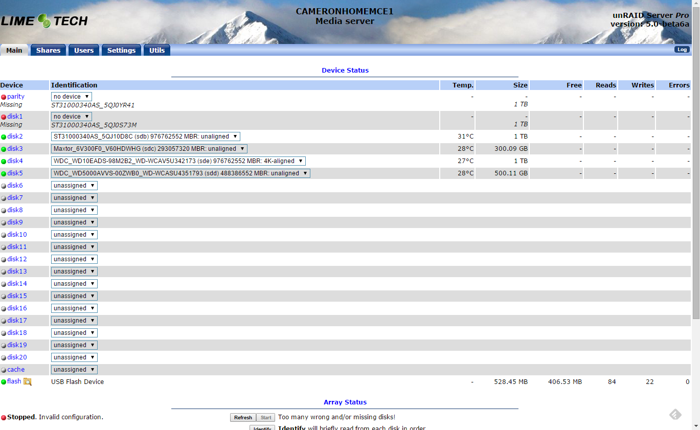

I had to move my unraid box to the basement. It had shut down without spinning down the disks. Also, before I could hook it back up my son accidentally knocked it over. I'm not sure if this caused issues or not but wanted to mention it. I also had to take out the USB and update the network.cfg because I had to get a new router. When first booting up after all that, I'm getting "parity missing. no Device." and "disk 1 missing. no device. (see attached screen shot). I took off the side panel and made sure everything was connected, and it was. I also slide out all of the drives and re-mounted them to make sure they were all solid.

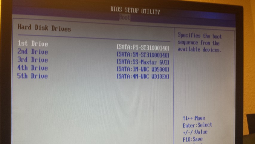

If you have a keyboard monitor attached, then I would suggest that you go into the BIOS settings and see of the disks are being seen at that level (if not then unRAID will never see them either).  If they are not being seen then you really want to check all the cabling again as that is something that is easily rectified if it is the issue.  If they are being seen then the issue is something else.

So it looks as though the BIOS is seeing the drives just fine (see attached). Does that mean it's something with unraid?

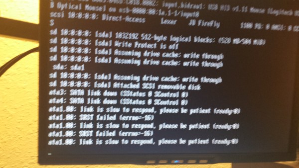

[update] - I continued to try and boot into unRAID and during the boot process it received some interesting errors, see 2nd attached image (apologies for poor quality). It did however, make it all the way to the login. Any ideas?
Attach anew syslog and a screenshot of unRAID main.
