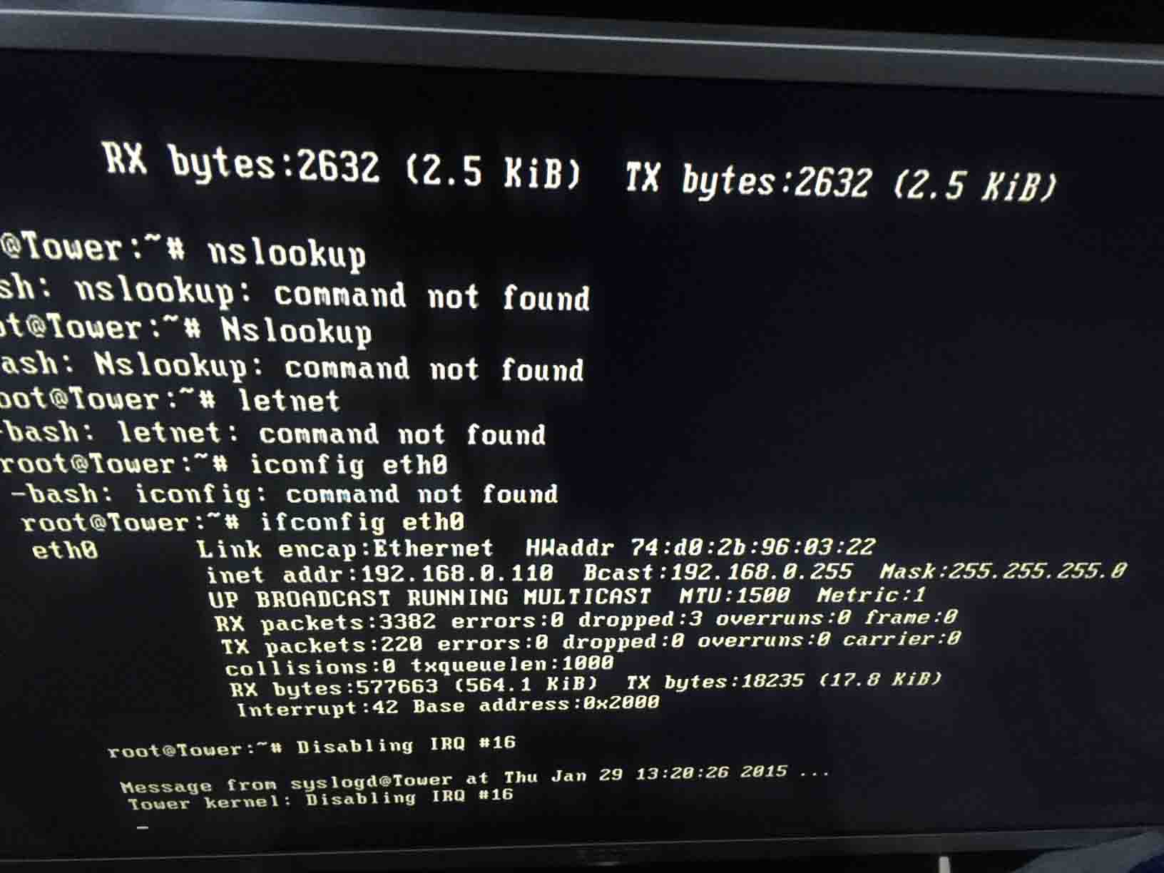

What do you get with
ifconfig
and
ethtool eth0
I have attached a pic of what appears when I type the code.
I have tried using the 'inet addr' ip address but I have had no success.

The unRAID server is on the IP network 192.168.0.xxx while your current PC is on network 192.168.1.xxx which is why they cannot connect to each other.
Probably the easiest way to fix this is to edit the file network.cfg in the config folder on the USB drive to the network settings you want.
Your unRAID is on a different subnet 192.168.0.x instead of 192.168.1.x like your Mac.
You can edit the IP address on your flash drive. It is network.cfg in the config folder.

Shall I just change the ip address from 192.168.0.110 to 192.168.1.110?
Thanks
For example, the Mac I am currently using has the ip address 192.168.1.101
There's your problem. Change your server to use 192.168.1.110 instead of 192.168.0.110
Thanks
That would work and would allow you to access the unRAID GUI.  However you probably also want to change the DNS and Gateway settings to also be on the 192.168.1 network.  Ideally you should check what settings your Mac is using for these and set the unRAID server to be the same.  Normally these would be the address of your router.
