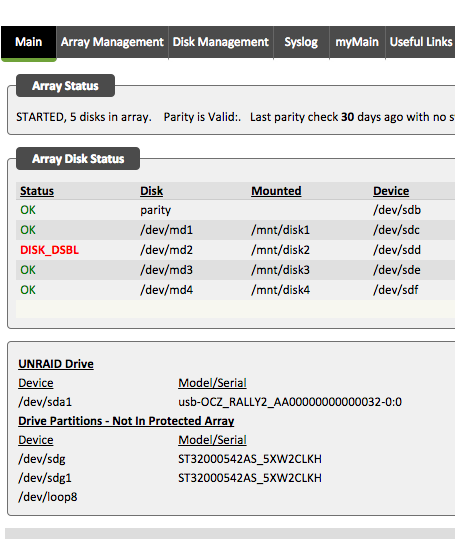

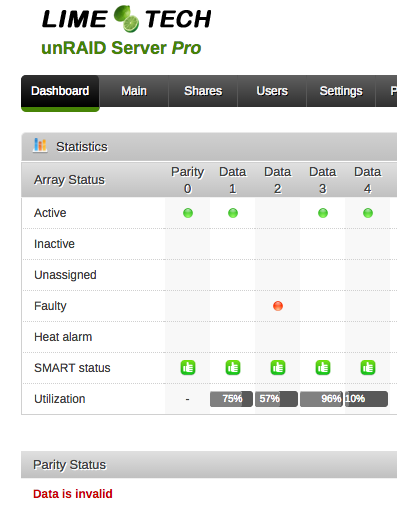

Disk 2 (sdd) is showing red ball
Main dashboard photo attached.
unMenu page attached.  Appears the disk was disabled for some reason?
Attach a smart report for (sdd) WDC_WD30EFRX-68EUZN0_WD-WCC4NJPSF9CK
unRAID disables a disk when a write fails. Do you have a replacement disk? The usual advice is to rebuild on another disk, and then determine if the problems with that disk can be resolved.
