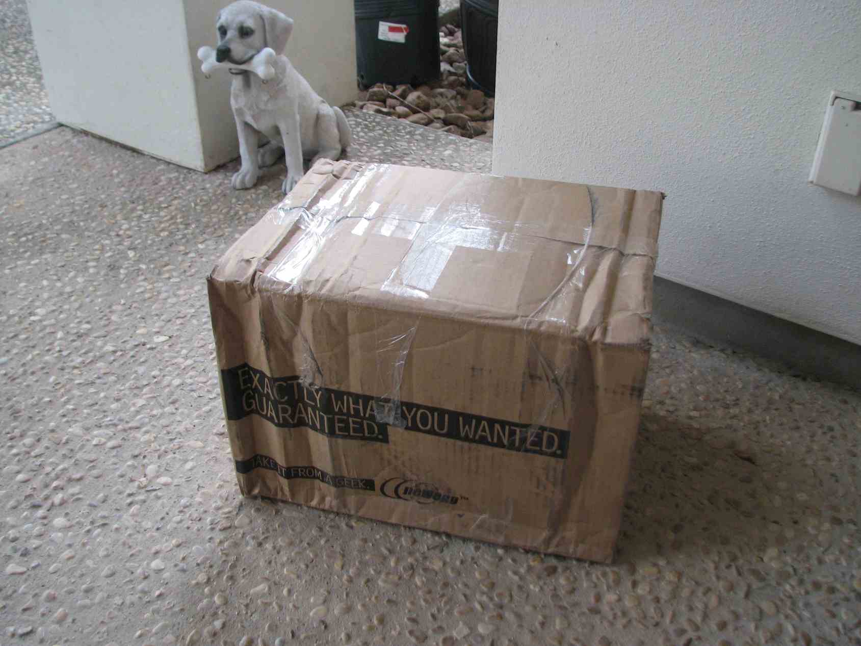

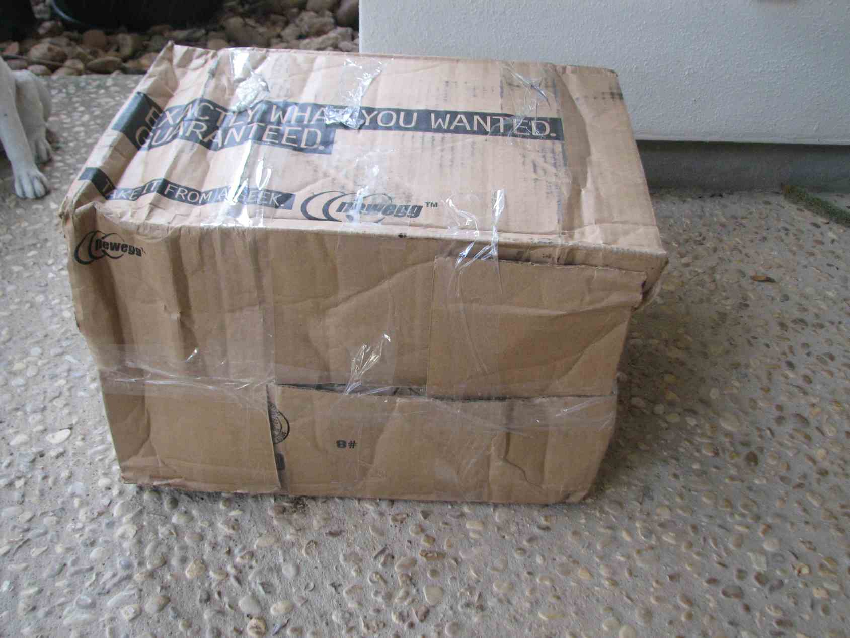

I don't buy WD Reds for price reasons ... I've been buying them since they were first released, when a 4TB unit was ~ $250.    But they've been exceptionally reliable => in fact, I've never had a failure except for the initial testing of some drives that were in a VERY poorly packed box of drives I received from Newegg  [see picture below].    I prefer them over the HGST's simply because they run notably cooler, thanks to their slower rotation.  I don't think the 7200rpm speed of the HGST's is needed in a NAS environment, so I'd rather have the cooler, lower-power Reds.

This was the box of drives I got a couple years ago that had about half a dozen WD Reds in it ... ONE of those drives failed my initial testing, so I had it replaced.    The other 5 from that shipment ... along with all the others I've purchased before and after that (a couple dozen) are all still working perfectly, with zero reallocated sectors; zero pendings; etc.    I took the pictures from my front entryway, where UPS left the box exactly as you can see it.    I don't consider a failed drive in that box the fault of WD  :) :)
I had a similar delivery this weekend from UPS who handed off to USPS for final dropoff. Surprised the drive actually passed 2 preclears without issues. (only 1 drive in the entire box -- bare drive in plastic eggshell with some bubble wrap in the box).
I think ill be picking up the rest of my drives in person now. Especially since best buy will pricematch amazon and newegg. Even if its an extra $10, thats easier than drive failure down the line
