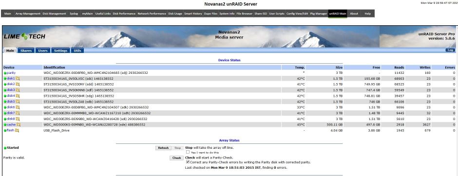

Forgot the main screen capture

Now I have a second drive that shows many errors in the console, but when I run reiserfsck --check on that drive there are 0 errors.
What can it be?
Note that parity is valid with that drive included.
What can it be?
Errors on the main GUI are read or write errors, read if the drive is green, read and write if the drive has been red-balled. There is no mechanism in place that I know of to automatically notify of file system level errors. Parity has no concept of files, it only recreates a drive in total, with whatever file system or errors that may be on the drive when the drive is red balled.
I'd post a smart report for the drive that is showing errors, and a zipped current syslog would be helpful as well.
