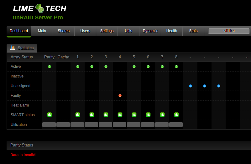

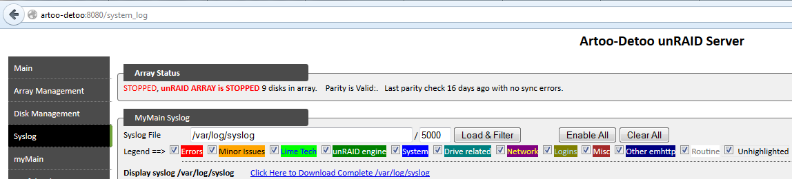

Follow up question.  See two attached screenshots and attached syslog.  I have unMenu and Dynamix installed.  unMenu indicates parity is valid and Dynamix indicates parity is invalid, which is correct?
From the syslog it appears disk 4 failed at the start of the parity check process.  I'm not sure if the parity check was aborted before overwriting any previous valid parity.  In other words can I simply replace disk 4 with a new disk then rebuild disk 4 contents from the parity data I have?

That screenshot doesn't say parity is invalid, it says data is invalid. A redball means unRAID has disabled the disk due to a write failure. Any further access to that disk would use the emulated disk, which means any data read from it would actually be read by calculating what that data would be based on reading all the other disks plus parity. Any data written to that disk would actually be a write to parity calculated based on the other disks data.
