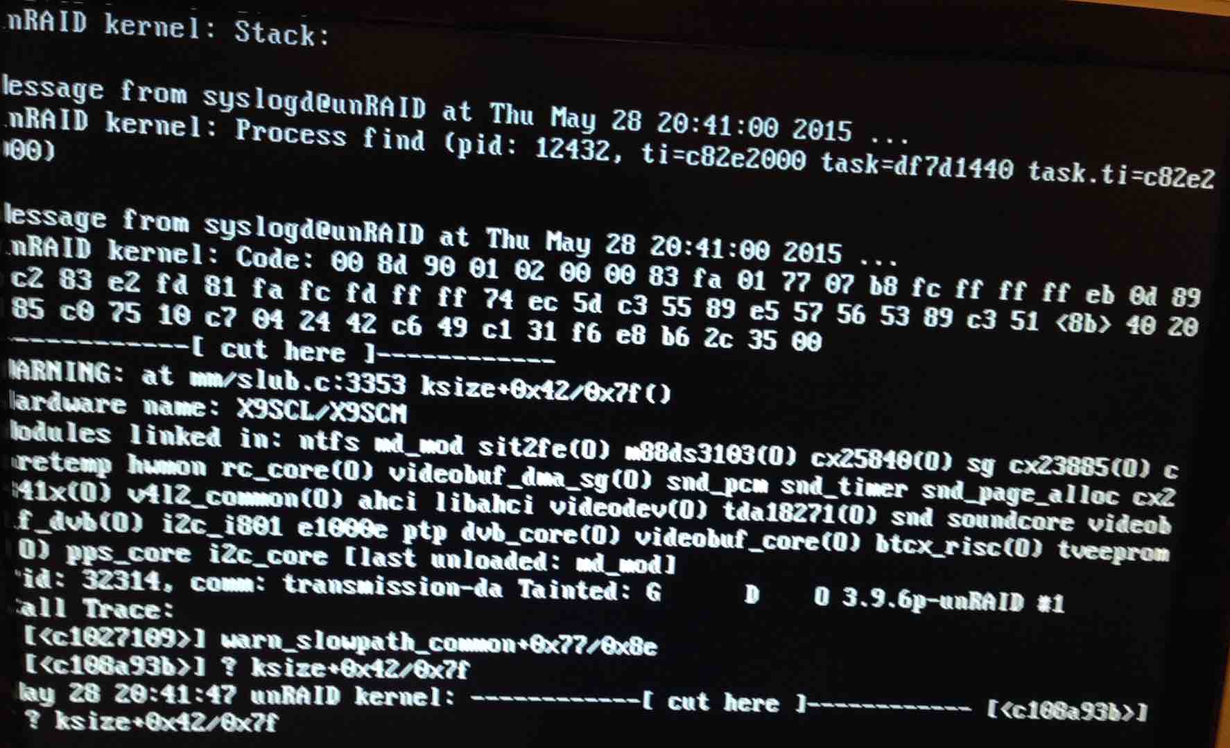

Folks,
I narrowed the kernel panic now definitely down to the mover. I scheduled it and monitored the syslog with tail -f.
Here is what I could capture per telnet and on the console. After that the machine was unresponsive.
For me, alas the error dump information that follows at the bottom is so far opaque. If anyonecan make sense of this, please go ahead.
For the record: The faulty 3TB drive I reported above is not allocated to the array, but connected to Supermicro board on SATA3 connector. 8TB Parity drive connected to SuperMicro board on SATA3, 250GB Samsung Cache drive connected to SATA2 on SuperMicro board. 8TB data drive connected to SuperMicro on SATA2. Rest of drives connected to SUpermicro SATA2 and to Digitus controller.
I would assume the mover would copy from the 250Gb Cache drive to the new 8TB data drive, thereby also accessing the 8TB parity drive.
Boom.

May 28 20:41:00 unRAID kernel: Code: 00 8d 90 01 02 00 00 83 fa 01 77 07 b8 fc ff ff ff eb 0d 89 c2 83 e2 fd 81 fa fc fd ff ff 74 ec 5d c3 55 89 e5 57 56 53 89 c3 51 <8b> 40 20 85 c0 75 10 c7 04 24 42 c6 49 c1 31 f6 e8 b6 2c 35 00
May 28 20:41:00 unRAID kernel: EIP: [<c108d19d>] filp_close+0x9/0x61 SS:ESP 0068:c82e3d14
May 28 20:41:00 unRAID kernel: CR2: 0000000073750062
May 28 20:41:00 unRAID kernel: ---[ end trace 1d6206f196c7d87a ]---
May 28 20:41:00 unRAID kernel: Fixing recursive fault but reboot is needed!
Message from syslogd@unRAID at Thu May 28 20:41:00 2015 ...
unRAID kernel: Call Trace:
unRAID kernel: Stack:
unRAID kernel: Process find (pid: 12432, ti=c82e2000 task=df7d1440 task.ti=c82e2000)
unRAID kernel: Code: 00 00 00 89 55 dc 99 f7 f9 8b 55 e0 8b 72 0c 89 c1 f3 a4 89 c1 8b 72 08 31 d2 8b 7b 08 f3 a4 eb 1d 8b 4d dc 8b 04 91 85 c0 74 06 <f0> ff 40 20 eb 06 8b 4b 0c 0f b3 11 8b 4d e4 89 04 91 42 3b 55
unRAID kernel: EIP: [<c10a14fa>] dup_fd+0x13d/0x1ca SS:ESP 0068:c82e3efc

May 29 12:06:47 unRAID kernel:  [<c10923f2>] sys_readlink+0x27/0x29
May 29 12:06:47 unRAID kernel:  [<c13e5f40>] syscall_call+0x7/0xb
May 29 12:06:47 unRAID kernel: Code: ff 19 c0 83 c0 02 eb 05 b8 02 00 00 00 83 c4 24 5b 5e 5f 5d c3 55 89 e5 56 89 c6 53 8d 04 0a 83 ec 14 89 45 ec 8b 46 04 89 4d e8 <8b> 58 50 85 db 74 0e 8b 5b 20 85 db 74 07 ff d3 e9 ce 00 00 00
May 29 12:06:47 unRAID kernel: EIP: [<c109ccc5>] d_path+0x16/0x100 SS:ESP 0068:ec82ff2c
May 29 12:06:47 unRAID kernel: CR2: 0000000000000050
May 29 12:06:47 unRAID kernel: ---[ end trace 7f01c1191ac43038 ]---

Can you help?

Message from syslogd@unRAID at Fri May 29 13:15:28 2015 ...
unRAID kernel: Process fuser (pid: 2342, ti=eec72000 task=f725e880 task.ti=eec72000)
unRAID kernel: Code: 00 89 55 f0 e8 78 7c fd ff 8b 55 f0 85 c0 0f 84 98 00 00 00 8b 48 04 3b 11 0f 83 88 00 00 00 8b 49 04 8d 14 91 8b 12 85 d2 74 7c <8b> 7a 28 e8 76 7c fd ff 8d 83 d0 02 00 00 e8 84 c2 31 00 8b 83
unRAID kernel: EIP: [<c10c9931>] tid_fd_revalidate+0x56/0x12a SS:ESP 0068:eec73eac
Syslog:

May 29 13:15:28 unRAID kernel: BUG: unable to handle kernel paging request at 2e6b6c89
May 29 13:15:28 unRAID kernel: IP: [<c10c9931>] tid_fd_revalidate+0x56/0x12a
May 29 13:15:28 unRAID kernel: *pdpt = 0000000030d7e001 *pde = 0000000000000000
May 29 13:15:28 unRAID kernel: Oops: 0000 [#1] SMP
May 29 13:15:28 unRAID kernel: Modules linked in: ntfs md_mod sit2fe(O) m88ds3103(O) cx25840(O) sg cx23885(O) rc_core(O) videobuf_dma_sg(O) snd_pcm snd_timer snd_page_alloc cx2341x(O) v4l2_common(O) i2c_i801 coretemp hwmon e1000e ptp pps_core videodev(O) tda18271(O) snd soundcore videobuf_dvb(O) ahci libahci dvb_core(O) videobuf_core(O) btcx_risc(O) tveeprom(O) i2c_core [last unloaded: md_mod]
May 29 13:15:28 unRAID kernel: Pid: 2342, comm: fuser Tainted: G          O 3.9.6p-unRAID #1 Supermicro X9SCL/X9SCM/X9SCL/X9SCM
May 29 13:15:28 unRAID kernel: EIP: 0060:[<c10c9931>] EFLAGS: 00010202 CPU: 2
May 29 13:15:28 unRAID kernel: EIP is at tid_fd_revalidate+0x56/0x12a
May 29 13:15:28 unRAID kernel: EAX: f3681200 EBX: f3d02be0 ECX: f0ebdc00 EDX: 2e6b6c61
May 29 13:15:28 unRAID kernel: ESI: f6750440 EDI: ee961000 EBP: eec73ebc ESP: eec73eac
May 29 13:15:28 unRAID kernel:  DS: 007b ES: 007b FS: 00d8 GS: 0033 SS: 0068
May 29 13:15:28 unRAID kernel: CR0: 80050033 CR2: 2e6b6c89 CR3: 2edcd000 CR4: 000407f0
May 29 13:15:28 unRAID kernel: DR0: 00000000 DR1: 00000000 DR2: 00000000 DR3: 00000000
May 29 13:15:28 unRAID kernel: DR6: ffff0ff0 DR7: 00000400
May 29 13:15:28 unRAID kernel: Process fuser (pid: 2342, ti=eec72000 task=f725e880 task.ti=eec72000)
May 29 13:15:28 unRAID kernel: Stack:
May 29 13:15:28 unRAID kernel:  0000002a f6750440 ee961000 f0f93240 eec73ecc c10c9ad1 ee87d300 ee961000
May 29 13:15:28 unRAID kernel:  eec73f0c c10c6de0 0000002a 0000000d c14bcfba eec73f3b eec73f48 eec73f3d
May 29 13:15:28 unRAID kernel:  c109ac64 eec73f90 00003234 00000002 eec73f3b f0f93240 0000002a f3681200
May 29 13:15:28 unRAID kernel: Call Trace:
May 29 13:15:28 unRAID kernel:  [<c10c9ad1>] proc_fd_instantiate+0x6a/0x74
May 29 13:15:28 unRAID kernel:  [<c10c6de0>] proc_fill_cache+0x66/0xf9
May 29 13:15:28 unRAID kernel:  [<c109ac64>] ? sys_ioctl+0x50/0x50
May 29 13:15:28 unRAID kernel:  [<c10c9756>] proc_readfd_common+0x15d/0x1a4
May 29 13:15:28 unRAID kernel:  [<c10c9a67>] ? proc_fdinfo_instantiate+0x62/0x62
May 29 13:15:28 unRAID kernel:  [<c10c97c3>] proc_readfd+0x12/0x14
May 29 13:15:28 unRAID kernel:  [<c109af56>] vfs_readdir+0x52/0x7a
May 29 13:15:28 unRAID kernel:  [<c109b0e8>] sys_getdents64+0x62/0xba
May 29 13:15:28 unRAID kernel:  [<c13e5f40>] syscall_call+0x7/0xb
May 29 13:15:28 unRAID kernel: Code: 00 89 55 f0 e8 78 7c fd ff 8b 55 f0 85 c0 0f 84 98 00 00 00 8b 48 04 3b 11 0f 83 88 00 00 00 8b 49 04 8d 14 91 8b 12 85 d2 74 7c <8b> 7a 28 e8 76 7c fd ff 8d 83 d0 02 00 00 e8 84 c2 31 00 8b 83
May 29 13:15:28 unRAID kernel: EIP: [<c10c9931>] tid_fd_revalidate+0x56/0x12a SS:ESP 0068:eec73eac
May 29 13:15:28 unRAID kernel: CR2: 000000002e6b6c89
May 29 13:15:28 unRAID kernel: ---[ end trace a6212521814ae9ae ]---

(FYI I removed the rsync options and them put them back one by one until the kernel panic occurs, so I am pretty sure it is the -X option)
Could it be that something that -X does has problems with very large disks?
-X, --xattrs                preserve extended attributes
Doesn't exactly scream "kernel panic". But may cause additional small I/Os to read the extended attributes on each file, and them write them on the target file.
This may be exposing the issue, but I still expect you have some system issue that is the root cause.
More likely to do with different filesystems.
Interesting thought. Maybe rsync having issues copying extended attributes to different file systems.
jus7incase -
Are the disks on different file systems?
Rsync copies from /mnt/cache to /mnt/user0. Should both use ReiserFS. Standard for Unraid.
