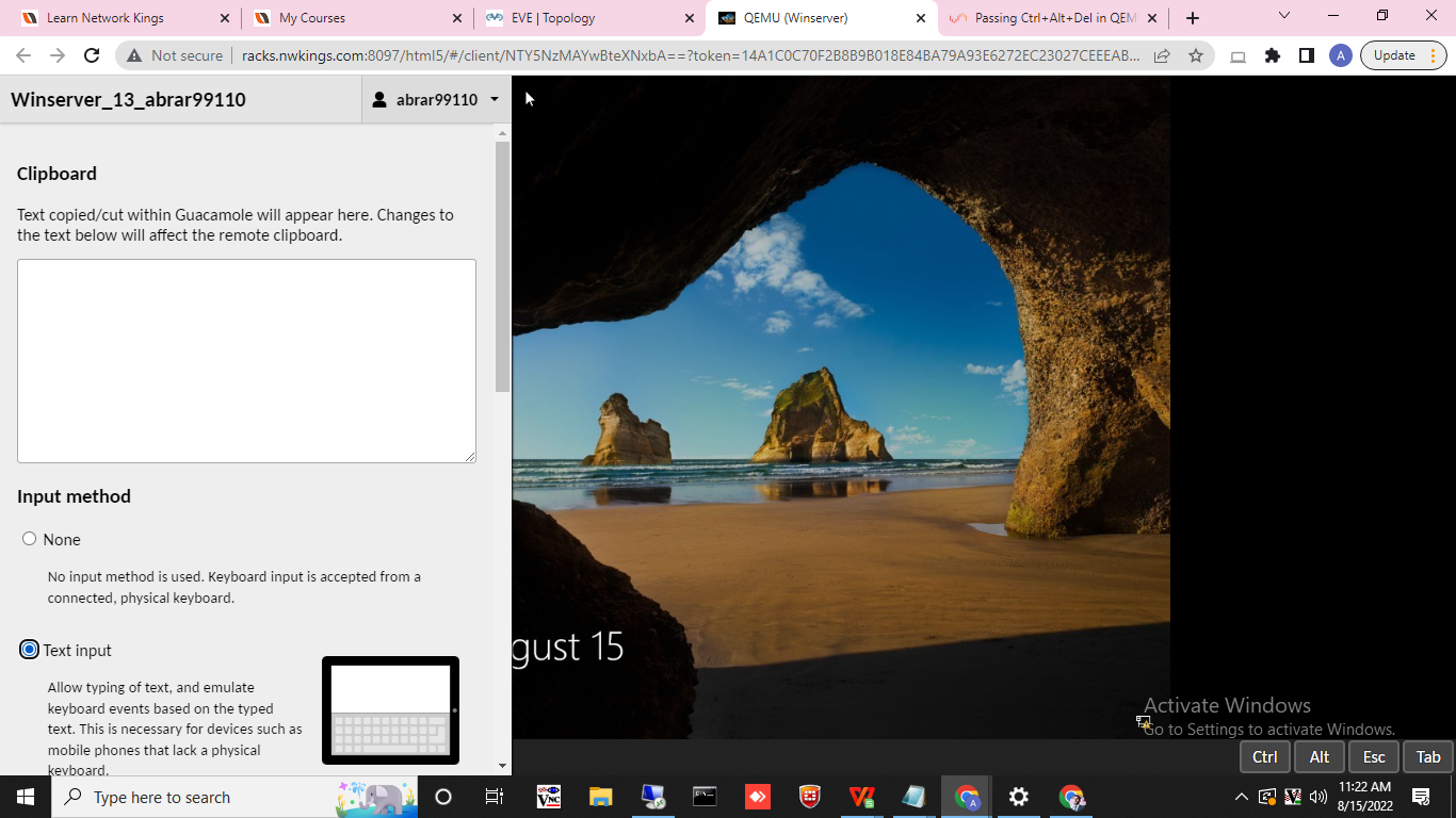

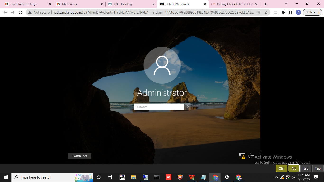

it possible now.
go to your qemu terminal page .
and press ctrl+shift+alt   and select input text then in wright corner your alt+ctrl+esc+tab button will be enabled . now select alt ctrl and press delete button from your keyboard then it will be open . its real guys iam  add screenshots also.
Edited by abrar malik
to add screenshot
