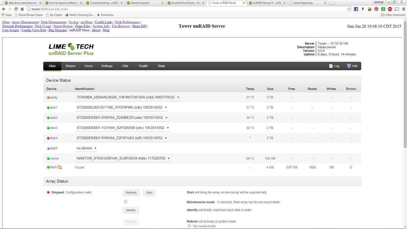

Originally my system consisted of a 3TB parity drive and 4 2TB  data drives running on UNRAID 5.0.4.  I was upgrading the parity drive with a 5TB with the plans of adding the old parity drive in as a new data drive.  In the middle of the parity sync after putting in the 5TB drive data disk 4 started giving read errors.  Now it is showing the red ball in front of it and if the array starts it says it is unformatted.  The new parity drive never completed the parity sync, I still have the old parity drive from approx 30 hrs ago and I know a few file changes have been made in that time, but I am willing to loose those if need be.  I need help on what I need to do.  I am adding a screen shot of my array config page.  I don't like that it says configuration valid even with the red by drive 4, if i choose no device for drive 4 it still says config valid?

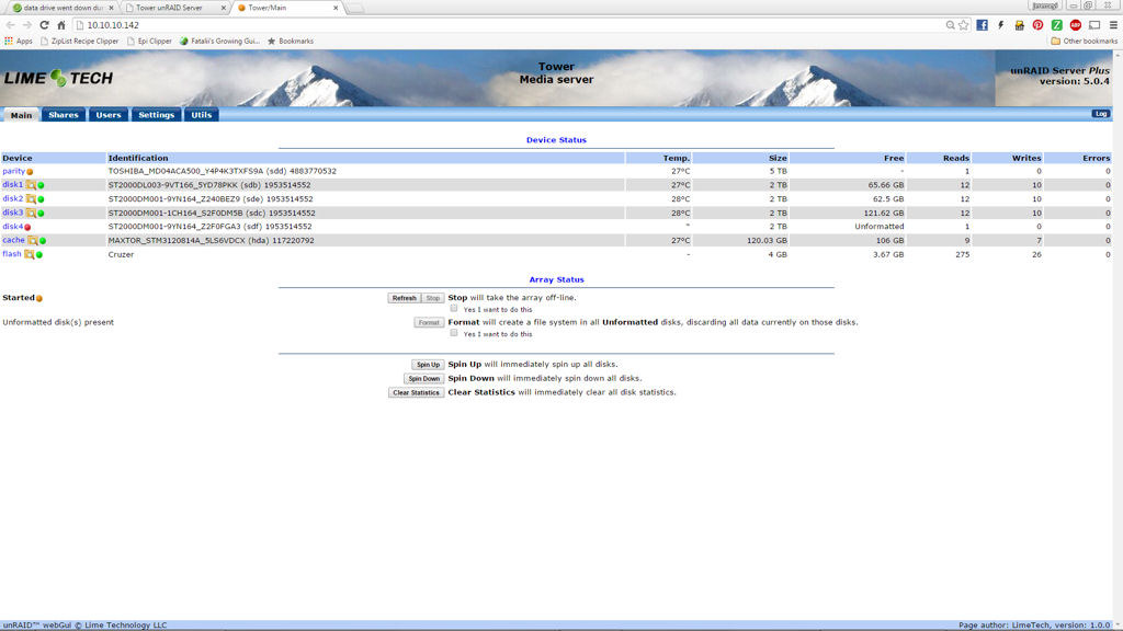

yes, if I mount the array normally, disks 1-3 are available normally, as in I can access them through samba as disk 1-3, not as a whole disk, if that makes any since.  I have also attached a screenshot of the homescreen of the system when mounted as such.
