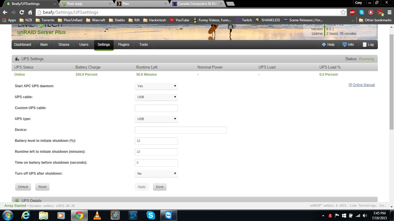

Are you still using the UPS? If so, then depending on how you have the UPS settings in unRAID it could have signaled it to shutdown.
Another possibility, perhaps unlikely, is someone else shutting it down. I think ctrl-alt-del on an attached keyboard might do it, and also pushing the power button briefly (unlike holding down the power button, which just kills the power).

The UPS is still being used at this time,yes.
The UPS settings are set to shutdown the server at 10 min remaining on the battery.

I'm guessing I should be removing the UPS and seeing how it goes from there.....
