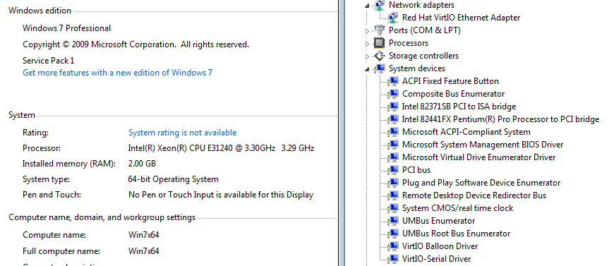

September 1, 201511 yr Hi Jon, First and foremost, thank you for the great videos and all of the assistance you provide here - even on the weekends! And thanks to everyone else who offered knowledge and assistance. I did get Windows 7 x64 up and running as a VM following your tips - changing the <Address from PCI to IDE, deleting the address line following that entry, then loading Windows (for those following along, you still must install the drivers as described in the UnRaid 6 Manual, even though the drive is detected; I think they are later used to drive devices on your VM.) I spent a ton of hours working on the USB devices - and while I could get one or two working, I never got all of them working (your suggestion didn't seem to work with Windows 7, FYI) - and the simplest of things would crash the whole damn thing (like connecting a new USB CD drive to load a driver). Often this led to recreating the VM and reloading the OS. I was also able to do a little testing while I had the VM up and running. Instead of loading files over the gigabit network, having the array onboard the same machine was only about 10% faster than the network delivery - I had hoped they'd be much faster this way. Regrettably, I've given up. I bought a hexcore processor, 64GB of RAM, a new motherboard, a video card, and a few other things to seriously upscale one of my existing Unraids to do VMs - now I'm in the market for a new case and power supply to build a new machine instead. My two scanners, drawing tablet, printers, and other USB accessories should work just fine that way. I've rebuilt both my UnRaid machines to their pre-6 form, and they run 6 just fine (even if they are just Celerons with 2GB of RAM). Hopefully I'll have the horsepower for a couple dockers (CrashPlan and Plex). Thanks again for all the assistance and coaching - sorry I couldn't put any more time into it, Russell
September 1, 201511 yr Hi Jon, First and foremost, thank you for the great videos and all of the assistance you provide here - even on the weekends! And thanks to everyone else who offered knowledge and assistance. I did get Windows 7 x64 up and running as a VM following your tips - changing the <Address from PCI to IDE, deleting the address line following that entry, then loading Windows (for those following along, you still must install the drivers as described in the UnRaid 6 Manual, even though the drive is detected; I think they are later used to drive devices on your VM.) I spent a ton of hours working on the USB devices - and while I could get one or two working, I never got all of them working (your suggestion didn't seem to work with Windows 7, FYI) - and the simplest of things would crash the whole damn thing (like connecting a new USB CD drive to load a driver). Often this led to recreating the VM and reloading the OS. I was also able to do a little testing while I had the VM up and running. Instead of loading files over the gigabit network, having the array onboard the same machine was only about 10% faster than the network delivery - I had hoped they'd be much faster this way. Regrettably, I've given up. I bought a hexcore processor, 64GB of RAM, a new motherboard, a video card, and a few other things to seriously upscale one of my existing Unraids to do VMs - now I'm in the market for a new case and power supply to build a new machine instead. My two scanners, drawing tablet, printers, and other USB accessories should work just fine that way. I've rebuilt both my UnRaid machines to their pre-6 form, and they run 6 just fine (even if they are just Celerons with 2GB of RAM). Hopefully I'll have the horsepower for a couple dockers (CrashPlan and Plex). Thanks again for all the assistance and coaching - sorry I couldn't put any more time into it, Russell Sorry you couldn't get it working right for your needs. With respect to USB support, there's another way to guarantee easier / more natural USB support, which is to purchase a USB controller as a PCIe card, add it to unRAID, then assign that card to the VM as a PCI device with another custom string of xml. This would give you full hot-plugging support and all devices attached should work perfectly. USB assignment is tricky when it comes to supporting a wide variety of devices. It's getting better and better, but it's still got a ways to go to work universally with all device types. USB controller pass through, however, is very solid, and can be very advantageous in giving you a more "native" experience. As far as storage performance goes, I'm wondering how you went about getting the files onto the array from within the VM in the first place. If you downloaded a file inside your VM, then copied it to the array from the VM, I wouldn't expect much improvement, as you're going through a virtual disk image layer. You could potentially improve the performance there by passing through an entire block device (or perhaps even another add-on storage controller that is dedicated to the VM). It also depends on the file systems you're using, how full those devices are, and a number of other conditions. Lastly, Windows 7 is the worst of the currently supported Windows operating systems when it comes to performance as a virtual machine. Windows 8/8.1/10 are far better performing as a VM. Windows 7, while a tried and true OS, just doesn't have the optimizations that the later iterations have for running as a VM. Does it work? Yes. Does it work fairly good? Yeah, it does. Is it as good as 8.1 or 10? Not by a longshot IMHO. And the virtual USB 3 controller I gave you as XML doesn't work with Windows 7, I know that. It seems to work solid in 8.1/10 though, and even with USB cameras, although I am debugging some issues still there. Right now, the primary use cases for VMs on unRAID are pretty simple and direct: 1- replace a desktop PC / gaming rig with a NAS+Desktop combo system, where the NAS functionality rides at a level above the desktop, so desktop issues don't cause NAS issues. 2 - run headless servers for Windows or other applications that aren't available/stable enough in Docker Containers. 3 - build a media player / NAS combo with OpenELEC There are obvious other things you can do with virtualization beyond that, but we haven't fully implemented them all just yet, so this may be a case of expecting more from us than we're ready to deliver. That said, for folks willing to work with us a bit, we can find ways through XML edits to deliver functionality, but again, Windows 7 can be a major drawback for us at times. That said, I appreciate you giving it a shot and some time to work through your issues. I do understand the need to move on though, but if you ever decide to give it another shot, we're here to help.
