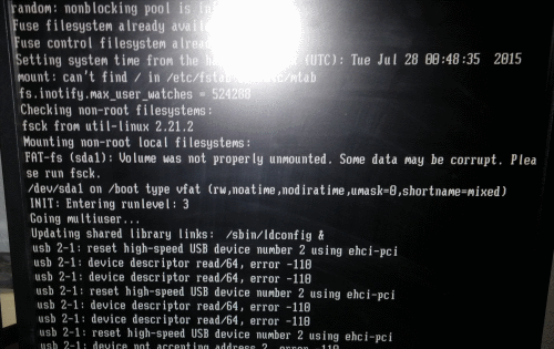

July 28, 201511 yr Author Ran chkdsk and it found no errors. So I then take a look in the BIOS as per LT suggestion, and there is a 'Legacy USB Support' mode, I tried disabling it, wouldn't boot at all, so I re-enable it and then I notice another option, USB Speed full, hi-speed or auto, I set it to full and now it boots super quick, and also the UPS comms seem to be consistently. Ok, I cleanly shut it down twice and on the last reboot it says 'Stopped. Unclean shutdown detected.', I ran the dskchk before it did this. Seeing as I have no data stored on here yet, will I do any harm in cancelling the parity check? I've attached boot-up screenshot, I wonder if the motherboard is on its way out.
July 28, 201511 yr Ran chkdsk and it found no errors. So I then take a look in the BIOS as per LT suggestion, and there is a 'Legacy USB Support' mode, I tried disabling it, wouldn't boot at all, so I re-enable it and then I notice another option, USB Speed full, hi-speed or auto, I set it to full and now it boots super quick, and also the UPS comms seem to be consistently. Ok, I cleanly shut it down twice and on the last reboot it says 'Stopped. Unclean shutdown detected.', I ran the dskchk before it did this. Seeing as I have no data stored on here yet, will I do any harm in cancelling the parity check? I've attached boot-up screenshot, I wonder if the motherboard is on its way out. Error -110 usually means too much power on USB stick - USB 2.0 stick on USB3 slot or similar..
July 28, 201511 yr Author Yeah, a bit of Googling and it does point to USB power issues. I've given up and just bought a new motherboard, ASUS Micro ATX DDR3 2000 AMD AM3+ Motherboard M5A78L-M/USB3 , RAM and CPU, just low end stuff.
