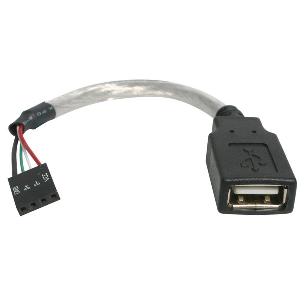

Could you possibly take a picture of the adapter and what you are plugging it into and post it? I'm having a hard time picturing what you have and how you are plugging it in. I've never seen a male usb connector on a motherboard, only standard female USB or 10 pin IDC headers.
hi this is what i'm using.  i have the exact same one in my other server, working for years now
Ahh, so not a female usb to female usb, but IDC pin header to female USB.

mine is very reversible!  its just 4 holes in a line, and these slip onto 4 pin headers.  two of the headers have four pins, and two of the headers have five pins, however according to the manual one of these is not used.  there is definitely nothing preventing having it forwards, or backwards, or on the unused pin as well.  you are just pluggin 'four holes in a row' onto 5 pins in a row.  absolutely nothing physically preventing reversing
I agree about not seeing anything about usb booting in the bios.  i'm sure with my other server, that was an option.  on this one, it have looked through every single option.  there is an option to boot to something called 'nvidia boot assist' or something like that.  in case, usb boot must be enabled, because it will boot to the flash if plugged into the rear usb ports.
there may be some confusion because there are adapters that are nine holes, which cover the four usb, and the five usb right next to them.  these are not 'reversable'.  however, mine is just a four hole unit, so it could be physically plugged in using many configurations (just physically, doesn't mean they would work!).  i am using the four pin model in my other server
