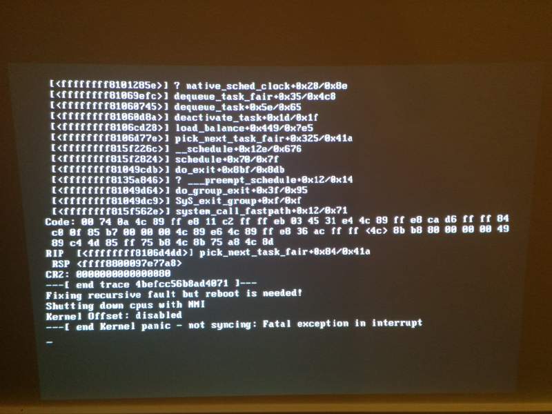

The Kernel panic referenced an interrupt at the end, but I couldn't find a way to capture more than what was on the screen, didn't see it logged to flash or anything after I rebooted. A screenshot of the console output is attached here.

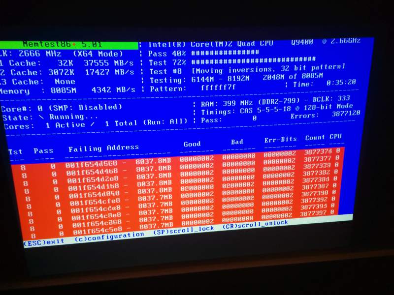

Within 35 minutes it was throwing errors as seen in the attached. I assume that is bad.  ;)
I re-seated all the memory an I am running it again. So far it is cleaned and has passed where it was before. I am hoping I just knocked one of the sticks loose or something when replacing the drives. I will let it get through at least a couple of passes then try unRAID again if it stays clean.
