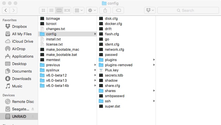

Thanks for your reply.
The USB appears fine and the config folder has content.

Then there is something else going wrong.
If you have console (or telnet) access perhaps you should run the command
ls -l /boot/config
to confirm that the content agrees with what you see when you look at the USB stick under Windows,
It could also be worth booting in safe mode (from the boot menu) to see if that makes a difference  - it is possible that you have a plugin installed that is not compatible with this release?

It doesn't appear that the contents of the boot USB are the same in the unRAID box as opposed to the earlier screenshot on my Mac. I've no idea why that would be unless it's some kind of permisssions issue? Screenshots attached.

GUI does not start, contents of the boot USB only show an ssh folder, not as per what was displayed in the otehr screenshot on my Mac.

Running a HP N40L microserver, so took the USB stick off the motherboard port and plugged it into one of the four ports on the front. Seeing USB device errors but they go by too quick to isolate. I'm at a loss as to what to do. Sandisk USB stick less than a year old, no issues whatsoever previous to the 6.1.3 upgrade attempt and the stick is readable and appears completely error free when I plug it into my Mac. I know this sounds stupid, but it really does look like the stick contents I see on the Mac aren't what is seen on the N40L. Look at my previous screenshots.

This can be marked as solved now, for some reason the upgrade process trashed the file permissions on the boot USB to the point where logins and other files weren't being read. Rebuilt the USB with config backups and stable on 6.1.4 now.
